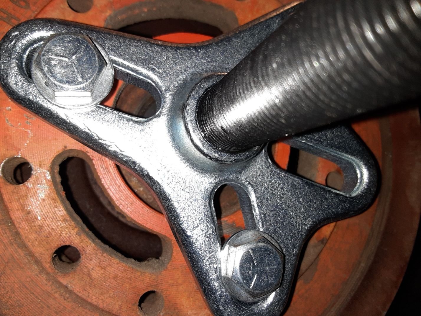

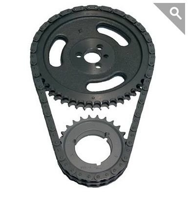

I used a puller to remove the crank gear. You can purchase the items separately, but it's best to buy new timing chain set.
I plan on using a Cloyes 9-1110 double roller set.
No problems removing the harmonic balancer and associated timing chain stuff with engine in the car. This was my first time removing a harmonic balancer, boy was it tight. I don't look forward to putting it back on.

71Green 454,
So you used a gear puller for the bottom sprocket and how did you get the balancer off? Is it pried off around the outside diameter equally?
Then how does the new gear get pressed on properly so they are seated correctly?

Originally Posted by marshal135
71Green 454,
I wish I had time when these projects pop up locally I would come and watch the install...... with a proper invite of course lol.
Marshal
If you pry around the outside, you have just ruined your balancer. You use a three-arm puller that attaches to the balancer via the threaded holes for the pulley bolts.
Correct, I used a harmonic balancer puller on the HB, and a gear puller on the crank gear.
