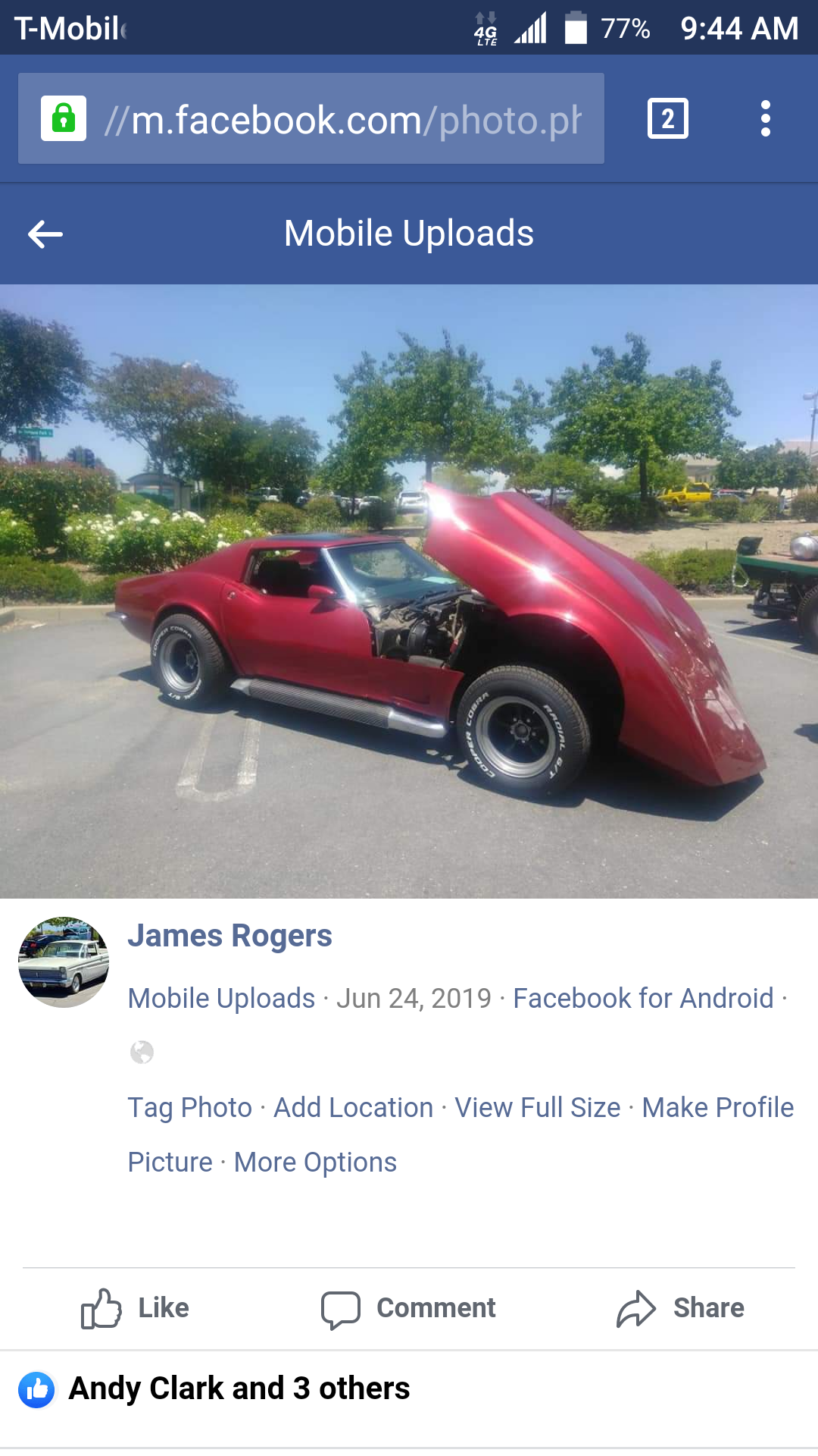

Hi All, I inherited a '68 and have some concerns! Dad owned it since '71. It started life as a convertible. It was hit front end. Dad replaced with'73 tilt front end. Hit in rear a few years later. Replaced with t-top rear clip. Has 94k on clock. Dad was a master mechanic and he straightened frame. It is a finished car. It sat on car lift for a few years. Now hood pins are about 1 1/2 inches from lining up. I can lift nose and latch it. Unlatching is a huge pain. Also passenger wheel base is a little over an inch shorter than driver side. Any suggestions on either problem would be appreciated. Oh worst part.... He sold a 63 to buy this.

Post some pics of the car.

Post a pic of it. That will help us help you.
Put it back on the ground. See if the hood works better.

im trying to decide. It runs and drives. Looks great. Viper red metallic, original side pipes. I'm hoping alignment can fix wheelbase issue. It had dual quads. I went to single edelbrock to simplify my life. I'm a bit sad that everything he did has just complicated my life.

Id verify its the fame and not worn or bent suspension component causing the wheel spacing to be off o combo of both.. you might get lucky

It Looks great!
And it Drives etc.
Why don't you keep it as-is as a tribute to your father?
It's got a lot of "70s-cool" mods that you don't see much anymore.
But for sure check out the alignment and suspension bushings and make sure it's safe.
A frame can be straightened if needed. Had to do mine.
