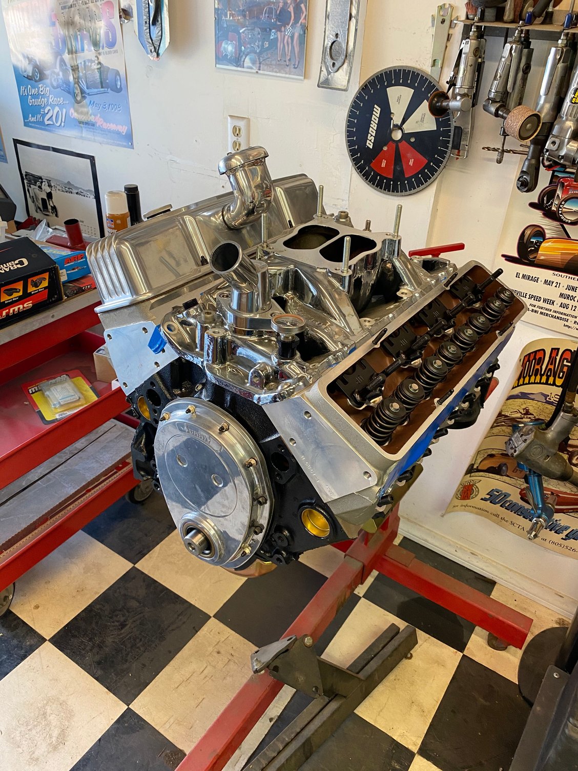

Well, I bought an engine. It turns out my neighbor who used to be a racer at the Bonneville Speedway had a 383 stroker sitting on an engine stand and had recently sold the vehicle he was going to drop it in.
It needs some assembly but comes complete with everything except the push rods. Now I just have to figure out how to assemble the rest of it.
It has:
383 Stroker
Trick Flow aluminum heads
Comp Cam-270 mag
Lifters
Roller rockers
Oil pan
Front Cover
Fluid damper
Edelbrock intake
Moroso oil pump
stud kit for the head, pan, valve covers
Harmonic damper
all gaskets

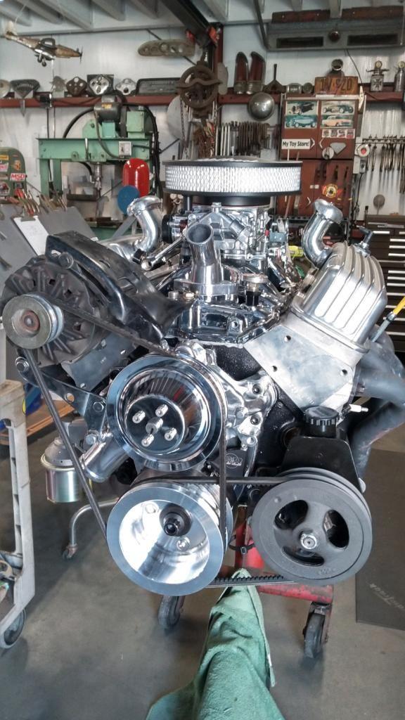

As an update, my M21 tranny is back and fully rebuilt. I know I said I was going to go with a 5 speed but once I priced it all out I decided to hold off for now.
The engine is almost complete. Its a new 383 Stroker with a Holley double pumper carb and full MSD ignition. I have a friend who is going to put it on a run stand to break it in.
The Hooker headers are being dropped off this week for ceramic coating and then I can start reassembly.
I also pulled the steering column off and sent it for a rebuild while the engine was out. That is back in the car along with the Borgeson power steering and I made sure to center the steering box before reinstall. I didnt center it the first time and the car would wander down the road. Should be good now.
