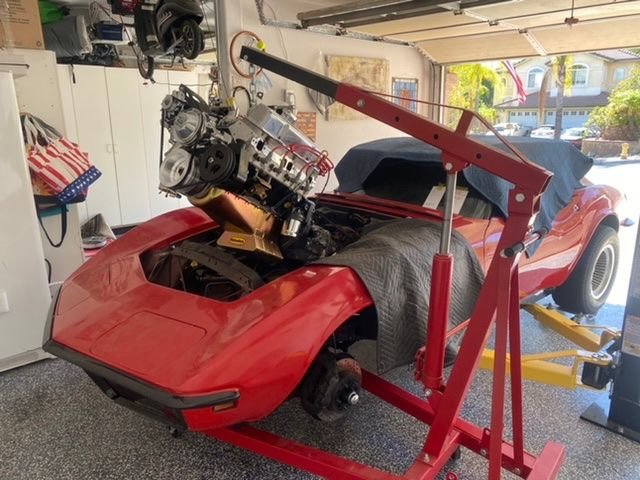

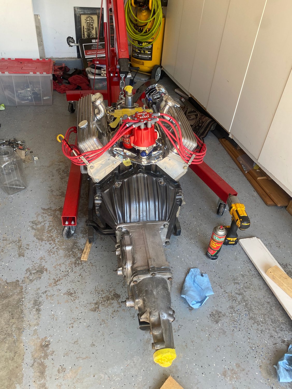

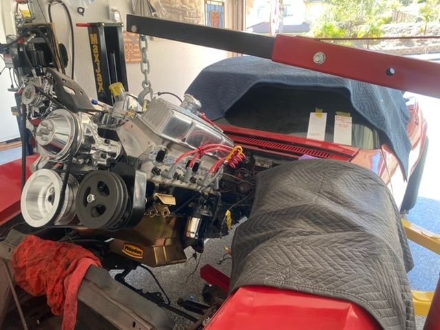

So today I decided it was time to drop the motor and trans back in the car. I didnt have any help but I figured if I took my time I could get it little by little and it took me a little over an hour and she was fully in.

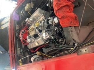

So today I had planned on just putting the engine in but considering it only took about an hour I started to button things up. I have the trans bolts back in and the driveshaft and u-joints in. The ground is run to the engine. I mounted and installed the clutch Z- bar. I also filled the tranny with fluid. Finally I ran the fuel lines and connected the speedo cable.
Tomorrow Im going to start working on top.

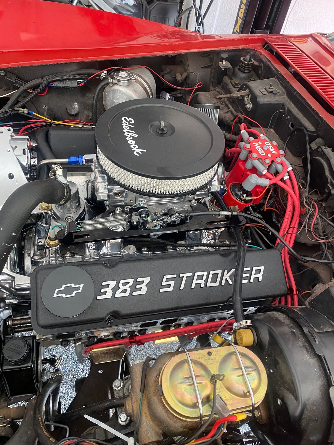

I swapped out the valve covers that I had on the engine last night. The breathers were too tall and were hitting the hood. My two options were new valve covers or a new hood, I went with new valve covers. I can use the other valve covers on another vehicle that I have that does not need a hood so they will work fine and look good. Anyway, I ordered some black crinkle finish cover from Summit that say 383 STROKER on them. They look good but one arrived with what I would call a quality control issue. The crinkle finish looks like it may have had dirt under it when it was sprayed in a few spots because the paint is bubbling. Summit is sending me new ones to replace it with and then i will send these back but they are letting me use them for the time being.
I also got word that my headers are done and i can pick them up today. So after work I am going to go get them and then tonight I will button up the exhaust on the car and I believe at that point she is ready to start. Everything on my checklist is complete and hopefully I did to mess anything up. Once it is all dialed in I have to take it back to my painter who is going to cut and buff the paint for a deep red shine.

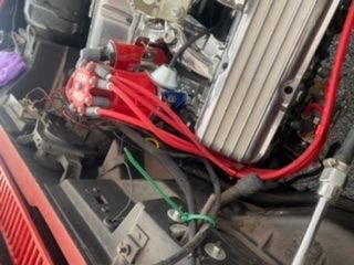

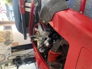

Last night I put the finishing touches on the install. I put the new ceramic coated headers on and it was alot harder than I expected. The drivers side is very tight with the power steering and power brakes. I had to remove the Z Bar and dipstick tube and then install them from the bottom.
Unfortunately I did scrape them a little with all the wiggling and moving then around but thankfully I have a MaxJax lift so it made moving the car up and down alot easier. I cant imagine doing this on jack stands.
I didnt finish until late last night and I was tired so I restrained myself from rushing to start it.
Today I will connect the battery, grab a fire extinguisher, double check my checklist, confirm all fluids and then attempt its first start and hopefully a drive.

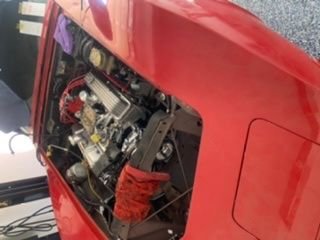

This is a picture with the new valve covers and my new 14” air cleaner should be in tomorrow so the 9” is just temporary

You forgot to put the header in on this side.
Is that the stock throttle cable?
I'm almost finished gathering parts, wish I had a lift.

So that not the final install picture. The headers are in and the throttle cable is stock. Im pretty sure Ill have to modify it but I want to see how it does when I start it first

Just kiddin ya
I was thinking I'll prob start mine the first time with the Qjet I have in the car now. It works good and all the vac/fuel lines and cables are stock so I elim that first problem
