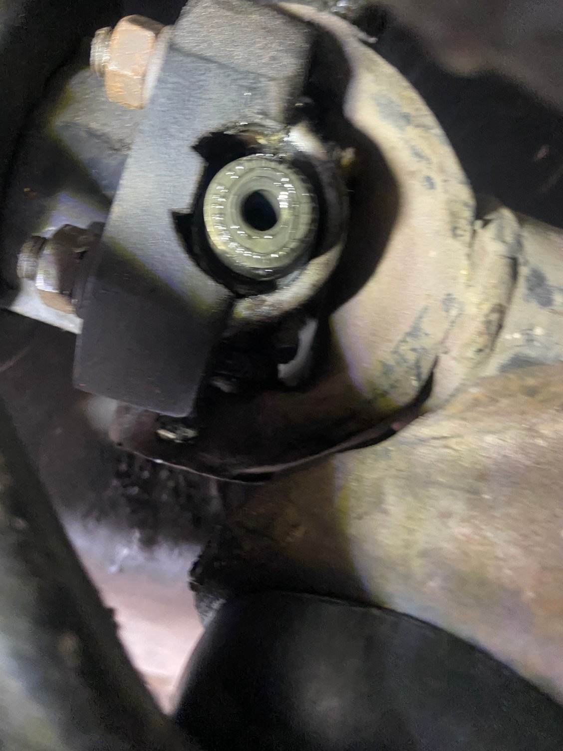

The car runs great as far as the engine but at about 35 mph I get a really bad vibration from somewhere.
I thought maybe under inflated tires but adding air did not fix it. Then I thought maybe flat spots on the tires from sitting for 6 months but I seem to hear a clunk in the back end.
Im going to put it up on the lift and see what I can find. Any ideas?

You said you got the Mcloud clutch setup. Did you get the right flywheel for your motor? Did you have them balance it?

So I figured it out. At some point I must have loosened the rear ujoint at the driveshaft even though I dont remember doing so. So the drive shaft was rattling around and then it threw an end cap. I bought a new u-joint and replaced the cap so I think it is good now. Ill take it for a drive in a few minutes and see.

Was your issue fixed?

Yes, the vibration is gone
