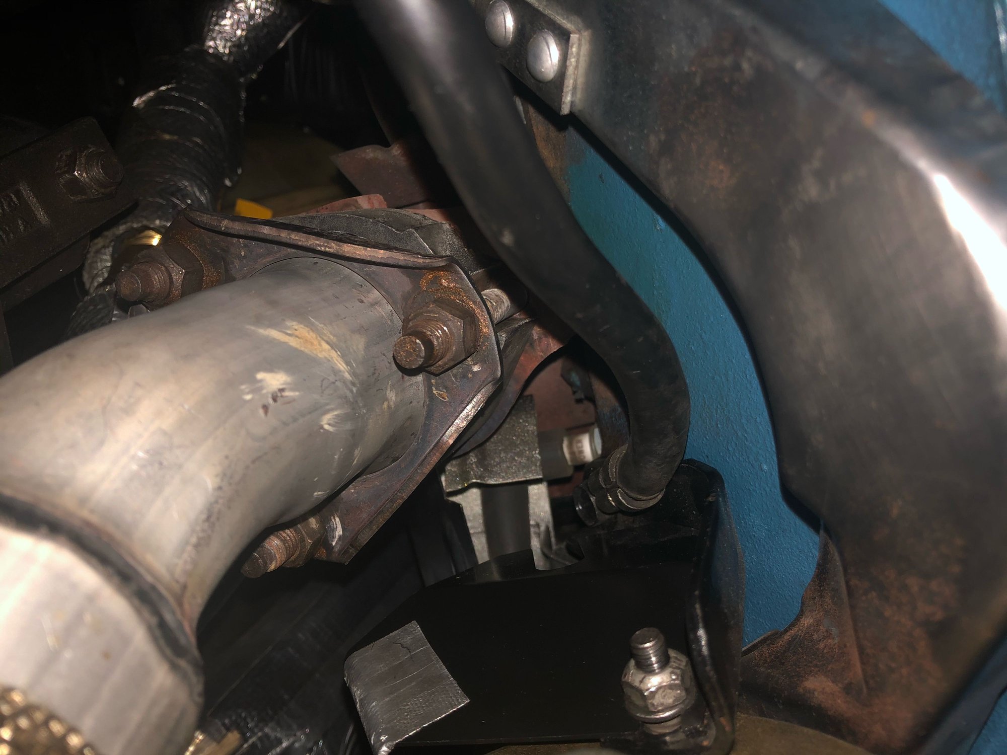

I pulled my engine and apparently didn’t pay enough attention to how my exhaust manifold connects to my exhaust. I don’t think my heat riser is the correct one, as mine has a beveled side. Is there supposed to be a gasket between the bevel and the exhaust flange and if so what is it called or look like?

Looks like you have the wrong type.

Yes, I agree. But I'm trying to determine who to make the one I have work. I think it just mounts directly to the flanged exhaust pipe, but I can't see how that will not leak.

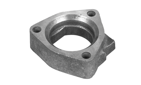

I urge you to replace this with a wide open spacer.......you have a later model one.

Not a chance....try a Corvette supplier near you?
You probably won’t find a factory heat riser either....
A lot of people simply cut the valve out and plug the side holes....but kinda ugly....
You could just put that one back on but it is in poor shape overall....
I recommend the spacer, gasket and new brass nuts.......

Does the one I have require a gasket? I may use this one now and then replace with the spacer when it comes in.

Yes, between the manifold and spacer....that they would be able to get at local parts outlet...

Yes, I know about the one between the riser and manifold, but is there one between the riser and exhaust pipe?

No....no way there could be.

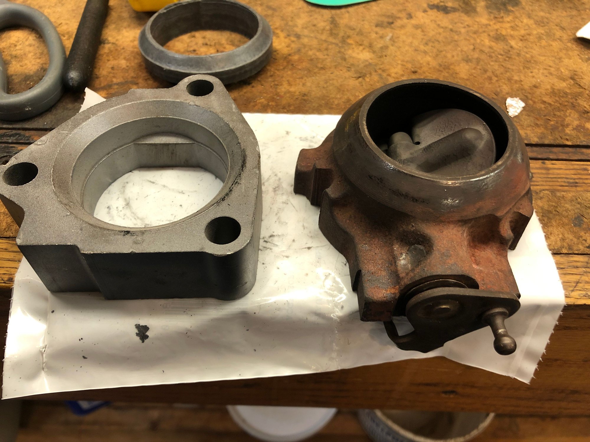

funny I literally just did this 3 hours ago..ebay spacer, ran without it for year donut to flat manifold...put it together check clearance order spacer
37 bucks delivered
https://www.ebay.com/itm/27384966781...53.m2749.l2649
came..had to grind holes open like oem..NO leaks no gasket flat to flat..donut below, old one worked..
agree get spacer..i ran without spacer and it still sealed but bothered me the pipe was higher than the drivers side..

Yes, the 72’ has a gasket and a donut gasket.....the OP will need both when installing the heat riser delete spacer....

After trying to make what I have work, I still had leaks. In fact, both side had leaks. So I put a new donut on the driver side and am going to order this delete to fix the passenger side. Do I need the "sleeve" if I use this space? The reason I ask is because I actually put the sleeve on the drivers side (guess I didn't realize where it was supposed to go) and have no leaks on that side now. I really hate to have to pull this apart if I don't have to.
The biggest issue I have is the exhaust just doesn't line up easily and disconnecting it from the hangers will be a task. Whomever put in the back hangers thought it was a good idea to weld the nut to the bolt. So I would have to cut the bolts off, which would require removing a lot of stuff to get to it.
So, long post to ask if the sleeve is required on the riser side.
Thank you,
Keith
