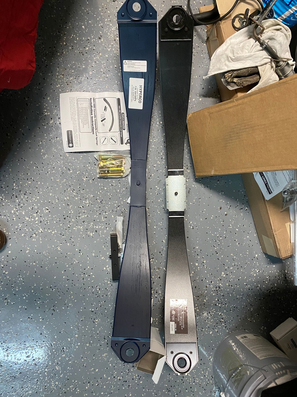

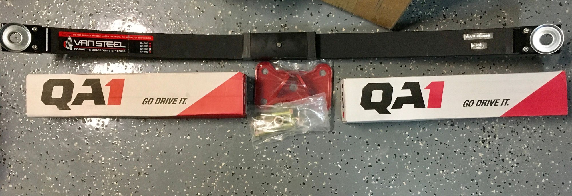

My Vansteel rear spring arrived today. It’s actually a 360# and it’s quite a bit different from the others. Less arch and much narrower on the ends than the other two. I’ll be installing it later this week.
Notice how wide the ends of the Hyperco (Ridetech) and TRW springs are as compared to the Vansteel spring.
This one is 1/2” narrowed on each end and 360#. I also got their rear spring plate and QA1 rear shocks to match my front QA1 coilovers.
I’ll post ride height differences later this week. More to come!
Thanks for the update! It looks a lot like the VB&P spring. Hopefully it performs just as well!
You're right. It does look like a VBP spring.
