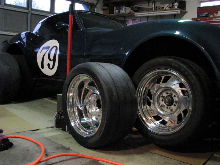

I still have a couple of sets of slicks to take you on! 295 fronts and 345 rears.
I used buy them in stacks

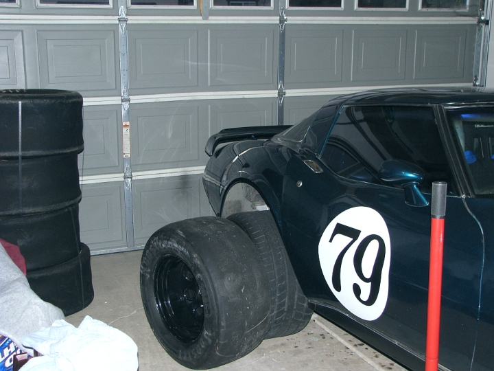

parked out front with street tires. 275 front and 335 rears. Rear antenna was for helmet racing radio

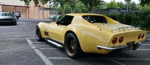

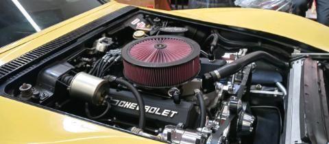

Your guys cars are very nice I am running a short 4.095 in height team g intake 434 dart 220 heads shp block 10.7 compression with a 598/583 lift and 253/261 duration with 1.6 ratio and I am pulling over 650 hp easy with a holley xp 950 carb tremec 6 speed willwood big brakes borgeson box vansteel coil over suspension this motor pulls hard in any direction and easy to drive and to top t off vintage air conditioning .
Do a dyno?
Easy to say.... not always easy to do....
your heads and compression tell me different.
I would drop coin in a bet, that you do not break 500hp on a chassis dyno... what exhaust? if it 2.5" and the headers are smaller than 1 7/8", you wont pull more than 475...
I have run a lot of dyno runs myself.....and have seen many cry afterwards:-). (yea, i own my own Dyno) hey... could be wrong....
VERY CLEAN engine bay!!! nice.

I did 2 dynos engine and chassis smaller cam than op and 10.7 compression .
Old Aug 16, 2022 | 07:03 PM
509 rat's Avatar
509 rat
Joined: Dec 2012
Posts: 3,974
Likes: 673
Default funny
I did a little over 500 hp at rear wheels at just 5000 rpm .
Old Aug 16, 2022 | 07:05 PM
509 rat's Avatar
509 rat
Joined: Dec 2012
Posts: 3,974
Likes: 673
I have 1/7/8 header side pipes, dougs header and side pipe holley xp 950 and air conditioning .
