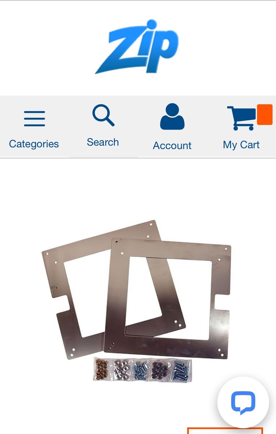

I purchased a set of C5 Z06 seats for my 74. I then purchased a kit that adapts the C5 seats to the C3 tracks.
I bet you could use the same adapter set and fabricate holes as needed to make them work with the seats you got for free.
I tried but couldn’t add a link so I took a snapshot.
I bought my set used on the CF but at a sizable discount.
Best of luck!
