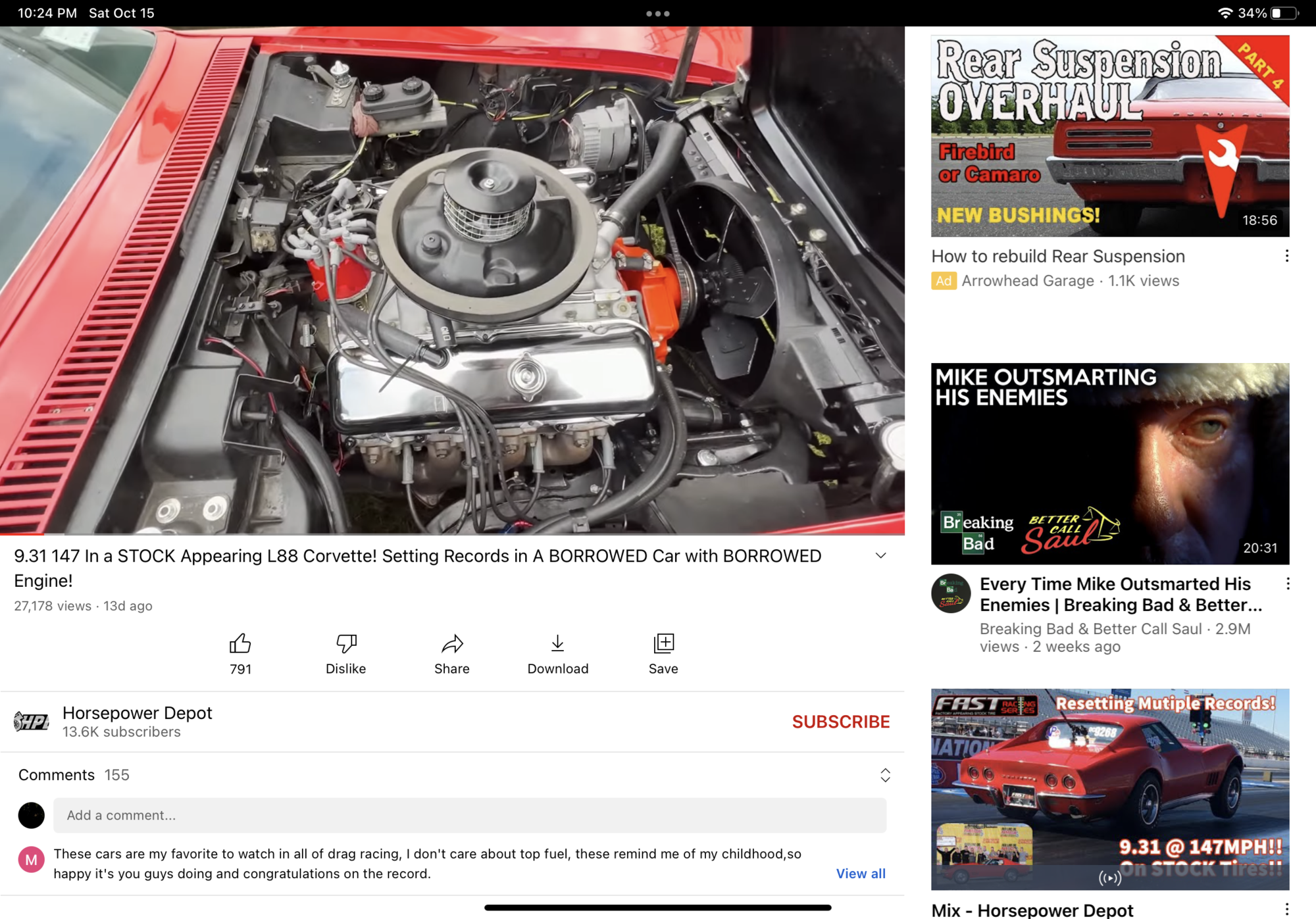

Then I found this video on YouTube of a Vette running in the 9’s at 148mph. It’s obviously got a lot of work done but i’m watching it and damn ! They’re running the factory cast iron manifolds !!!
Same exact ones that are on my car If I had any thought left in my head to go to headers they’re gone now.

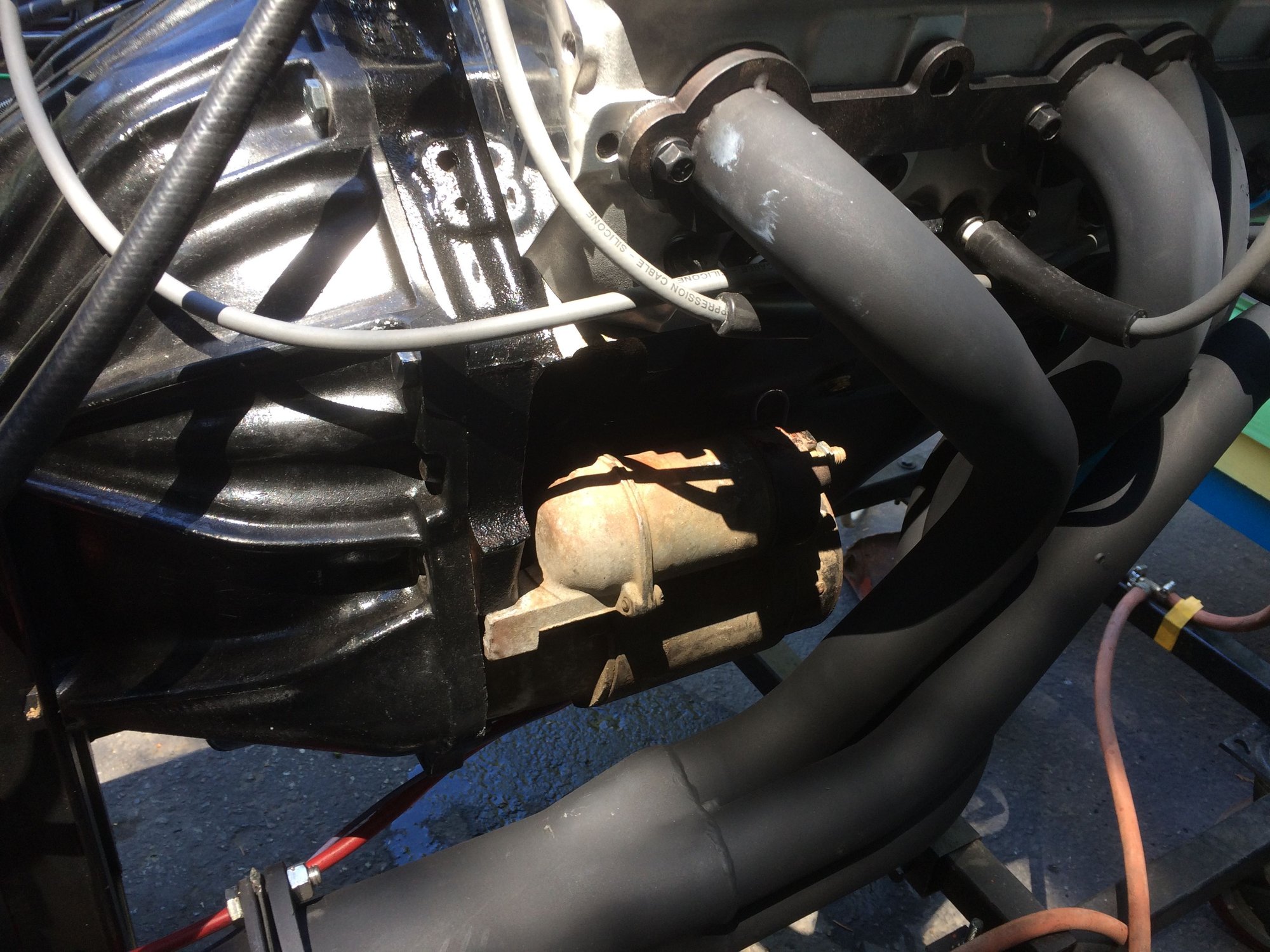

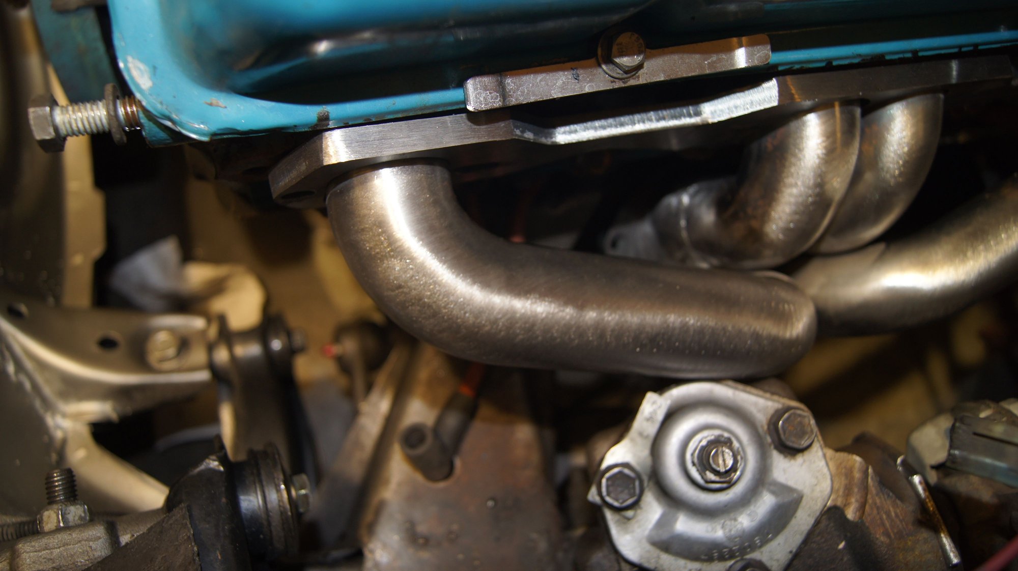

Here is what I used on my GM ZZ383 1978 corvette (d-port heads)
Sanderson CC1DP Header Set (sandersonheaders.com)
This car was used for track days, worked great including Torque/HP. Main issue is with spark plug wires. I needed to install heat shields to prevent wire boots melting. Very close to the headers.
As for heat under hood never caused any problems at the track. Closest contact was the driver side steering box. Here is my test fit using the factory L48 engine.

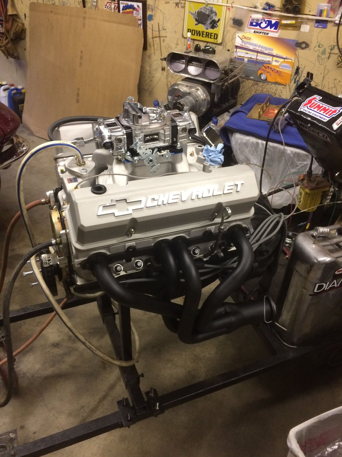

These are summit brand 130bucks best long tube sbc header I have ever used. No clearance issue no oil filter issue no starter issue even with a big block stock one. Better than a hooker, I know that's not saying much
