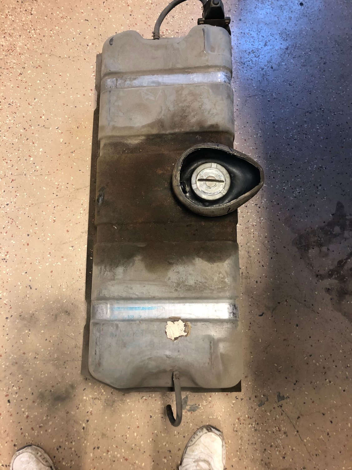

Here is a picture of my gas tank when i removed it. The cork gasket between the filler neck had lots of cracks in it , so the fuel was spilling onto the tank as i was driving around. It also disintegrated the tank sticker i was hoping to find. I installed a new gasket of new fuel lines.
