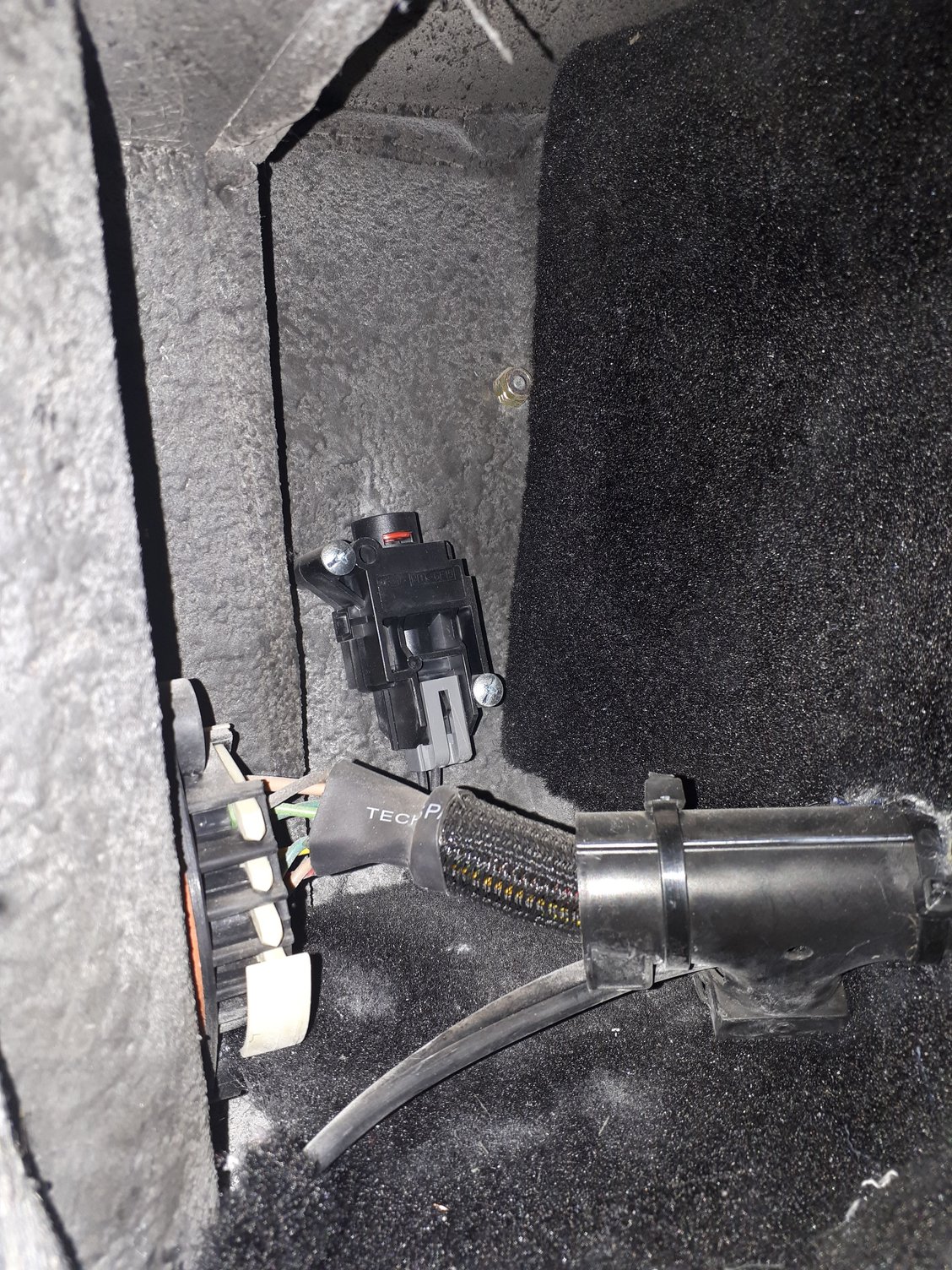

I'm using the Ford Inertia switch. I installed it in the rear compartment.
I went a step further to help any troubleshooting.
I use LED fuses that light when they blow-
Blow one- put in parallel with the inertia switch- If the inertia switch is tripped- the blown LED fuse lights up.
So there's no question whether it's tripped or not.
inertia switch not tripped-
Tripped- fuse lights up
and used a wire nut - temporary!!!
