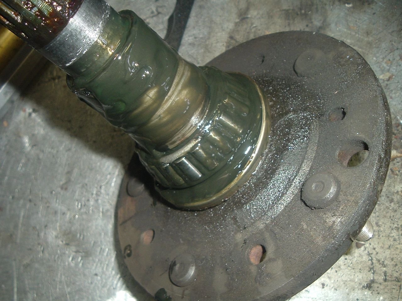

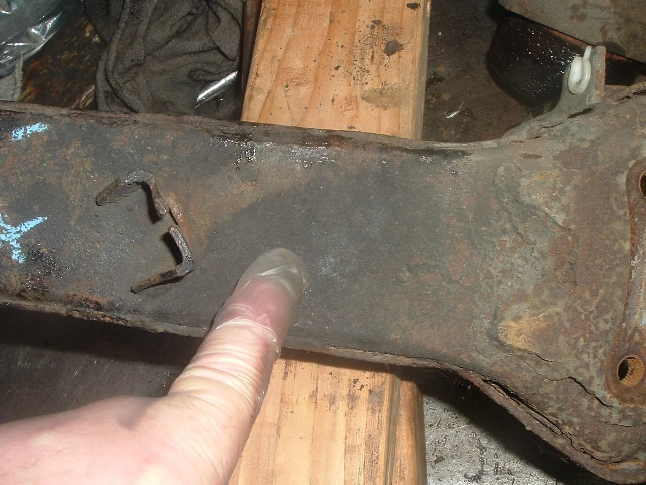

So these guys have been together almost 54 years and don't seem to want to separate. I have given a few judicious whacks with a hammer but no cooperation. Any thoughts or tips on how these come apart??

Sure, typically once you get to the point where you are, rust is holding the parts together. Spraying penetrating oil helps but I always replace the arm studs. They are in the way, some have pitted threads, and it is just better to use new studs and nuts. I drive those out, simple hammer and punch work.
Next I don't use a press with arms, only to install new bearings. Support the arms from outer surface on some 2x4 or 4x4's. Just to tap the bracket off, usually it will come off without a lot of work. Then I have an aluminum puck I place on the inside face of the support, and a shot or two with a 4 or5 lb mine sledge drives the support out, no damage as long as it is supported and you hit the puck solid. The arm as pictured wouldn't take as long as it took me to type this answer out.
I have not used a press to break down an arm in over 15 years. Spindle knocker and 5 lb hammer gets the axle out in a few shots.
The thing to look for when taking apart arms are rust separation and previous workers talent. Both are bad and wreck parts. The outer bearing should still be on the axle, if it comes off or moved, then the axle is probably bad. Sometimes the bearing spin on the axle or people slip fit them, both bad.
