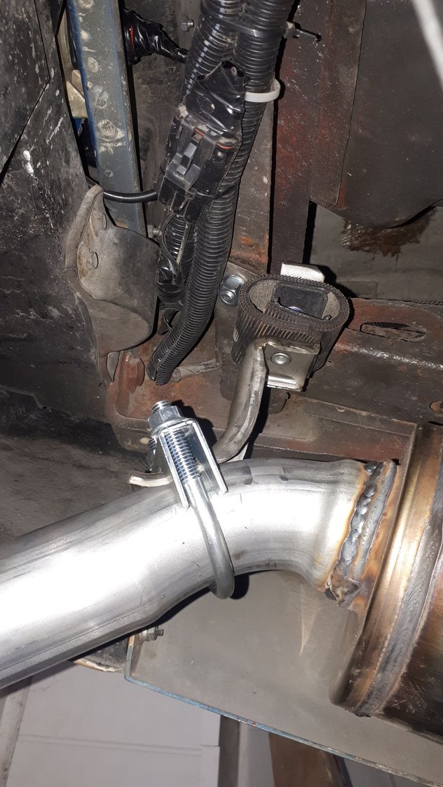

Hello everyone .
I have to reassemble an exhaust line on my 74 c3 and I can't find where to put this fixing point. currently I have a fixing point just behind the muffler and one before the central crosspiece
Thanks a lot

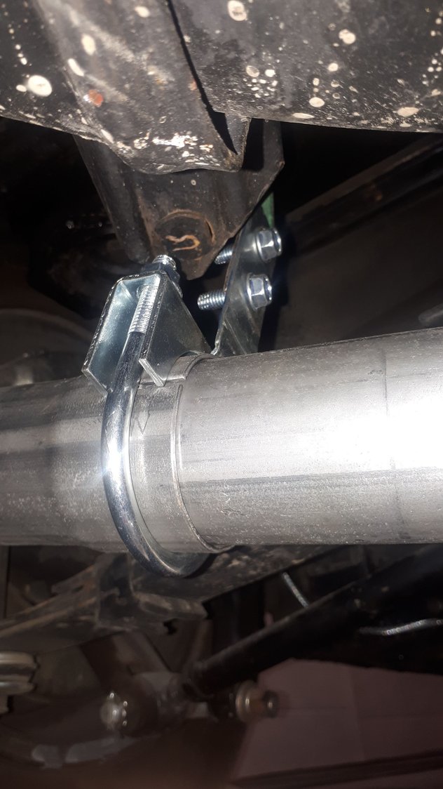

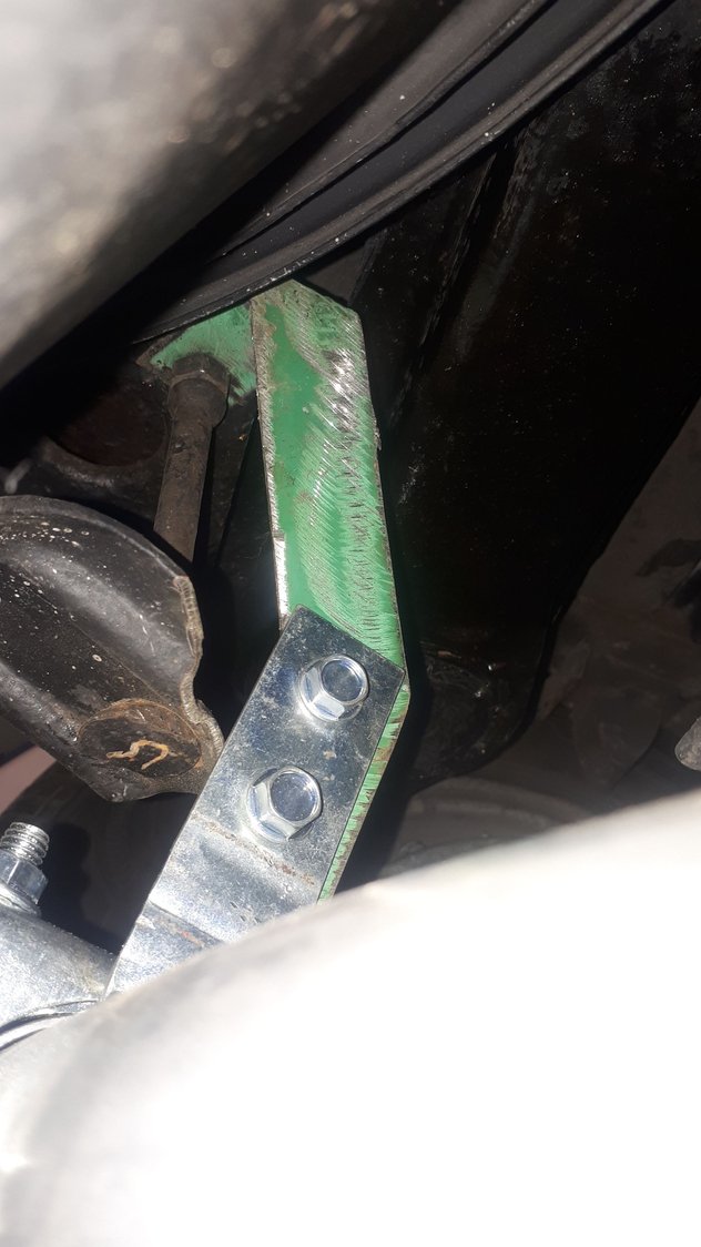

here are the 2 fixing points that I currently have

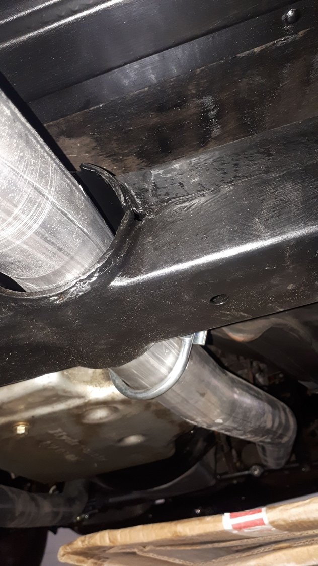

and the third intermediate point but which is not fixed to the chassis

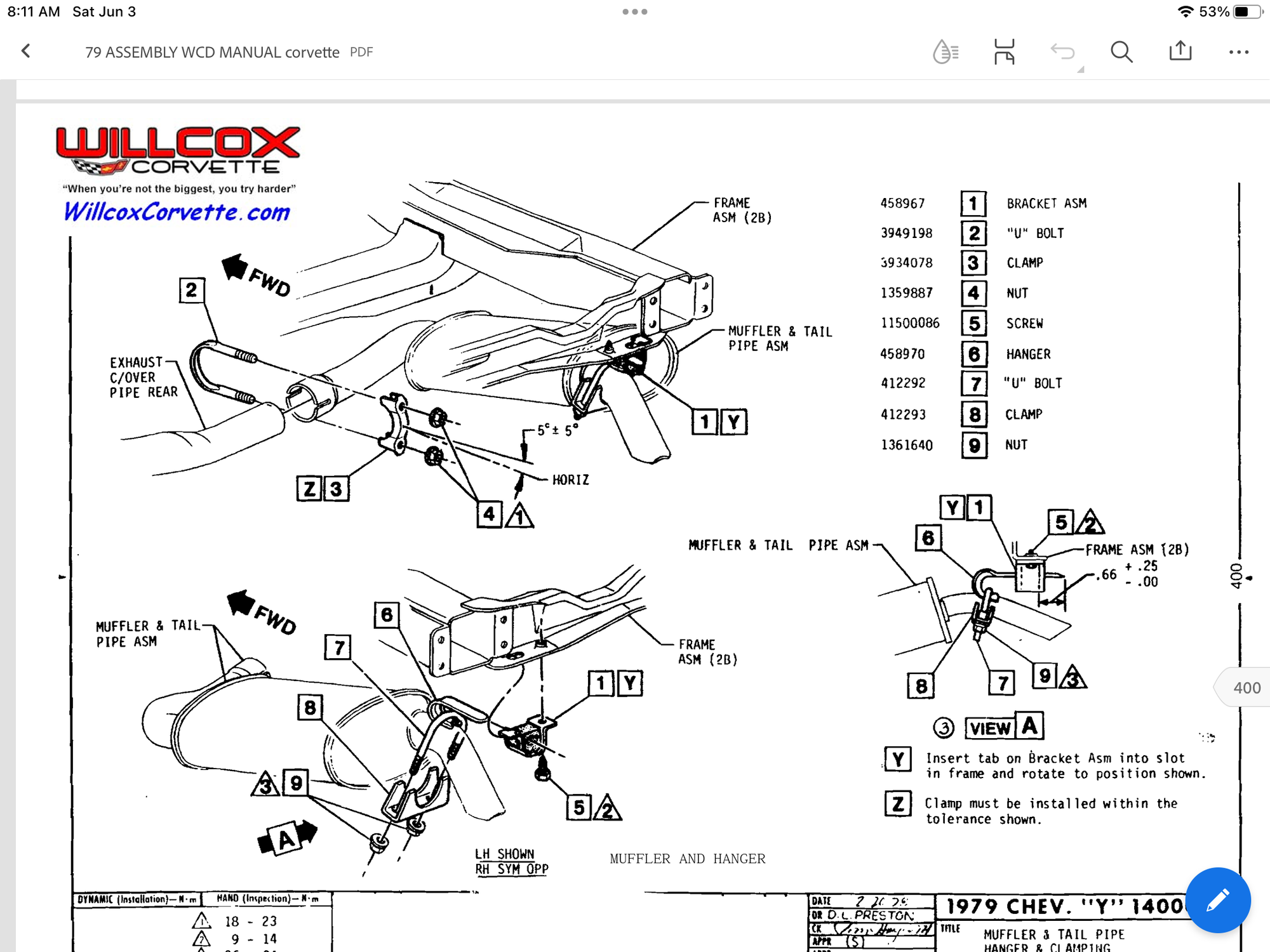

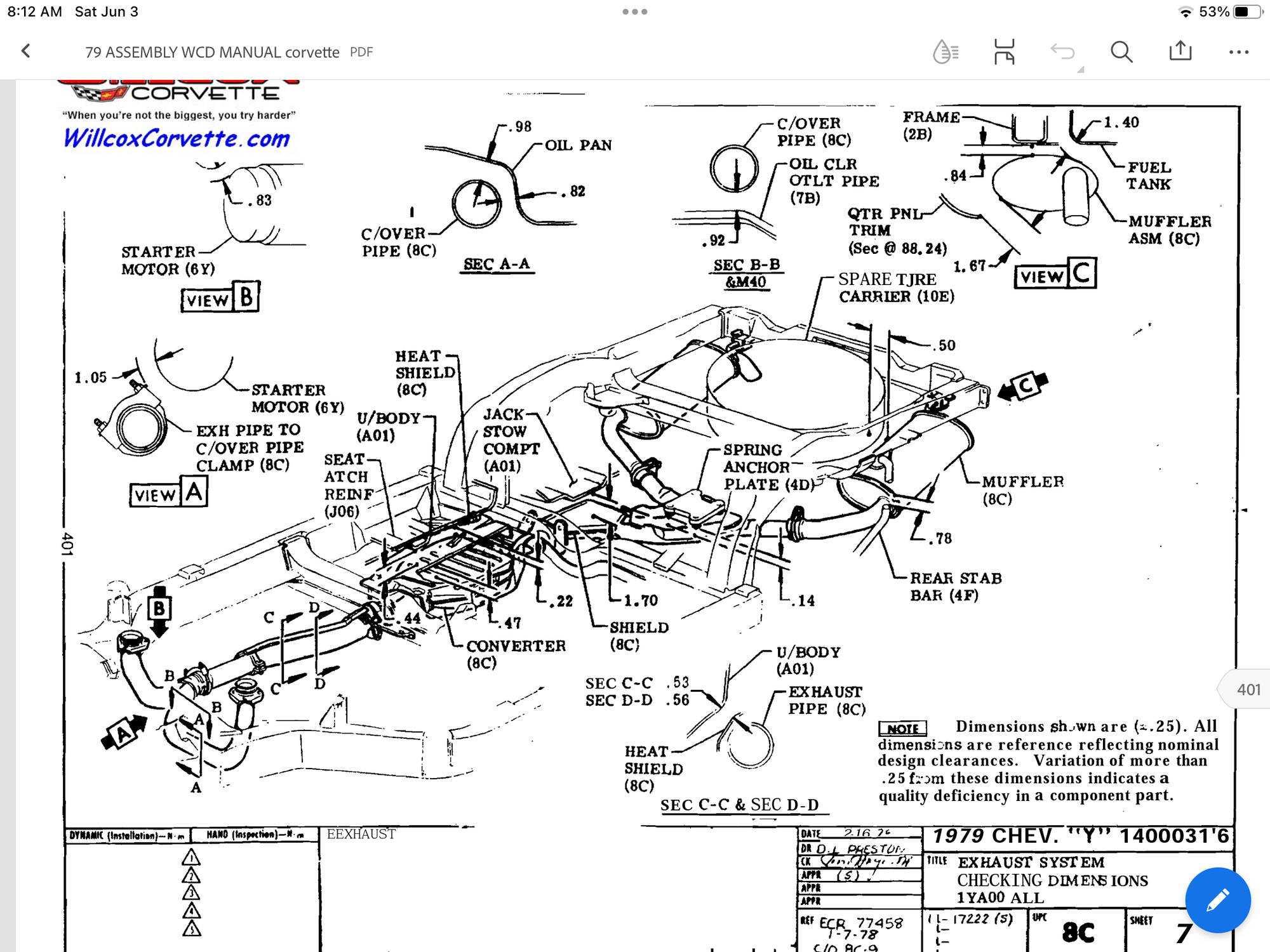

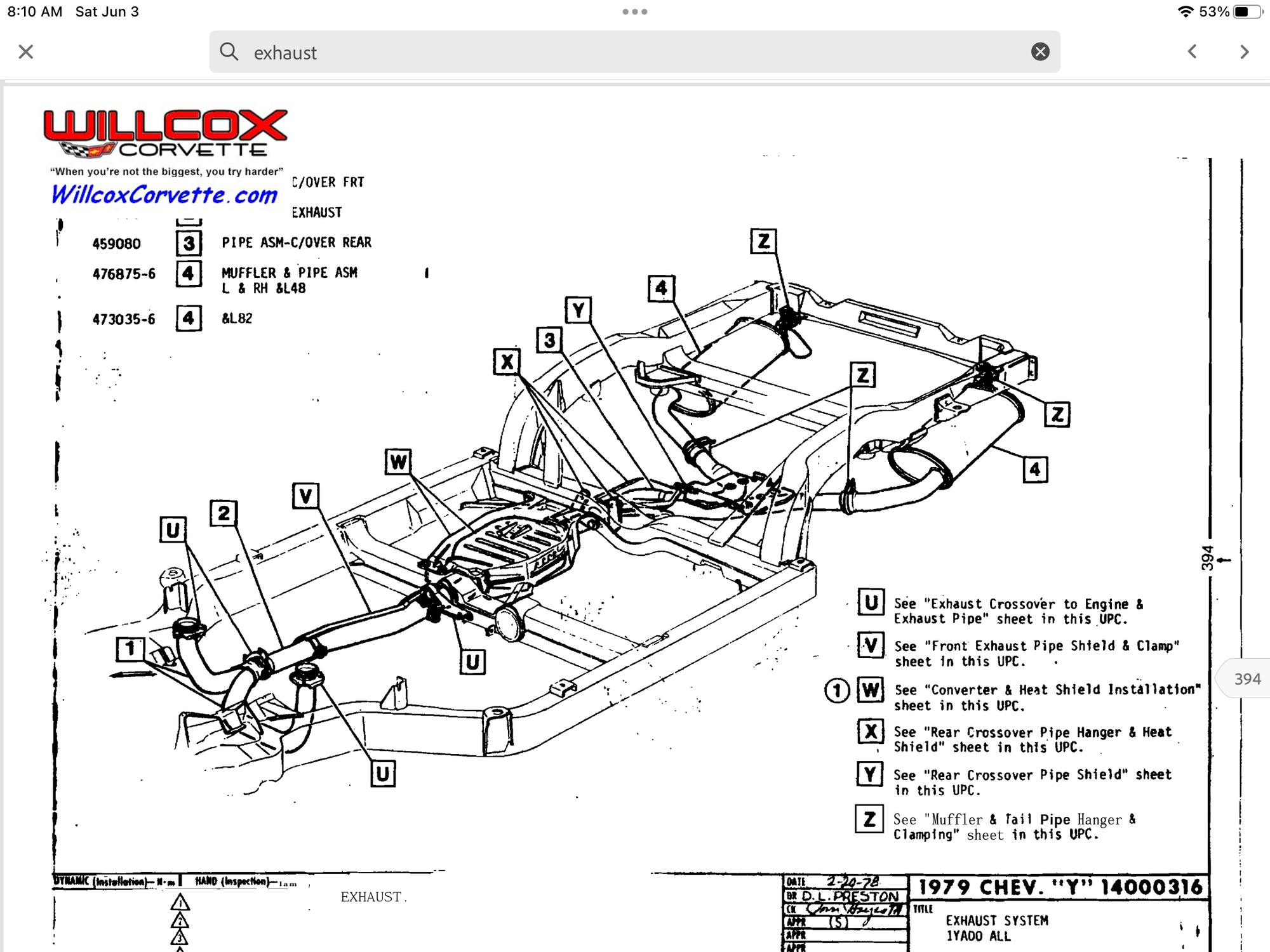

No clue on 74..but assume pretty close to a 79..
pretty sure those are not factory locations.
crossmember area is the first hang point then muffler tailpipe..thats it.

Thank you le mans

Were you able to mount those brackets on the crossmember?

no, no fixing point on this side of the central crosspiece, I am fixed on the box support on the other side of the central crosspiece

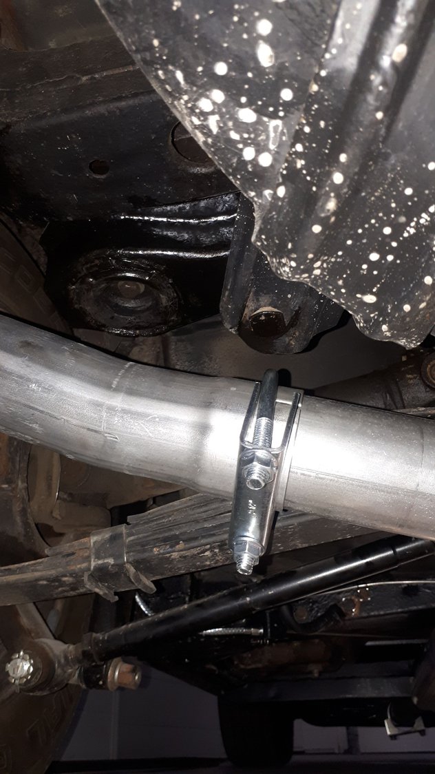

here is what I did this morning, I am fixed under the fixing point of the spare wheel tray

Not that I disagree with modifications...heck, I modify everything, but do you have a picture of your center support at the tranny crossmember? I don't understand why you need this extra support?
