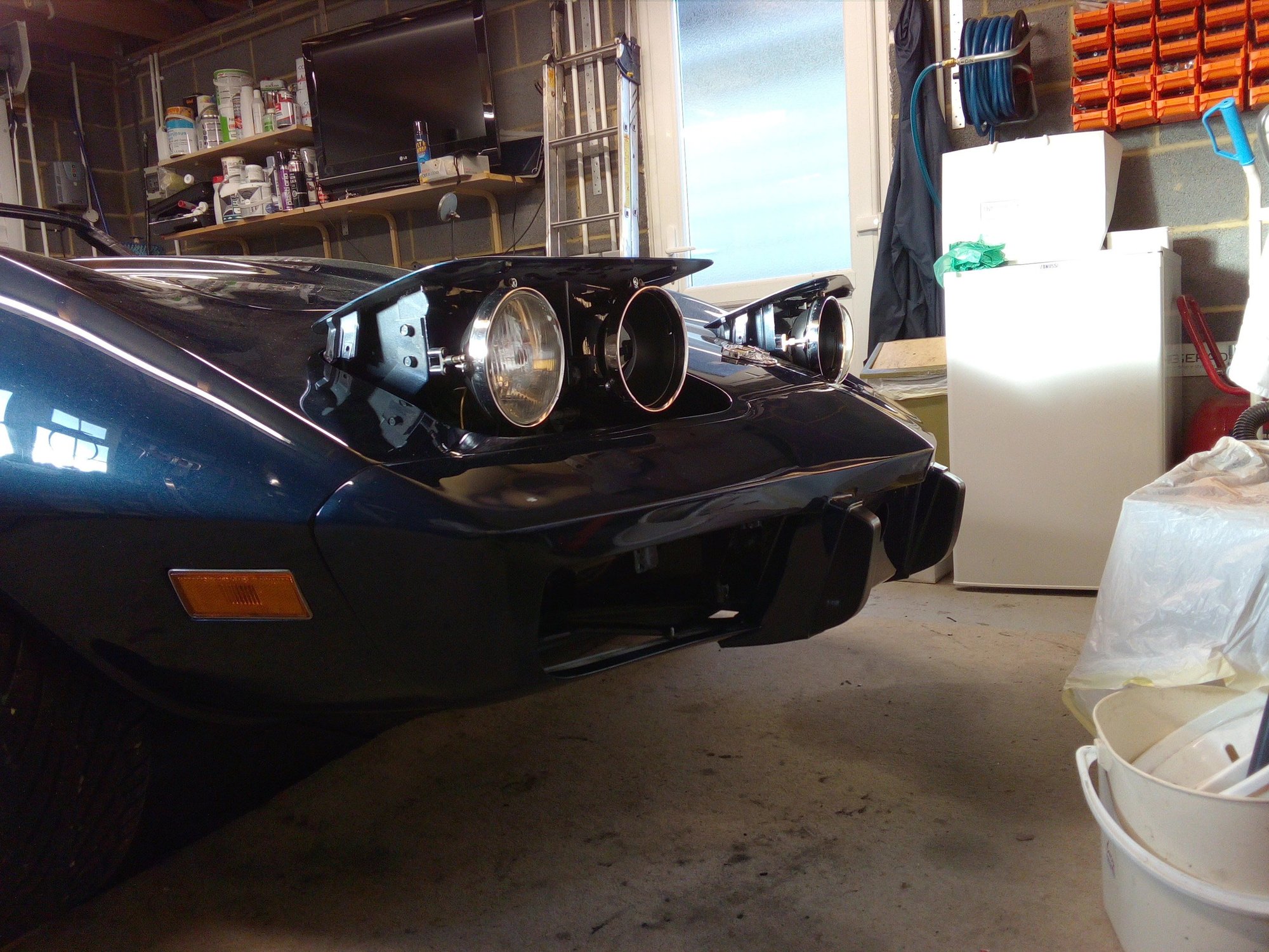

I think it turned out fine. He painted the fibreglass covers that hide all the mechanisms separately. The photo below was taken as I was refitting the headlamp buckets, headlamps and chrome rings.
To C3 Headlight Assy Remove/Replace
