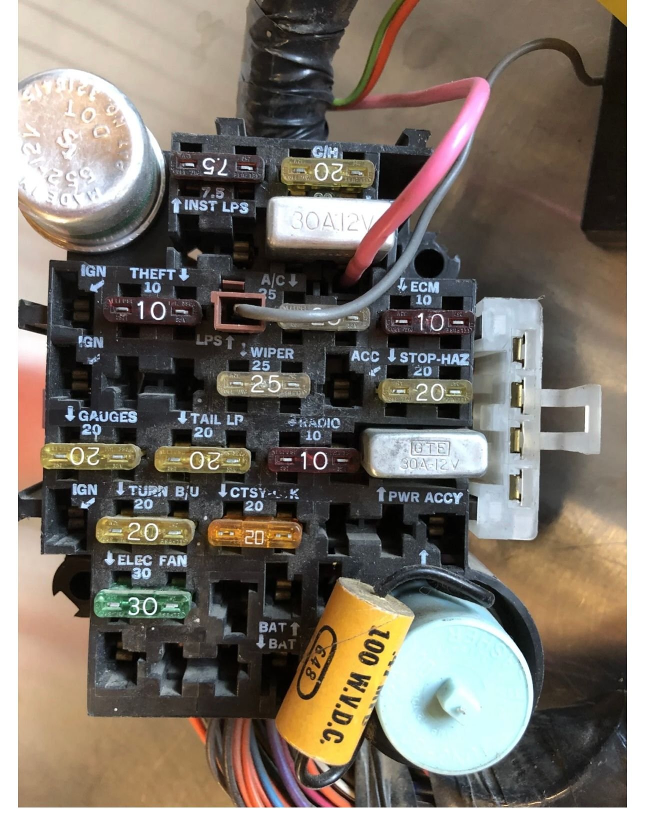

Hey all, looking to prep for sniper2 on my 81 and am looking ahead to the switched ign power source. The under dash panel has multiple spaces for ign power sources but i dont want to just put any random connector in there.
does anyone know where i can get the pigtail/connector for the switched ign in the photo below?
Thanks

There's a tap that goes into those plugs which is meant for a pass-though connection (provides a new socket on the back side) That I've used before PICO 958-BP. Those sockets are keyed so it's a different one for batt or acc
I'm sure there's a pigtail somewhere but I don't know what it is or where you'd get one short of hunting old 80s cars in a wrecking yard.
Not exactly what you're looking for but maybe a starting point. Should be readily available

Thanks Mooser! I loomed on zip, exkler, classic industries etc with no luck - glad im not losing my mind….

American Autowire 500429. A fairly inexpensive kit with what looks like you're after
I see summit sells the kit. I think it's what you are looking for

Yup, a couple of other options as well
https://www.corvetteforum.com/forums...ctor-plug.html
