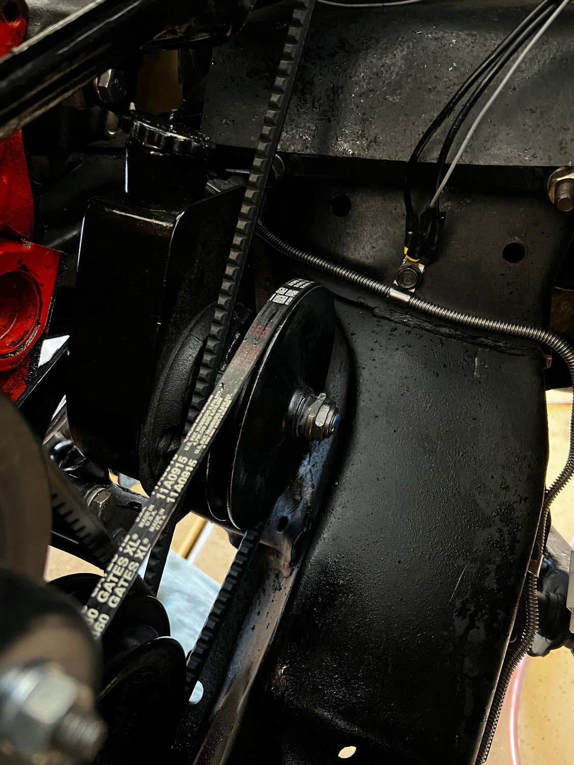

What diameter pulley is on your pump and what belt configuration is driving it? (A pic may help here).

That looks right as far as pulley and belts. If the inlet to the reservoir is restricted then the return fluid will build pressure at the hose - I believe 4-vettes first mentioned the inlet fitting. Can you easily blow air into the reservoir through the tube?

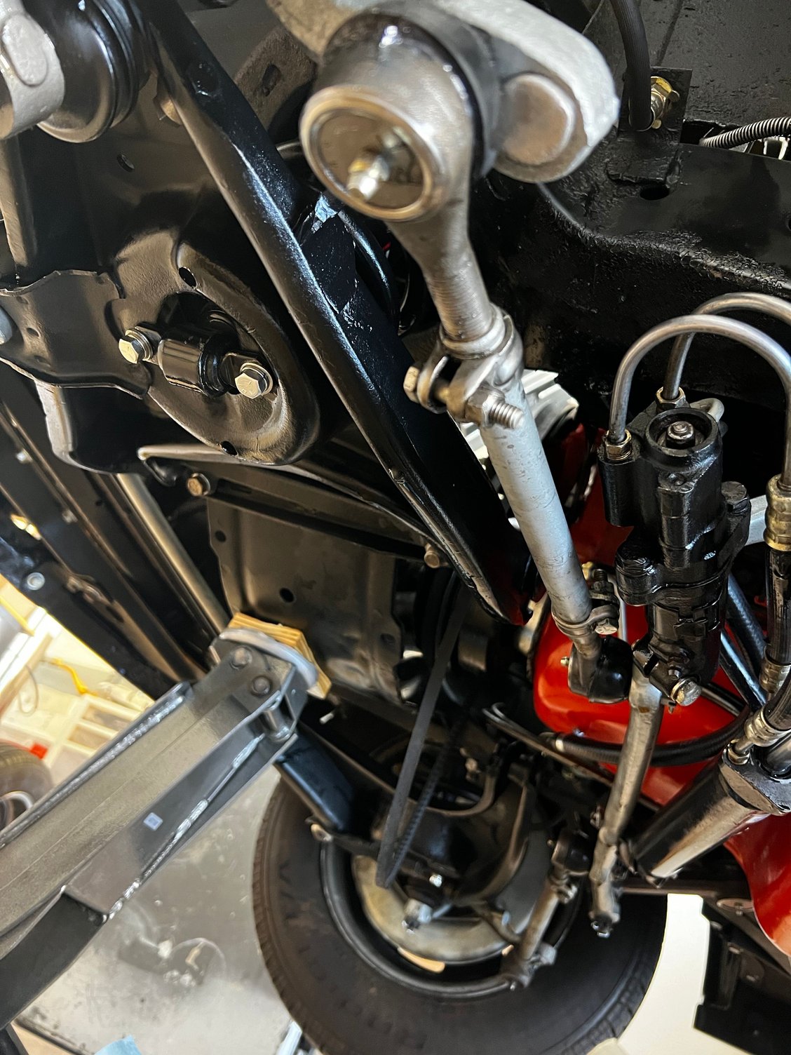

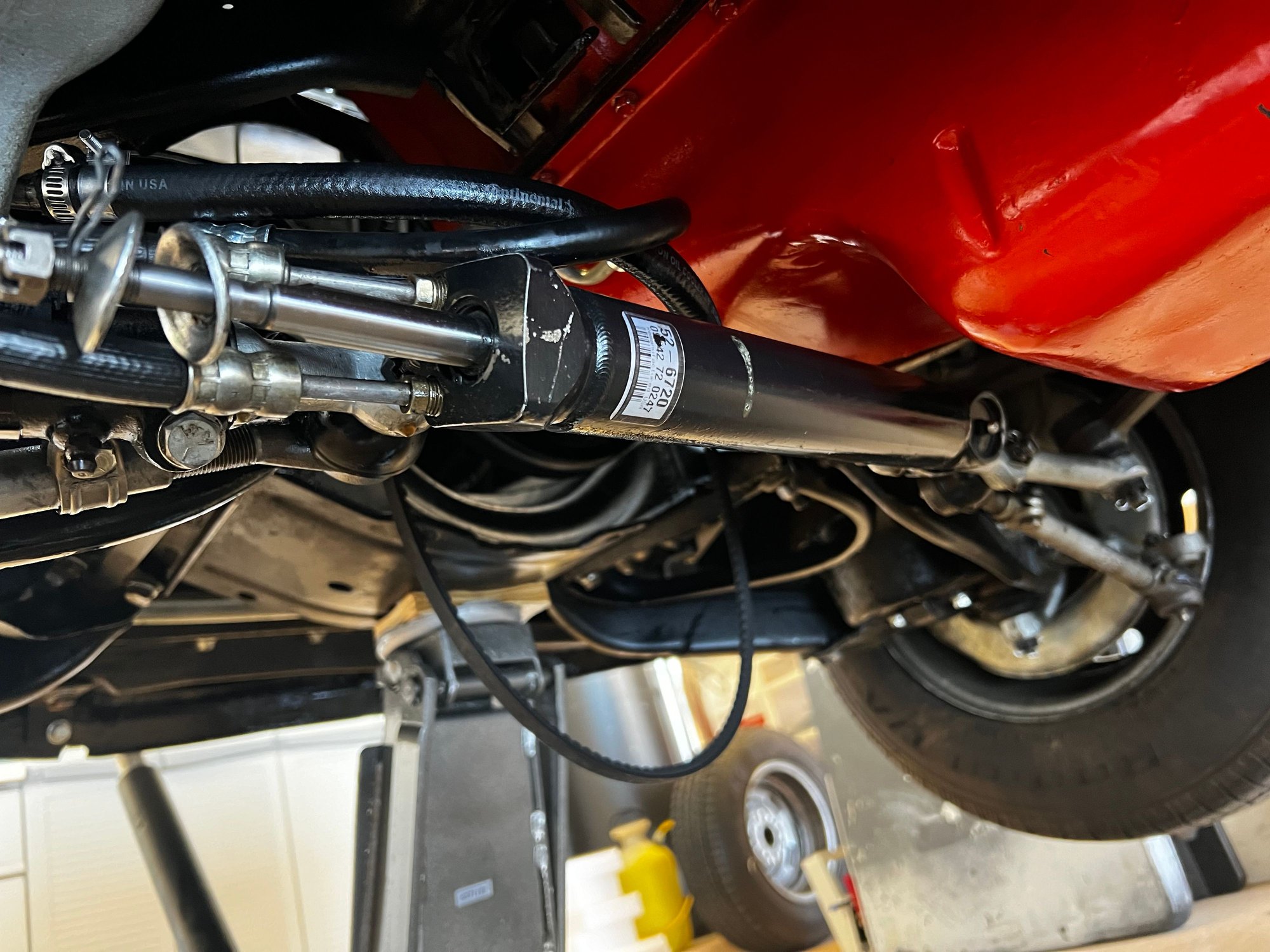

Not that I can imagine this being related to your problem, but did you loosen the firewall connection when you lowered the steering column? If not, that's a great way to deform your lower steering column bushing.
Perhaps no one asked. Do you have stock steering components? Can you post pictures?
Old Mar 2, 2024 | 03:07 PM
Rv8driver's Avatar
Rv8driver
Joined: Feb 2024
Posts: 17
Likes: 5
From: Tucson
As far as I know everything is stock
