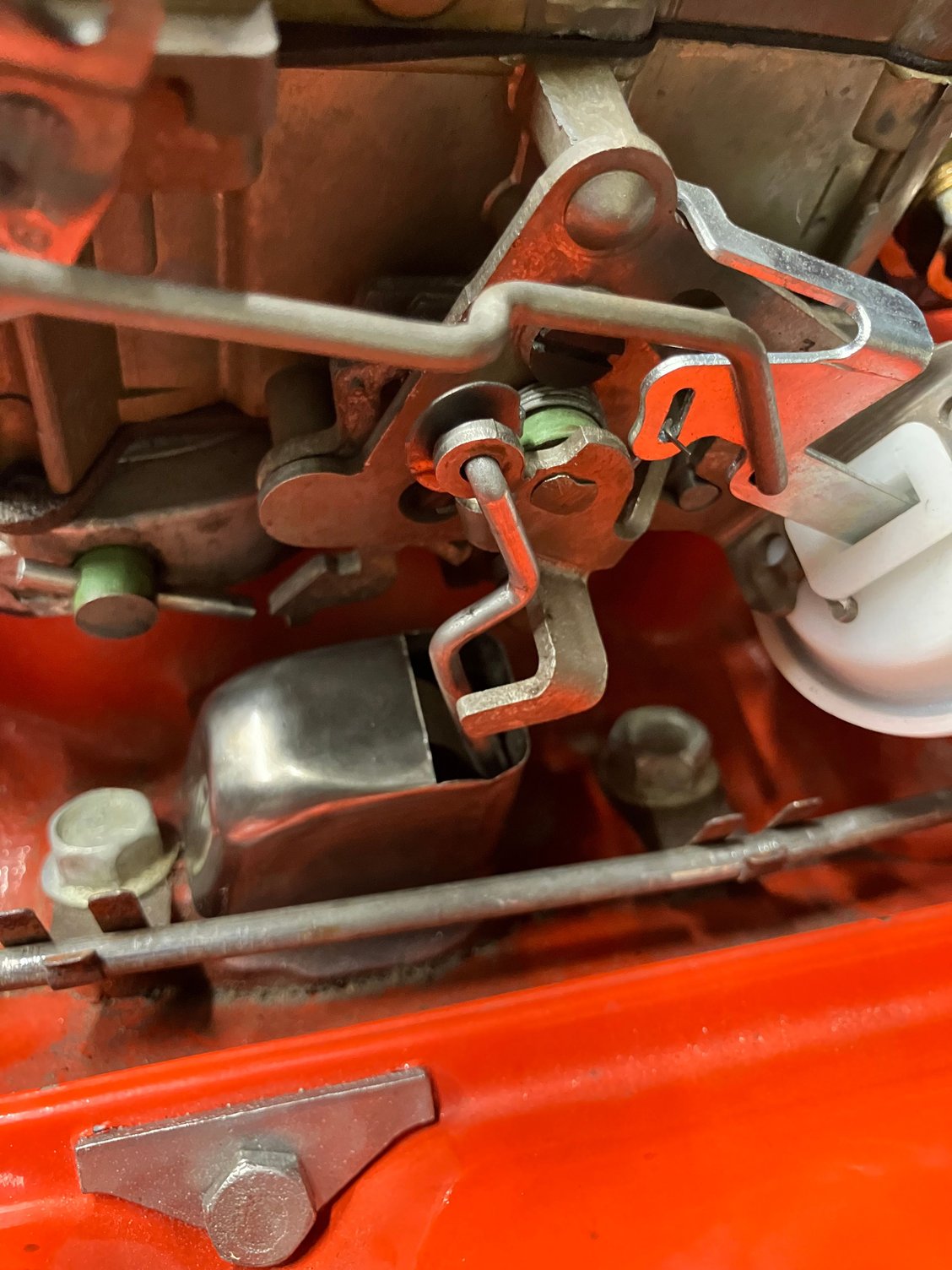

Default 71 LS5 choke linkage
Does this look correct for the 71 LS5 choke rod orientation?

Originally Posted by QIK59
You need to turn the choke rod around 180 degrees so the rod clip is on the outside of the carb lever not on the inside like you show
OK, that how I originally had it but thiugh5 there was a clearance issue. 👍
