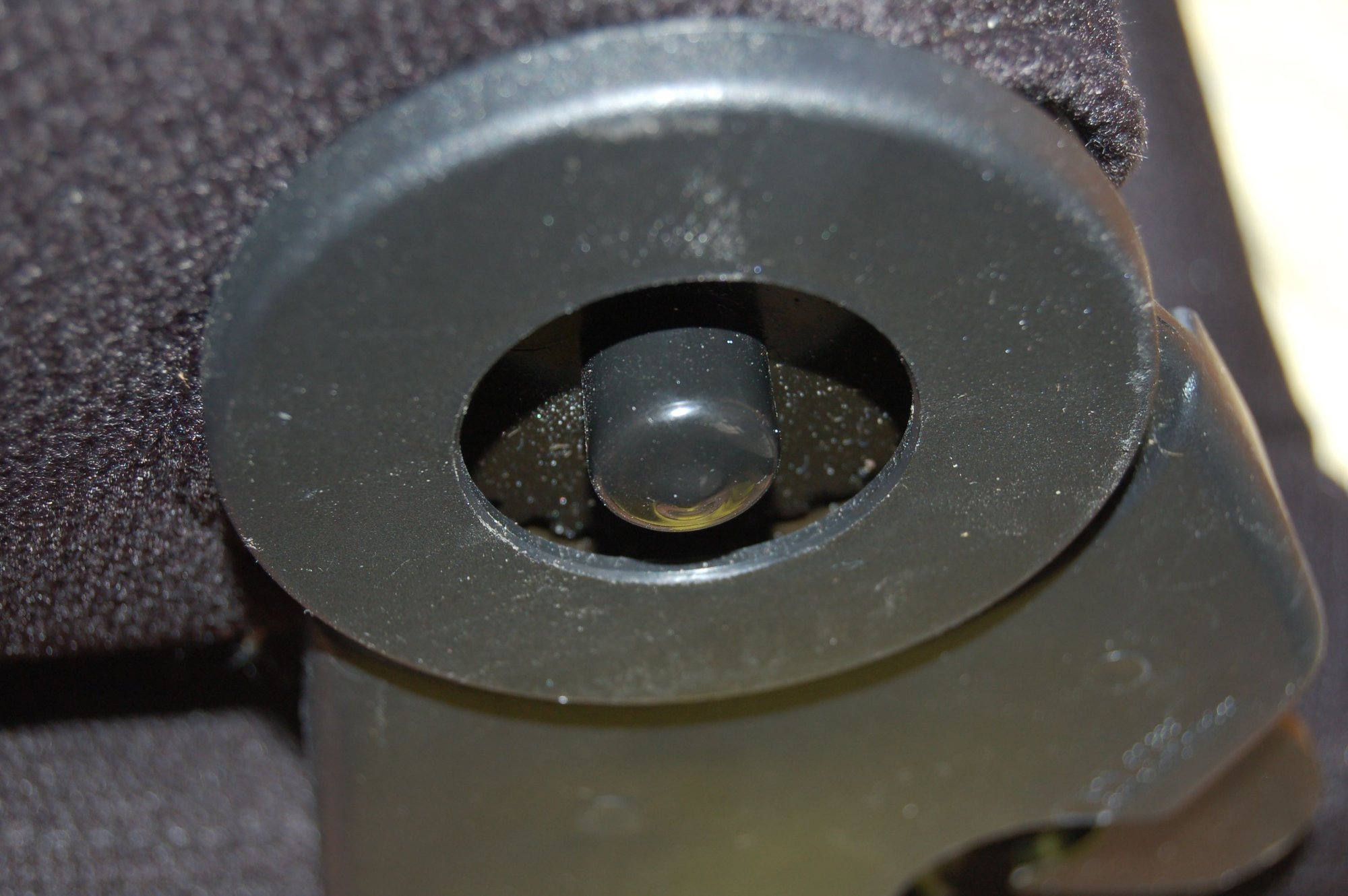

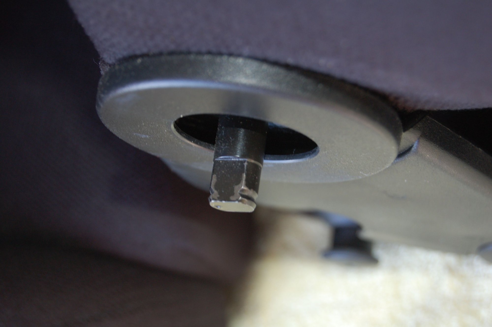

Great that you searched for and ran across the fitment thread. I can't directly answer your question about your particular choice, but if you saw my post about Recaros with a tilting control mechanism, I had to saw off one half of the tilt mechanism control on ( think) the passenger console side. I sold them to a member here and I don't have a clear picture of the modified seat. Driver's seat went in unmodified and there seems to be more room on that side. The control on those seats was some kind of wheel and these seem to be the before and after. If you can tilt from either side, I would guess you would be OK to remove what doesn't fit. Sorry I don't have dimensions for you.

Thank you for the explanation and pics ignatz! I think I could handle doing as you had on those Recaro's. I like how you covered the shaft afterwards as well. Hoping someone else can/will still chime in on the dimensions after lookung at them to further reinforce my thinking that these will work. Thanks again! 😀
