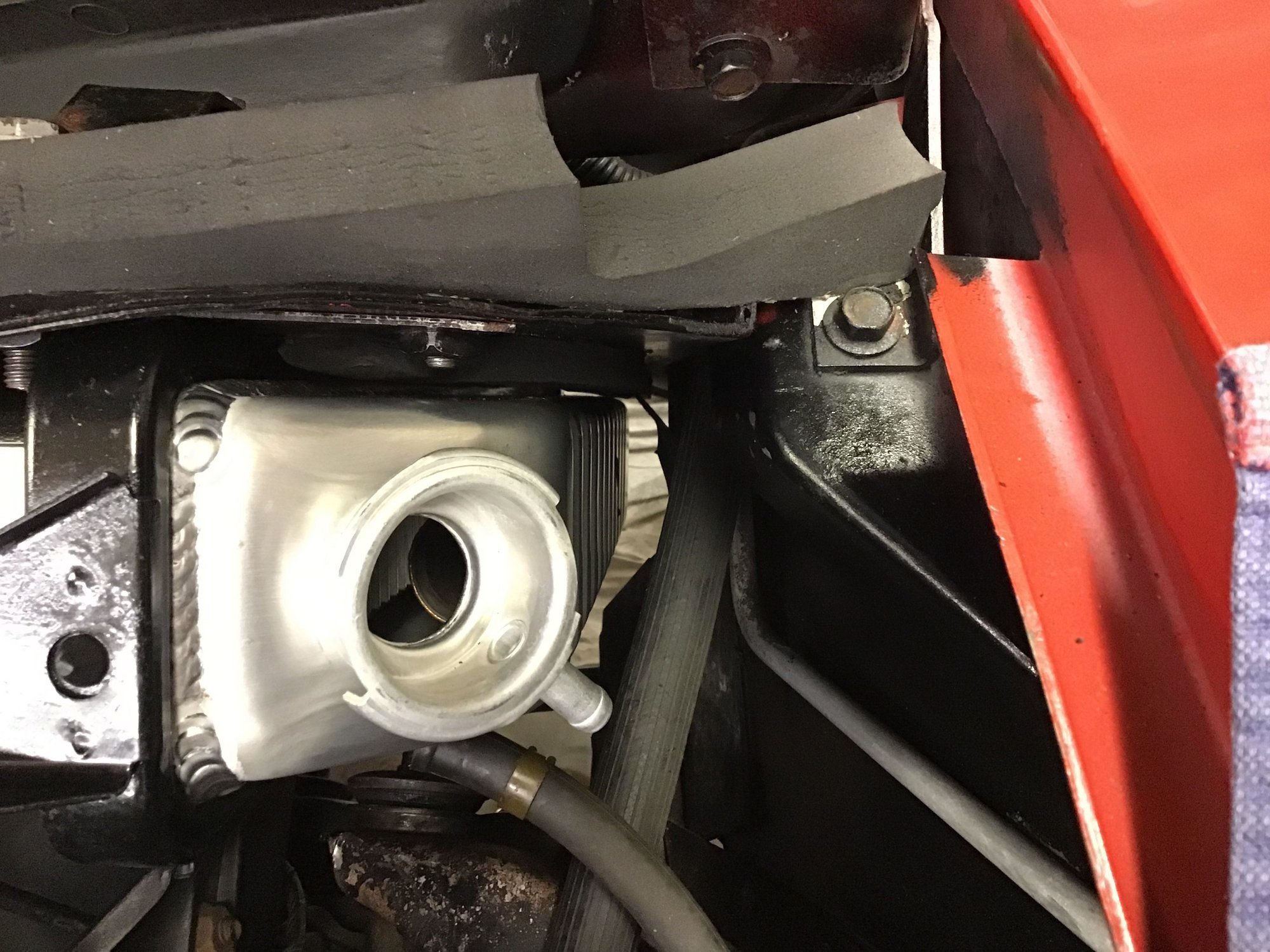

here you go.. my 79 doing what you are planning.. i went universal fit Dewitts from Zip. Aluminum is the only way to go as i do not look at my temp gauge anymore..
- while there replace seals if gone..
- consider 180f thermostat
- if i did it again.. i would paint it black...

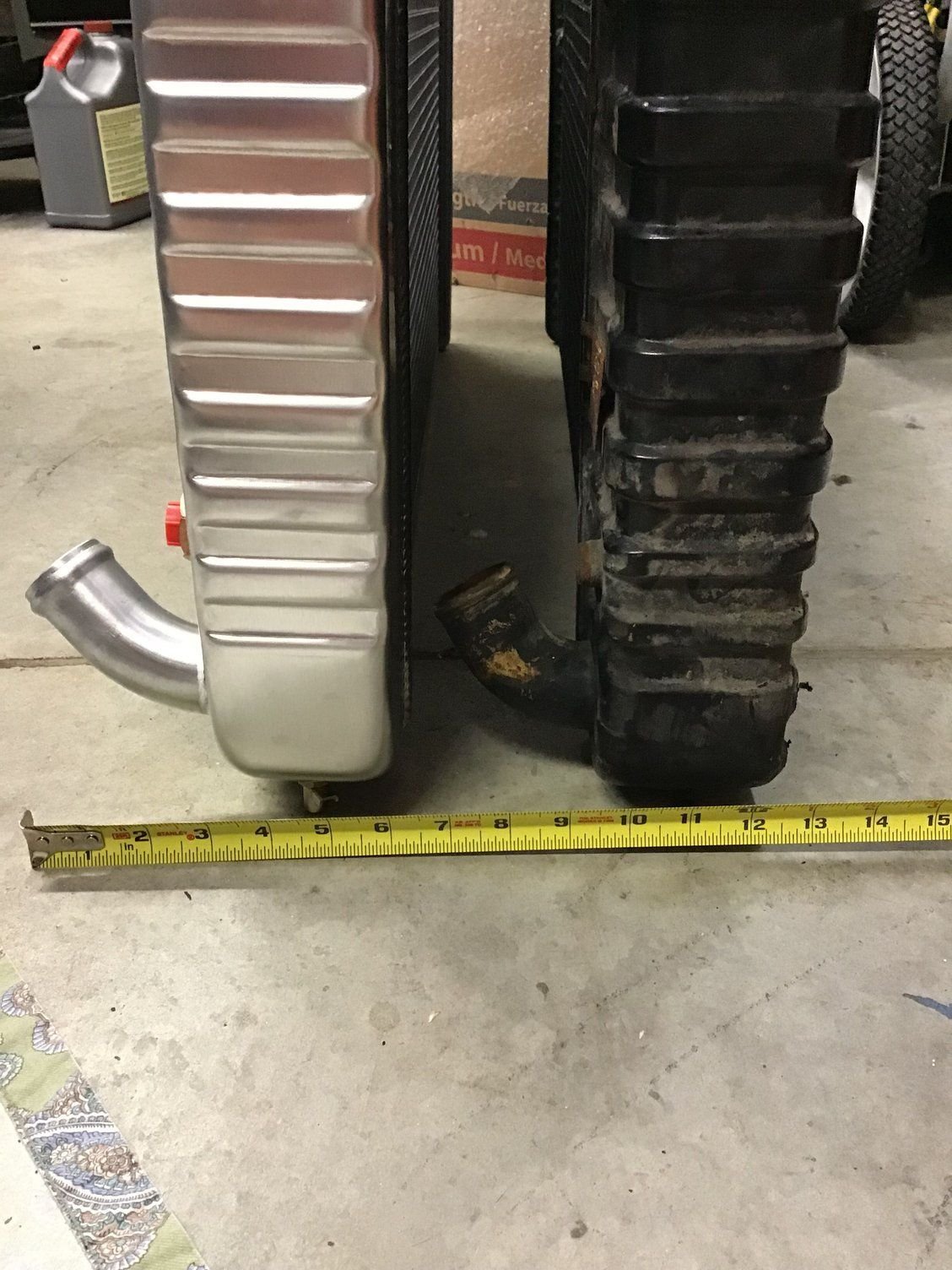

I have this. Fits perfectly and cools my Blueprint 350/341 HP no problem
