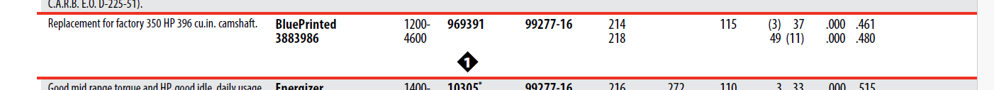

Crane used to make a blue-printed duplicate of your cam. I think it is still available today. It was the closest match anywhere.
It is finding a quality lifter I would be most concerned with.
BTW I always use printed cam manufacturers information.
So you would want a cam that has 214* duration @ .050,and 115* lobe separation. Hydraulic lifter. Anything with those specs would be virtually indistingushable from the stock specs. 218* on exhaust helps a little. This is a mild cam. It is all done by 5000 rpm.
You could easily go a couple degrees larger on this duration spec, and gain 10-20-25 HP. But it is all over 4000 rpm. For a lot of people this is irrelevant and a stock cam is fine. But only go 5* over to say 219*, or the engine starts to act differently. Many buyers do not care if the cam is upgraded a little bit, the factory ones are pretty mild. But they will care if it runs rough. Keep the cam specs with the car, especially if you upgrade it. It IS the heart of the engine. There are literally 1000 cams out there you could choose from, but if you stay in the 214-219* range, you'll be fine. But keep the lobe center wide, 112-115*, or it will run different. Both of those Melling cams are milder than that. Just focus on those three numbers, and you can ignore the rest of the confusing cam info.

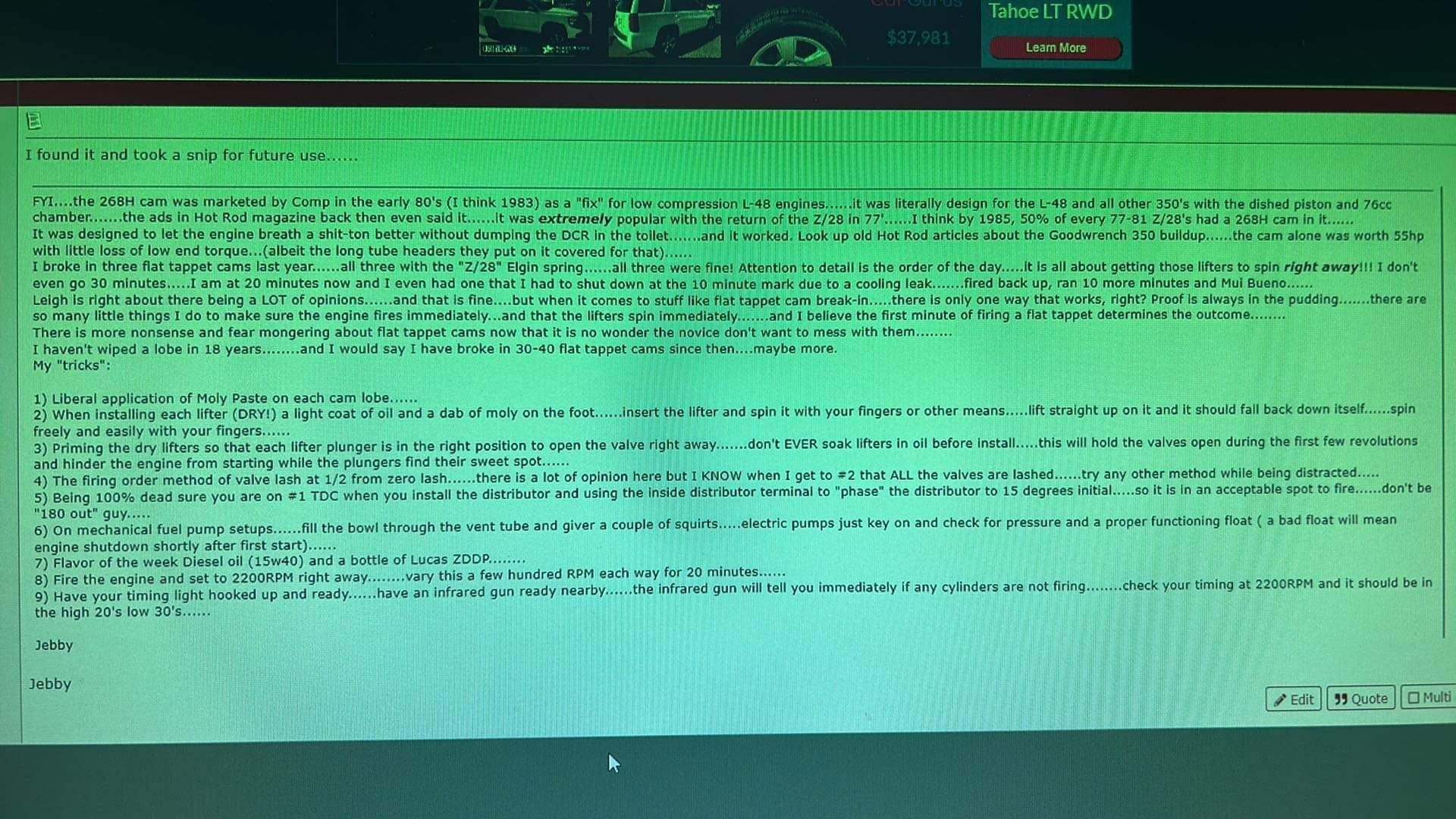

You mentioned 236* cam above, that would be very rowdy. Even the TriPower 435 HP L71 had a smaller cam than that. This is a Hydraulic version of the L71/72/LS6 cam: With a 229* intake. I doubt you would want to change yours that much, but it is still very driveable in a 427, but the idle vacuum is lower, and you would need to tune the carb & distributor some for it to run just right. That is 14* larger than your cam! It will rev 1000+ rpm higher.
What ever you do I would suggest you do not buy a cam from Summit or Jegs, or a Melling. There are considerable differences in cam & lifter metalurgy these days, and some combinations just do not hold up. They wipe lobes. It is the quality of the lifters that gets talked about the most these days, or the lack thereof. You need an expert. There are several out there.
A hydraulic lifter cam can certainly survive these days, but you must use the right parts, and you must break it in properly.
Mike Jones is likely the premier cam grinder in the country, he will give you a stock cam or a slight upgrade, with excellent quality materials. His advice is like listening to the "Master" There are other experts out there, just do your research and choose wisely, before you take their advice.
Any mechanic can put a cam in your car. But the days are long gone when most knew how to install a flat tappet cam without a lobe failure. Choose wisely. Check references, history.
Jebbysan on this forum, has an excellent start-up / break-in procedure. This MUST to be followed for hydraulic cams. You must visibly watch the lifters spin, while rotating the crank, BEFORE you even start the engine. You must do everything you can to tune the engine, so that it starts INSTANTLY, and goes IMMEDIATELY to 2000 rpm. Do all this and it should last. Extended cranking, multiple starts, or idling, on the FIRST start, kills cam lobes.

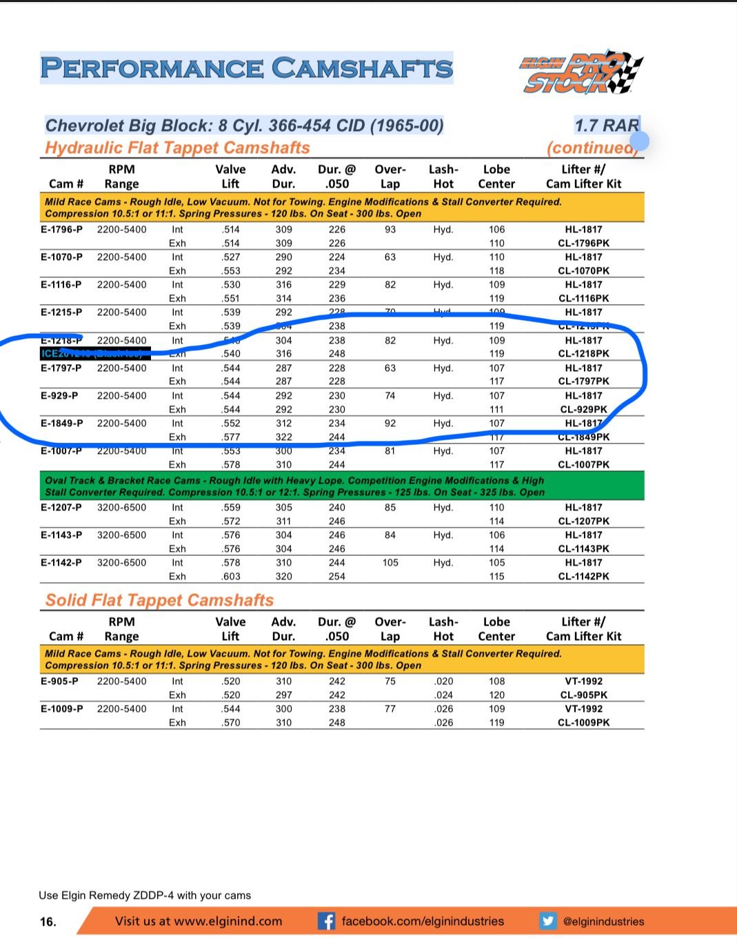

First off....the cams you listed Mr. Rick from Melling are measuring lift and duration @ 1.6 rocker ratio. Big Blocks are 1.7....so none of that information is correct. Knowing that....the duration is still in the right area....
Having owned a 69' 427/400.....the stock cam is absolutely a joke....and would be a mild performance cam for a 350....my 427 had a Comp 268H in it when I bought it and it was a little on the mild side....but it ran very good....pulled hard.....
For street Big Blocks with flat tappets....I like the ".544" cams I have been using since the 90's....there are two....one has a little more overlap....the smaller overlap is where I would have you....they are in the blue circle:
The large oval port needs to breathe....so let it breathe.....but going anymore will do nothing as you have the terribly restrictive stock exhaust on your car....
You may need to change the metering rods on the secondaries of the Q-Jet.....add a little timing....that's it.....but you will not believe the performance increase....
Jebby
