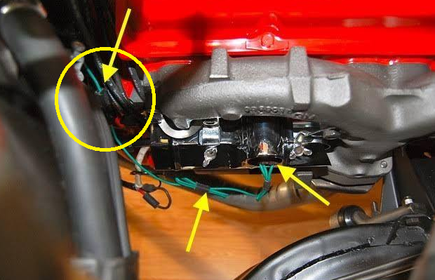

All 1970 corvettes had the Transmission Controlled Spark(TCS) system. It essentially disabled vacuum advance under certain conditions.
As part of that system there is a two-terminal coolant temperature switch on the right head between the two rear spark plugs. (see image)
The two terminals of the switch are tied together with a Green wire which leads to the TCS relay mounted on the firewall.
Some have a direct connection wire between switch and relay, others may have a simple single wire connector in between.
Which does your '70 have and what is your build date?
The green wire is shown here:. The single wire connector is circled

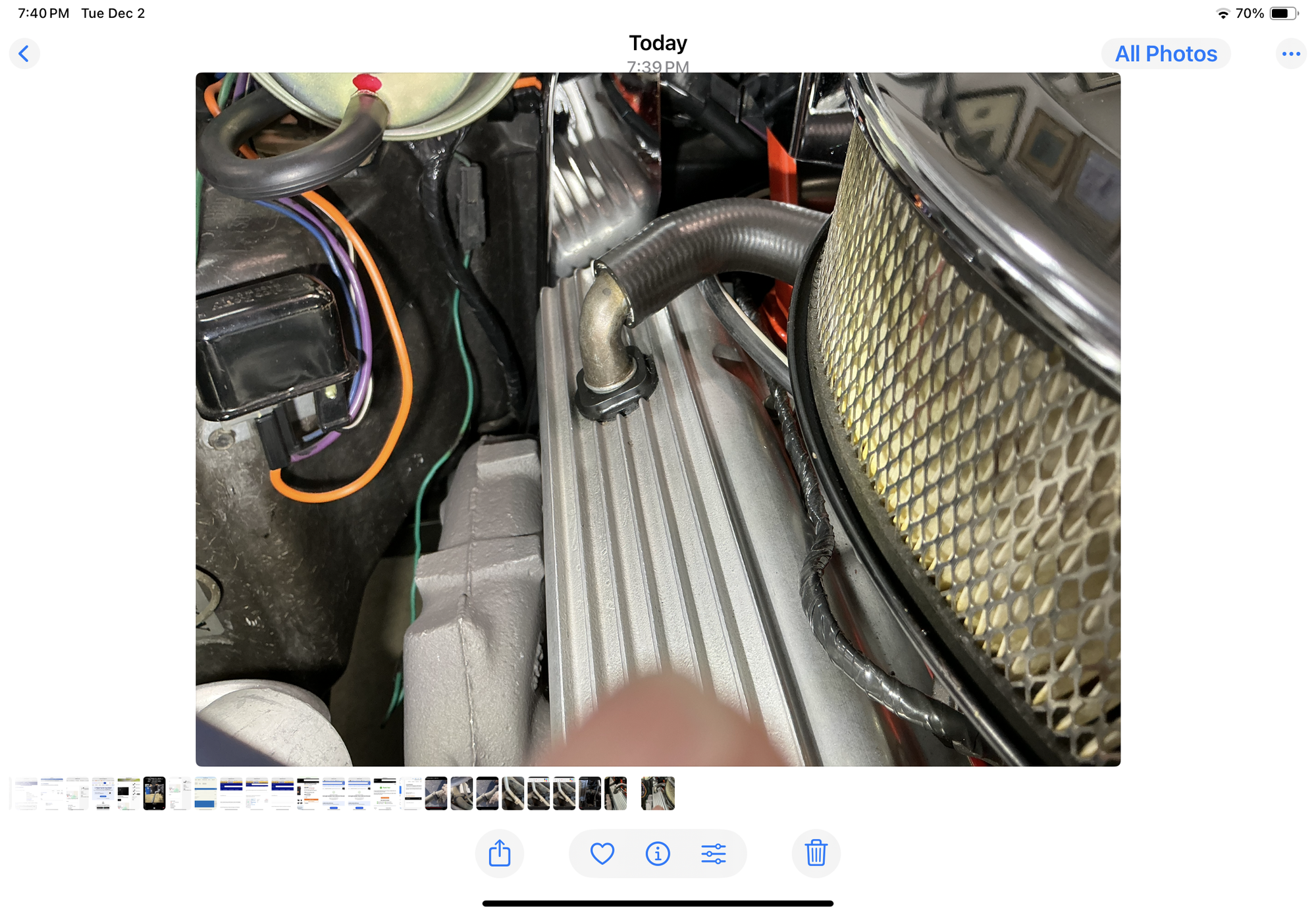

June 1970 Build and I have 1 green wire coming out of the switch.
Last edited by SJ3; Dec 2, 2025 at 07:32 PM. Reason: Adding picture in response to post #3

I updated my post with a pic. I guess I have the same as yours….?

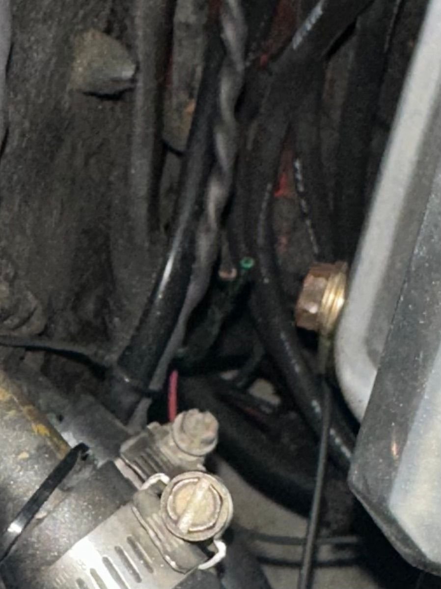

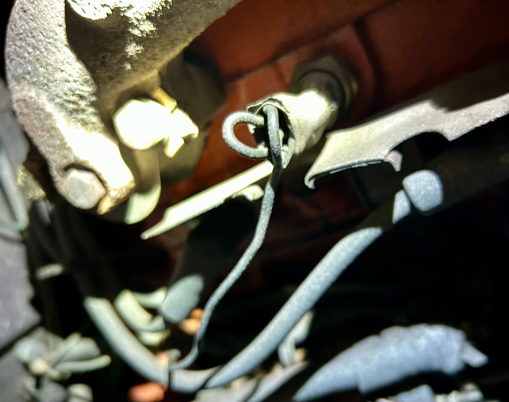

All that stuff was long gone when I bought my 70 in 2001 but I think I found the green wire.
