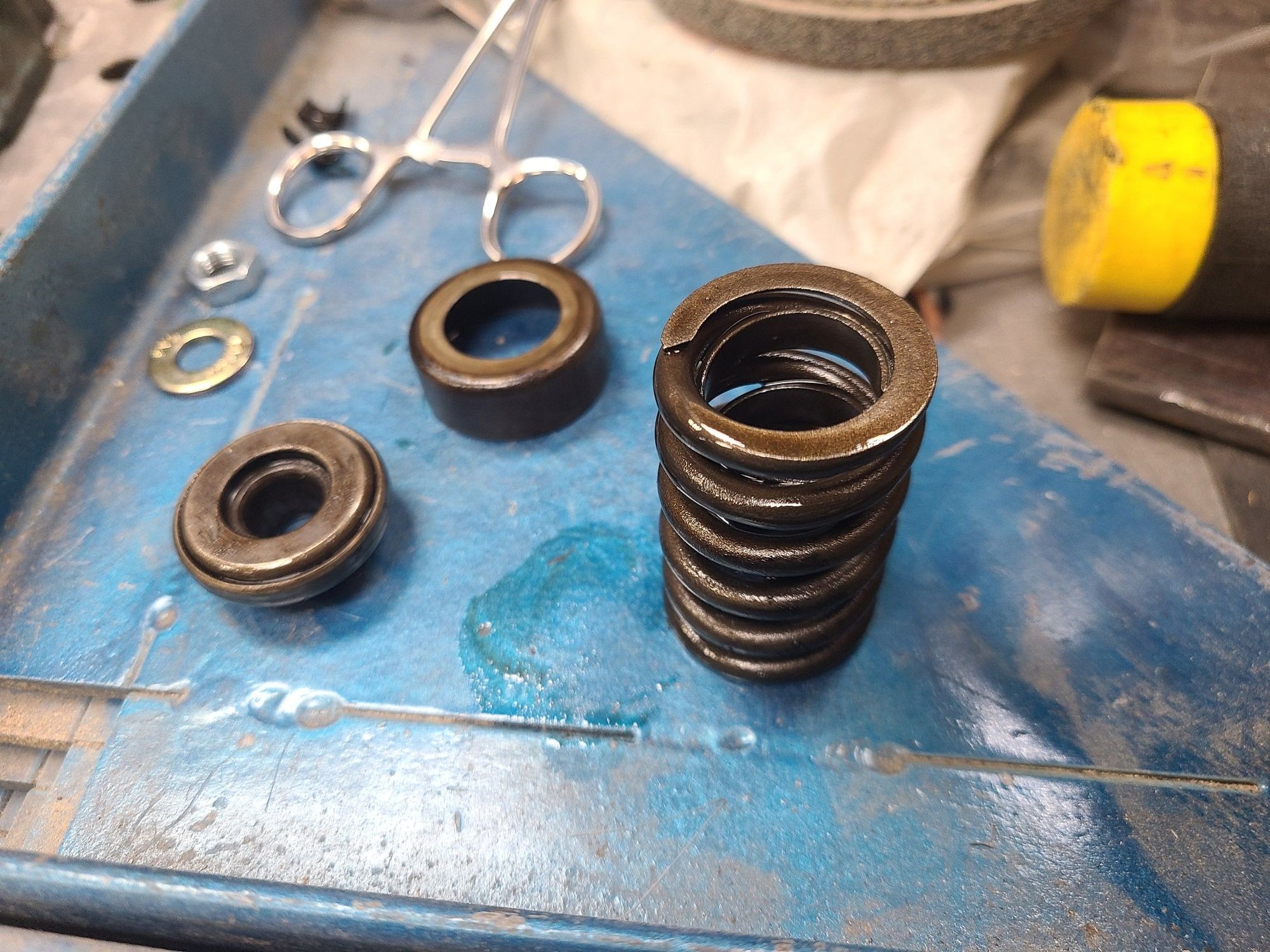

I did manage to remove the springs from the #7 exhaust valve and the valve guide is good, I didn't have time to put my test indicator on it but I could not feel any movement at all.
JT
JT
Now for the other 15
Was the spring assembly comprised of a single (round cross-section) wire-wound coil + an inner damper made of thin flat steel ?
Was the square-sided rubber O-ring (stem seal) in place (groove just below key groove) And Viable ?
I got my best test indicator out and the valve guide has 0.002" clearance and the service limit is 0.0037".
Yes, that accurately describes the spring.
The square O-ring looked OK but the seal was loose on the valve stem.
JT

Those black umbrellas are aftermarket seals added later during service.

Something didn't seem correct so I read the service manual again and sure enough I measured the clearance the wrong direction. Measuring from the side the clearance is 0.0032" so that's close enough to the service limit of 0.0037" that I'm not wanting to bother with the OEM heads now and just get a set of 64cc aluminum heads.
JT
