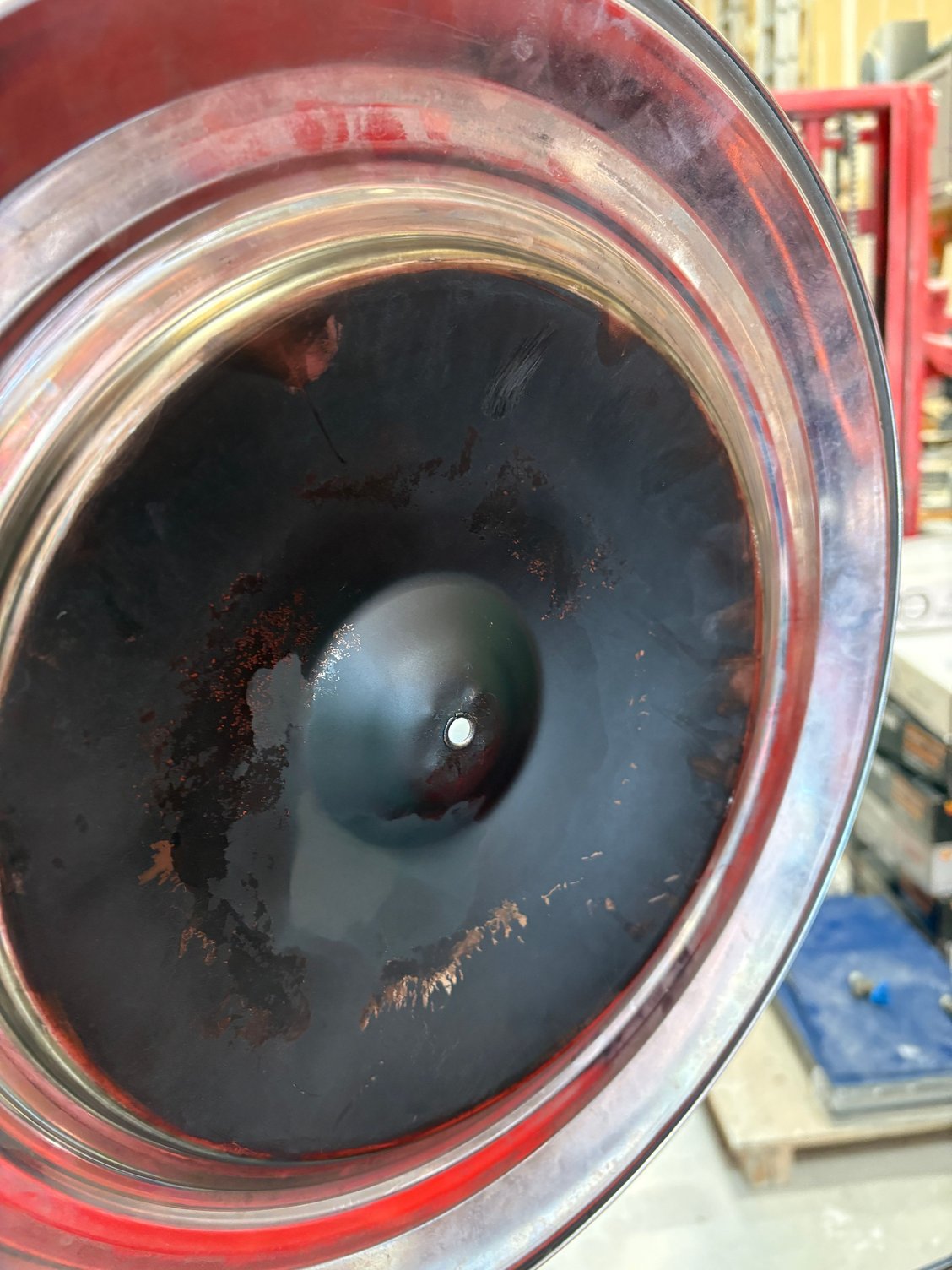

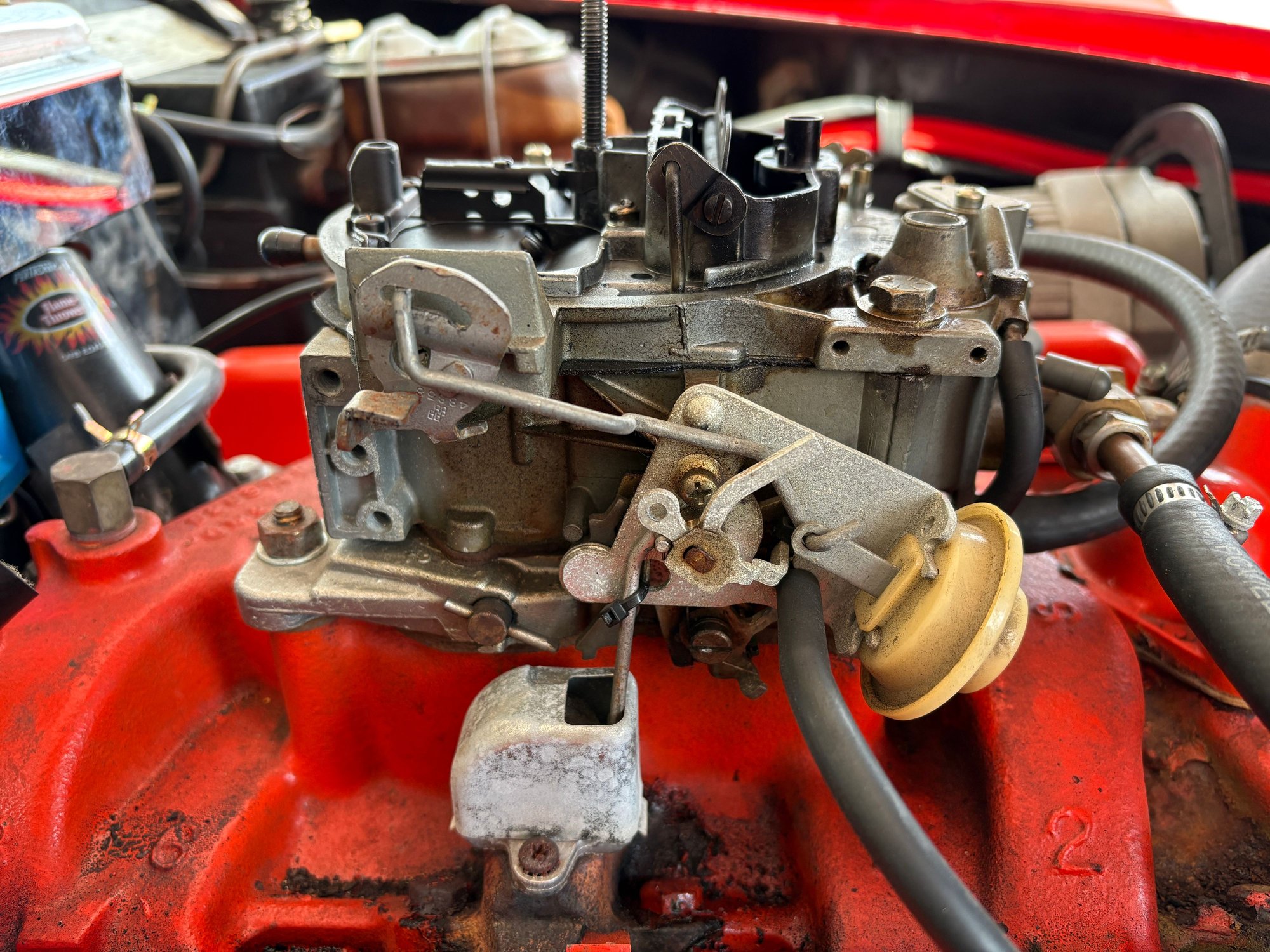

I need some help from one of you Carburetor guru’s, Here are my problem. I have a 72 C3 with stock 350 and a manual transmission, when checking to see if I needed a new air filter I found a lot of soot on the underside of the cover as well as the inside of the carb so I was going to rebuild the carb and adjust the air fuel mixture. After looking up the numbers on the Rochester Quadrajet it appears to have been swapped out with the carb from a 77 Oldsmobile with an automatic transmission the numbers on the carb are as follows 17057258 3046 APY. After inspecting the carb I noticed that the rod that should be connected to the choke coil lever has been tie wrapped off as shown in the photo also the choke coil lever does not rotate. Why should someone do that and what would cause the choke lever to get stuck any help with this would be greatly appreciated.

Your carb is a complete, "frankencarb" pieced-together piece of junk that has been assembled from various random parts from different years, makes, and models (both 4MV and M4M) Q-Jets, none of which are compatible with each other. It is beyond salvation, and needs to go in the trash can. Find a good, used, unmolested, rebuildable Q-Jet for your car that is the correct year and model carb for your application. The exhaust gas reversion sooting up through the carb is indication of timing problems with your engine - usually a bad case of retarded timing.

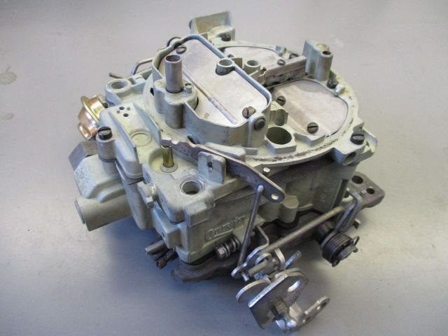

The 1972 Q-Jet looks like this. Compare to what you have:
Start looking for a good, rebuildable core. There is no point at all in attempting to do any "adjustment" or "repair" work to the pile of parts you currently have.

I'm no Q Jet guru but, essentially the zip tie has "wired the choke open". You have a non functioning choke. I'm sure others will comment on your other questions.

Thanks Lars, I greatly appreciate the advice and photos, I have found a few things on this car that were not done quite right that I have had to fix.
I’m glad I waited before waisting my money on rebuilding this one.
I was thinking this may be an engine blow-by/PCV issue where the vapors have gotten baked on. Is there any merit in that idea?
