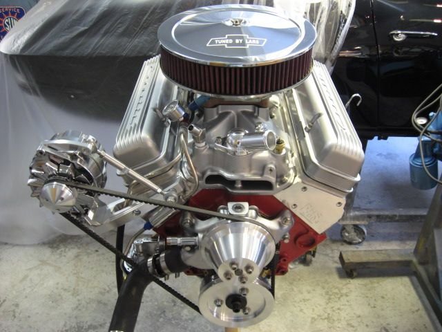

I did a system very similar to Jim's when installing 1964 Valve covers on the 407 SBC that I built for my '64 - I wanted the engine to appear "vintage correct." I used a pair of the Steph's Manufacturing valve cover spacers (to clear the roller valve train) and installed the breather and PCV into the spacers. There is a baffle on the inside to prevent direct oil ingestion into the system. Works perfectly:
