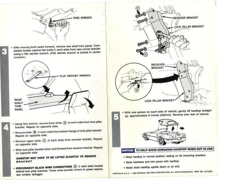

I just bought a hardtop for my 94 convertible. I have all the hardware, but not sure how to install it so I can put the top on. Can anyone direct me to any factory instructions or other help? Thank you kindly.

Here's the instruction manual fo rinstalling the factory hardtop:
They may not appear in the correct order, but each step is numbered. You should be able to print each image and keep them in the car.

Thank you, c4cruiser!
