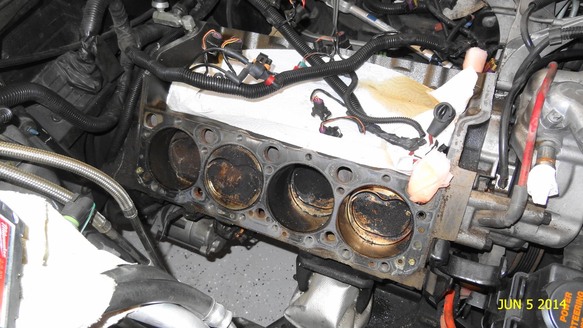

And for all your sanity, Don't let ANYTHING FALL INTO THE LOWER PART OF THE ENGINE (nuts, bolts, washers). That will make this a much more difficult job. You'll probably have to pull the pan, and possibly the engine if that happens.
Notice how clean the after pics are that are shown from PLRX, cleanliness is extremely important.

OK! Got the heads off, and sure enough, had a bad gasket.
I was told (and shown) that the heads tend to develop a crack in the middle of the head along a bolt hole. The remedy is to drill the hole, put in a bushing. One head has this, the other does not. I plan to but a bushing in both heads.
