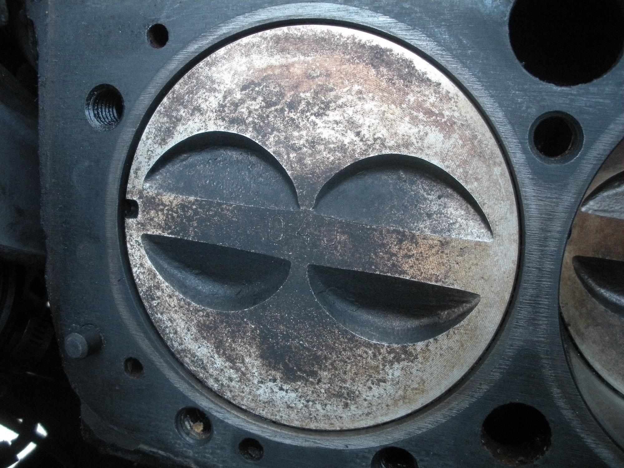

First . . . Complete rebuild @ 185,000 miles. (Note the unusual pistons, as opposed to Joe C's in post #2.)

SBC iron heads info:
Notice the valve reliefs. Joe has the original pistons, which must be installed with the valve reliefs toward the intake manifold. This means the wrist pin must be in the center of the piston, so the pistons on one side of the engine are upside down from the other side of the engine in relation to the rotation of the engine. (The "front" of the piston on one side is facing the "back" of the engine on the other side.)
My pistons have a notch that faces the front of the engine, because my pistons have the wrist pins slightly off-center in the piston. This requires four valve reliefs, because the pistons must all be oriented facing the same direction. This "off-center" of the wrist pin reduces the side loading of the piston during the power stroke to reduce piston skirt wear and slightly increases the power output of the engine because of the reduced friction. There is a slight change in the con rod angle, too.

Sorry. Side track on iron heads was not intentional. Differences in pistons is still relevant, though.
