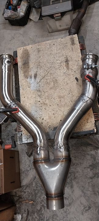

The Y-Pipe welded up and mostly smoothed out. It took a lot of figuring and laying on my back to get this shape right and able to tuck up under the X-Brace.

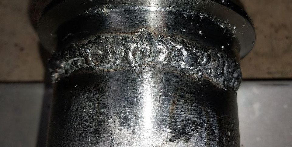

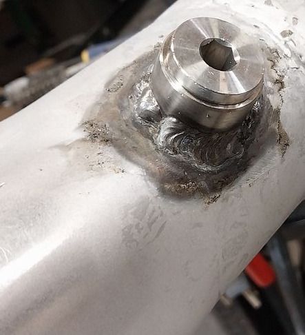

Some crappy welds and a decent one. I found I could not weld a circular pattern, could not keep a puddle and had to do a zig zag stitch or I would blow right through the thin stainless. Blow through happened far more than I wanted and fixing them meant a large blob to grind down. The blow through areas had more leaks than the rest. In the end it worked, even with a crappy little 110 welder.
The ugly one...
The "better" ones... (using the aluminum foil to shield most of the splatter worked quite well.) The O2 bungs turned out to be the easiest to weld, I was expected them to be the worst because of the thickness difference. I just kept the heat on the bung and quickly dropped it into the pipe. The bungs are 5" from the merge collector point, which should work well for a consistent reading.

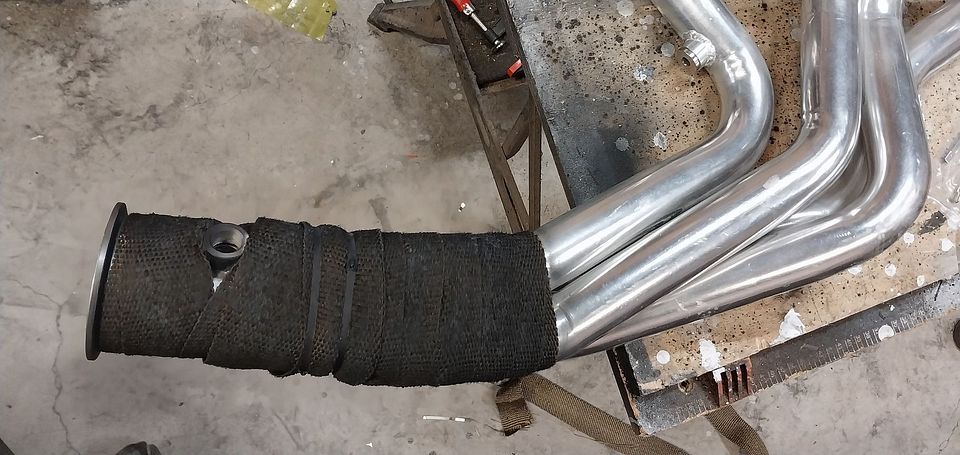

The mostly finished setup. Design Engineering heat wrap and black silicone spray, aluminum heat shield over the "Y". I wrapped the headers where the factory shielding was lacking, no need to go all the way up the header tubes.

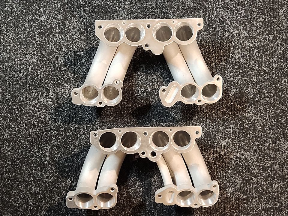

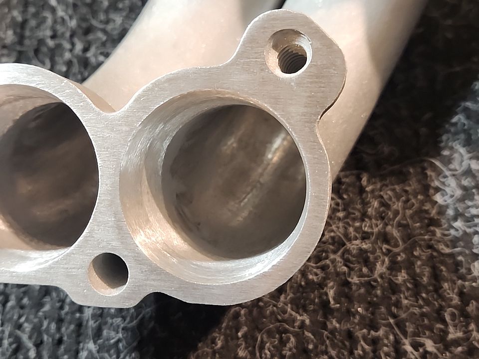

I mentioned I was going to send out the 90 intake runners to be punched out to a larger size, I did and got them back. They are roughly 39mm and finished nicely. A bit thanks to High Flow TPI for getting these turned around so quick. I won't install these until I take a shot at porting the intake lower and upper.

Great work...but don't give up on the practice welds...
