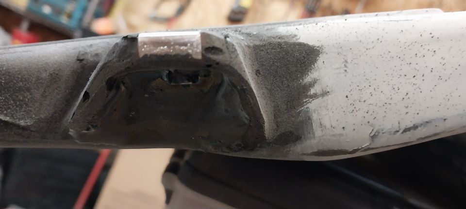

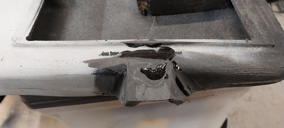

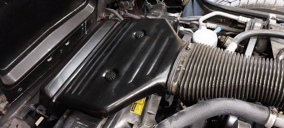

It is almost time to paint the airbox, but a lot of "fixing" needed to be done. The tabs where the filter lid screwed on were broken off, one of the previous owners used two large screw clamps around the airbox and lid to hold the filter in place. There is a decent amount of upward force on these, which is probably why they were broken off. If I want to fix these I am going to have to recreate the tabs in a way that they will be ale to handle the forces applied to them.
The problem. You can see the two tabs broken off in the upper part of the pic. Fortunately I had one piece of the broken off tabs as it was attached to the lid so I could see the proper shape of the tab and location/placement of the U-shaped speed nut. If anyone needs to do this in the future the correct thread is an m6x1. I bought a 50 pack in 304 stainless for $10, probably a two lifetime supply but it was cheaper to buy 50 than two, go figure.
I still had the filter part of the 90 base and it had close to the right shape I needed to replace the tabs.
I just needed to cut them out, heat them up and mold them into the right shape. This turned out to be harder than expected, the memory of this plastic is incredible, it took vice grips to hold them in shape, they held the heat in for several minutes so I could not hold it by hand.
Once they were close to the right shape, which you will note is conical, this is to provide the strength needed to keep them from pulling up, I began a series of epoxy and glass to get the shape finalized and for added strength.
Once the shape was right, the thickness right to hold the speed nut in the correct position I then epoxied the speed nut in place.
I had one more and insignificant concern to deal with, the inside where the two pieces overlap, it is an abrupt change in airflow, if I had been thinking far enough ahead I would have tapered these before epoxying them into place but I did not. I have a cheap burr set but they are not long enough to reach inside and shave down the edges. They need to be able to reach about 8" into the cavity and I could find none that long online. I used a long drill bit and "chewed" as much off as I could. It is not perfect but it is better. I really should have dealt with this before joining the two halves together. I think a 1/2"x18 or 21" belt sander would be the easiest tool to use to smooth the transition perfectly after the fact, but I don't have one and will probably have to revisit this transition in the future. The opening is still the original size of the 89 airbox, it is just that hard sharp angle I want to remove. It is probably completely irrelevant because the air flows from small 89 section into large 90 section and not directly into that 90 degree part but instead air flows over it, but it will create an eddy that will disrupt airflow. it also gave me the chance to ensure the epoxy that dripped out was cleaned up to keep it from breaking off in the future and going into the intake.
The problem.
After a good chewing with a drill bit. There will still be some turbulence but it won't be as bad now.
It is almost time for paint, I decided on 2K HotRod black, hoping it will be durable enough. Truck bed liner would be perfect, except for the crazy texture. I was unable to find one that didn't have crazy texture and the ones that has less texture were rubber based and that would not be durable. There is a Durabak-18 which is a smooth version but is cost prohibitive.

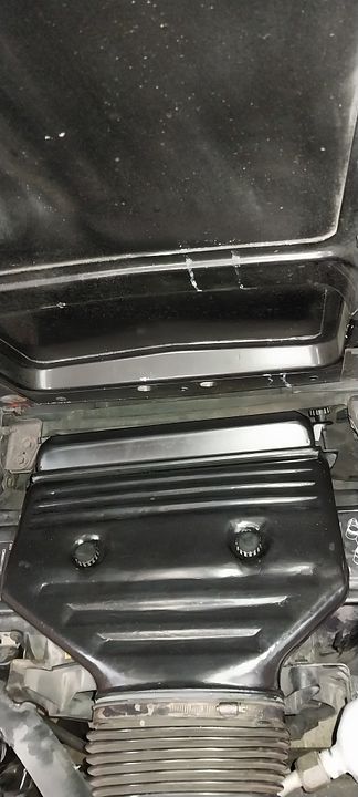

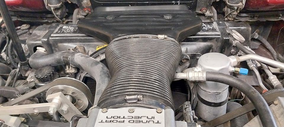

Airbox is done. The function came out as I hoped it would, it fit perfectly. The finish did not come as smooth and blemish free as I had hoped, my fingers did not feel any blemishes but the black paint showed me how much more work needs to be done before they are "perfect". I used the SprayMax Hot Rod Satin Black, and I have no real complaints on the paint, it sprayed perfectly, dried very hard which should help with scratches, but it is more semi-gloss than satin. I installed the airbox for a test after removing the radiator cover to clean the collected debris, and there was more debris in there, mostly leaves and grass. I did not take it back out for pics because my back hurts from bending over so much the past few weeks. I was able to make the joint completely vanish so that is a win to me. I replaced the filter with a Genuine GM A1236CF which is a severe duty filter, I used it because of the dusty environment here. Everything bolted right back into place with no fitment issues at all, I got the repaired tabs in perfect alignment and that is also a win.
I managed to get the alignment pretty close to perfect, there is a slight bend in the center line but you can't see it when looking at it. The box needs to come to the passenger side about 1/8" and I am not going to worry about it, I Frankensteined this together and can't expect perfection.

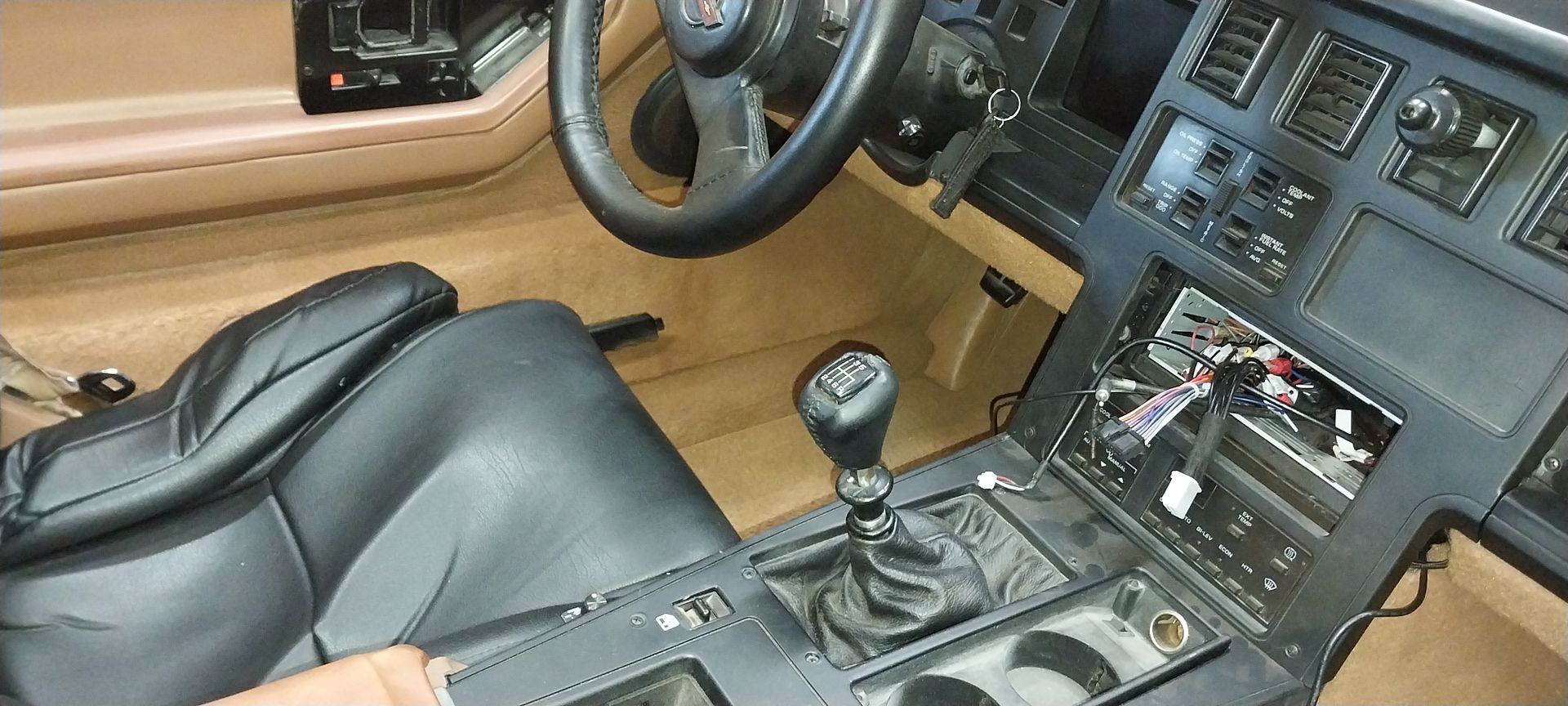

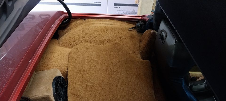

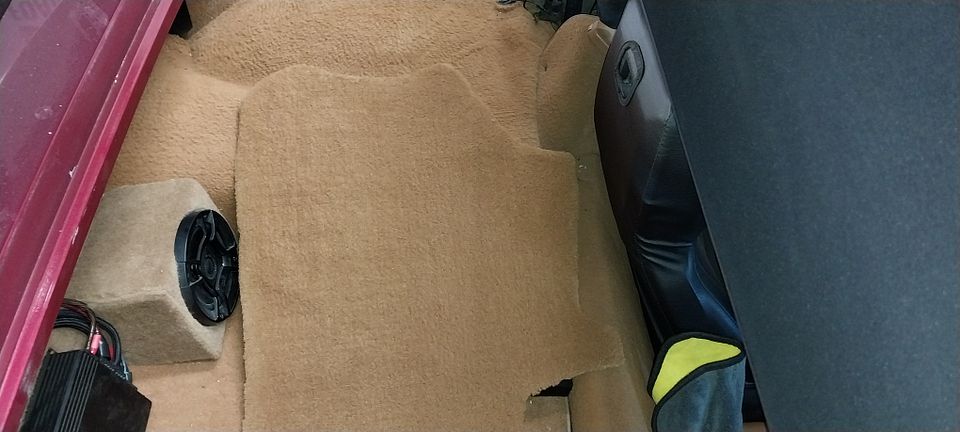

Front carpet is done. The only difficult part of this was the dash trim and seat removal, but I have done it so many times now I think I can do it in my sleep, or heavily medicated. lol
I have learned a lot on how to do the carpet color amending so that it covers the fibers all the way around and not in just one direction. My first venture with the MAMO/SEM product I now consider a failure in some parts of the carpet from trying to make an inconsistent carpet base color uniform. The old carpet was matted down and no longer "fluffy", this is important, it has to be fluffy and a consistent color for all of the pieces if you want a consistent color for the finished product.
Below is what I did and will include the steps in case someone finds this thread in the future while searching for a carpet color correction.
Step one, vacuum the new carpet and old carpet, you really don't want dirt or loose fibers getting coated and buried in the coating.
Step two, use a stiff plastic brush to brush all of the fibers in the same direction, I used a brush designed to clean fragile A/C fins, it had firm but long flexible bristles that did not remove any of the carpet fibers. I did two pieces at a time but you could easily do all of the carpet at the same time.
Step three, once all of the fibers are in the same direction and the can of dye has been shaken enough you will apply a dust coat on the carpet, you do not want to put a heavy coat on as you will have three more coats to put on. Less is more. I waited about three minutes after the dusting and brushed the carpet with the same brush in the same direction as earlier. This helps to keep the fibers separate and prevent clumping of the fibers, the product hasn't cured yet but also was also dry enough to not be removed. I would think temp and humidity would affect how long to wait. It was dry to the touch, if it still tacky then wait until it isn't.
Step four, exactly the same as step three but this time brush all of the fibers in a different direction than you did in step three.
Step four, once it has been coated in all directions and brushed right after applying and completely dry from the steps above, give it a final brushing. The color should be what you after and it should be consistent. I let it cure for about a week but that isn't necessary, I was doing other things and wasn't ready to install it yet.
Once you have all four directions coated it should be a consistent color no matter which direction the fibers are laying. It should also still be relatively soft, not hard or brittle feeling. The new carpet pieces came out better than the existing carpet on the door panels and floor mats, this is because the fibers were easily manipulated in the new carpet and stay where brushed to old carpet would not.
A word on the MAMO/SEM product, you really have to shake it a lot the first time. I put the cans in the Sun for about an hour before using, you also have to shake the can good before every pass, it seems to settle out of suspension easily. If you don't keep shaking it, the thicker base will clog the nozzle, I learned that the hard way.
Before and after pics of the color change.
It came out better than I had hoped it would.

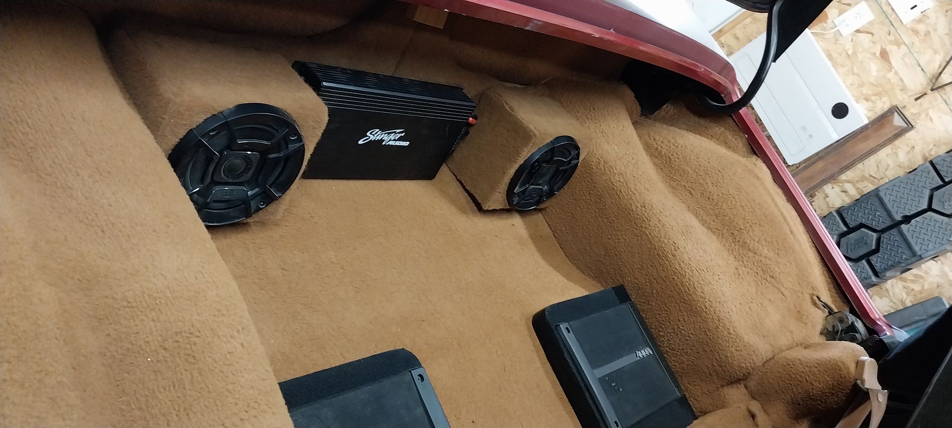

I also did the rear speaker box, it did not come out perfect but it is better. Since I had the box and amp all apart I ran the wires into the chases I created when I built the boxes.
The interior being put back together.
I may order another can of the "dye" and color change the cup holder. The shine, color and texture are wrong and it makes it stand out too much.
All in all it was worth it. It is sad that no one makes this carpet in the right color, it cost as much for the "dye" as it did for the carpet. My original plan was to replace all of the carpet with something else but in the end the best direction to take the car was to just fix the carpet and make it consistent in color. I am happy with how it turned out and now it looks like it belongs. I am not sure what to do next, I considered making the armrest black as it would tie the black seats into the black dash. I am still undecided on that, it will make the armrest hot in the Summer and I don't know if I want to put my arm on a hot armrest purely for aesthetics.

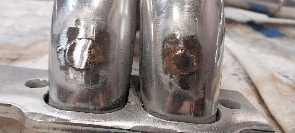

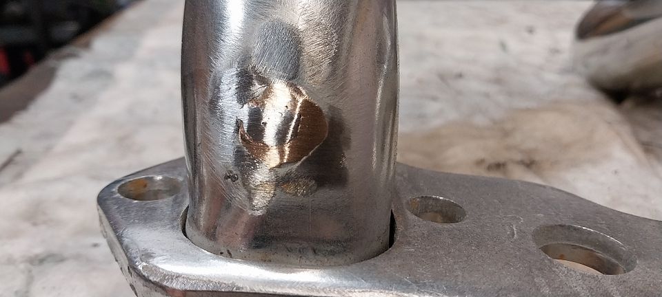

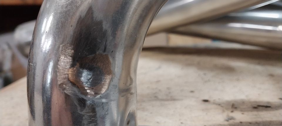

Just a small update, I haven't done much to the car, it has been raining and muddy here for weeks. Since I could not pull the car out of the shop I decided to advance the plan on the header/exhaust install. I have been studying this intensely and thoroughly, every place I can find. I want to give a big thanks to those I have pestered on their exhaust, every bit of information helps. Though I am still studying how to handle from the header collector back, I do have a tentative plan. First, I need to make the headers more appropriate for the car and it's lack of emissions.
Time to make the tubing go away.
The removal was really easy, a simple Dremel cutoff wheel to cut them and a flap wheel on my grinder to smooth out the factory weld. I had a lot more pics but a corrupted SD card made them all vanish.
The little tubes protruded into the header tube, I ground those down as well.
I also cut off the 3-bolt flanges and picked up some Mishimoto 3" V-Band clamps to weld on. I ground down the welds that held the original clamps on instead of cutting the tubes in front of the welds. I am glad I did it this way, the V-Bands would not have fit the 3" collector tube and would have needed to be ground down a little as the tube is slightly larger than the V-Band.
My little Harbor Freight Titanium 125 handled this easier than I expected. I got this little welder for field repair on fencing and anywhere I did not have electricity as both of my generators can handle the electrical needs of this thing. Using Lincoln wire it splatters as you would expect, to combat that as much as possible, I wrapped foil around the pipe only exposing where the weld was needed. It kept most of the splatter off of the pipe and worked beautifully. The 40 grit flap wheel cleaned up the booger welds well enough.
I am not a welder, I am a grinder. My neighbor who is a welder was low/out of shielding gas so I decided to tackle this myself. Though not perfect, it is good enough to be passable for my needs.
I bought 3 cans of Eastwood High Temp Internal Exhaust Coating as I intend on coating the interior of my exhaust as far down the line as I can. I also used this as a coating on the welds and am in the process of curing it with a Mapp gas torch from the inside in hopes of it lasting at least a while.
