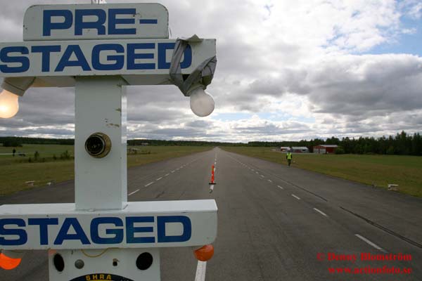

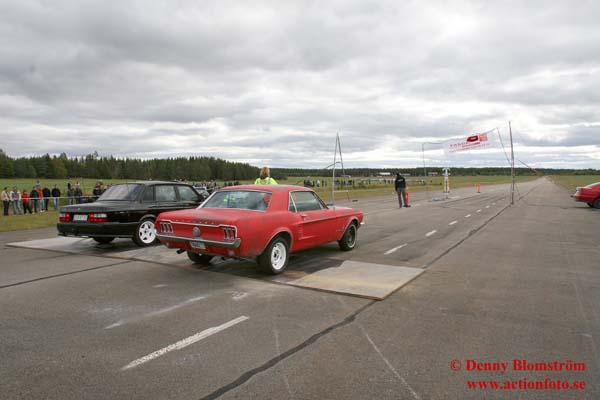

I found some pictures from the event.
http://www.actionfoto.se/

run
But what's with the spectators being so close to the start?
Old 09-10-2007, 02:34 PM
  #33
JoBy
JoBy's Avatar
Member Since: Mar 2001
Location: Timra, Sweden
Posts: 1,972
Received 216 Likes on 168 Posts
Well, this was not a very big event. It was only for street legal cars, most of them daily drivers.
The 'race track' is a part of a public road that used to be a 'secret' military air strip camouflaged as an ordinary road. There were no preparation of the track, just plain tarmac.
There were not much spectators there, most of them knew someone driving. My guess is about a 100 people, and all of them were close to the start. The spectator area started on one side behind the track as you see in the picture. After the starting line there were more than 60" to the spectators and the distance increased.
