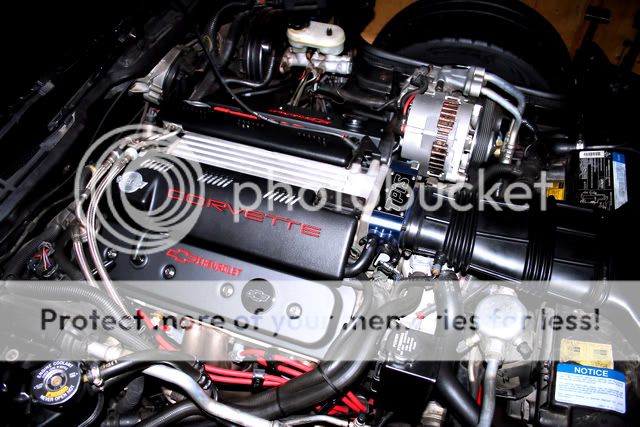

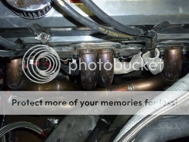

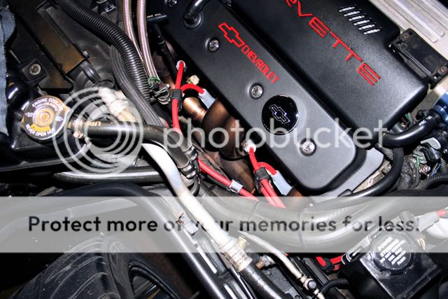

#59
It's been about 8 month's now since I last installed these American Racing Headers and I've put just under 9,200km on them so I thought I'd go ahead and update this thread on how these headers have performed/held up so far, so here goes...
There are NO exhaust leaks to speak of, neither from the header flange's, nor the collectors. Everything still remains as tight as they day I installed them. The headers themselves (visually) do look different compared to when they were new back in December. They've darkened since then and as you can see from the pictures below, now sport a rather cool-looking, bronze-like colour. Of coarse, that's just my opinion, but I like it.
The headers are still 100% rust free. While that may seem like a no-brainer given the fact that they're made of stainless steel, I have in the past, run into issues with so-called "stainless steel" headers which actually started showing signs of rust, especially in/around the welds, so I know that not all grades of stainless are equal and some really do last longer than others. From the looks of things so far, these headers are definitely made from the good stuff.
The xpipe and intermediate pipes (both stainless as well) still look brand spanking new. I'd even go as far as to say they look as if they were installed yesterday and I haven't even so much as wiped them down with a rag. They're spotless and just like the headers, will probably outlast even me.
Plug access, as you can clearly see, is a HUGE improved over the stock manifolds as well as the EM's I used to run. This combined with the deletion of the ASR box, meant my last spark plug and wire change only took me about 20 minutes.
Finally, I was reminded again last night after a drive in a friends C4 with similar mods just how much harder these stepped 1 3/4 -1 7/8" headers and Xpipe pull compared to the old 1 3/4" header/Hpipe set-up.
From 4500rpm and up, my '92 just starts pulling away form my buddies C4 (basically the same mods as mine except he's running 1 5/8" primaries and Hpipe). We used to run neck and neck before my ARH swap....
No other mods have been done to either car since then (none that affect power output anyway) so I know that the gains are strictly from the ARH stepped header/xpipe upgrade.
I've yet to take a decent sound clip of the car (I'll try later this weekend) but I get nothing but compliments on the way it sounds from just about everyone who hears the car. How much of this has to do with the header design/primary size and how much of it has to do with the x pipe and larger intermediate pipes I can't say for sure, but the car sounds incredible at any speed, but especially so, at wide open throttle.
Anyways, just wanted give my final review of these headers. Their looks, fit, finish, ease of installation and performance increase is well worth the price of admission. They're hands down the best headers available for these cars bar none.
I know a lot of people think the aftermarket has abandoned the C4, but the truth is, there are still high-end, top quality parts being made and just as importantly, still being made in the good 'ol US of A.
