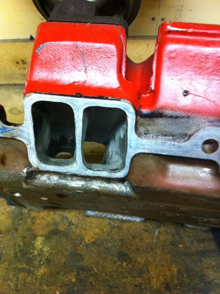

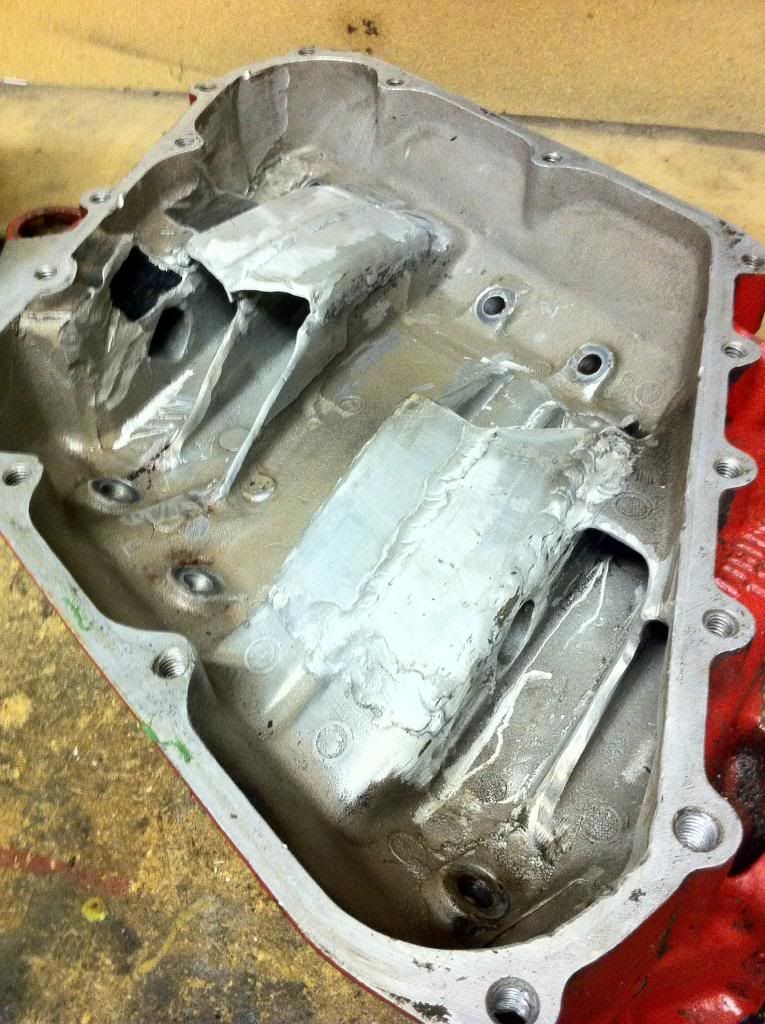

Old Jan 12, 2014 | 04:08 PM
84xfi2.0's Avatar
84xfi2.0
Joined: Oct 2013
Posts: 17
From: Williams Lake BC
Here is a pic of raised runners
Intake port floors where weld was put underneath to give more of a straight shot. Intake must be heated before welding to prevent warping.
