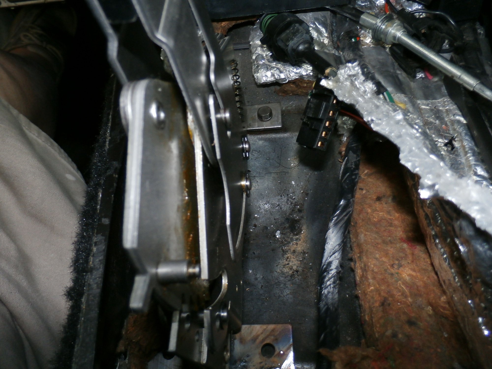

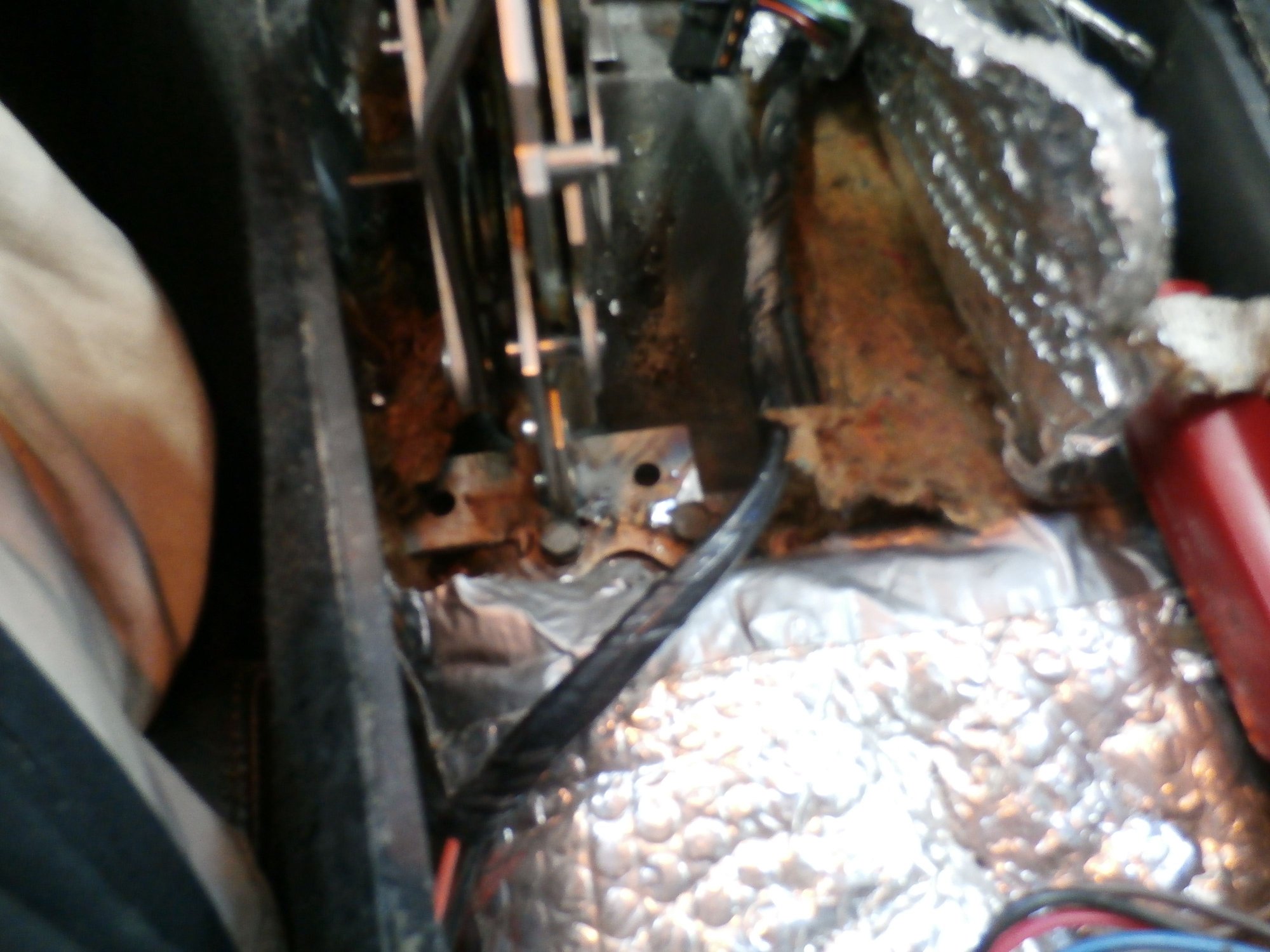

I just finished installing a Megashifter in my '85 so I thought I would post the pics as a help for others who may do the same. Once I got it done I realized I should have mounted the shifter about 1/8 to 1/4 inch further to the right for clearance but I was able to remove a small amount from the console subframe to rectify a tight spot. I also had to remove a small amount from the shifter plate for clearance in the same area. I started by locating the shifter as close to the stock position as I could, I found I could use one of the existing holes in the right front to give me a starting point. I found that I could use the original rear holes also if I added some to the base of the megashifter. I'll cover that in a minute. I did not use the base pieces B&M supplies because it would have added an inch to the height of the shifter. The shifter was made for the Camaro/Firebird console. I saw that if I cut the rear area off the stock shifter where the mounting holes were I could also use the original rear mounting holes & bolts. I marked it off and cut it off then welded it to the megashifter. B&M supplies the relay needed to adapt the stock wiring to the B&M wiring. I routed the wires as shown in the picture. Once this was all done it was just a matter of finishing up the console re-assembly. Take a look at the last picture, see anything wrong? I had to reverse the gear selector plate because the shifter mechanism was contacting the selector and light assembly. I hope this helps someone and if I can give any assistance just ask.

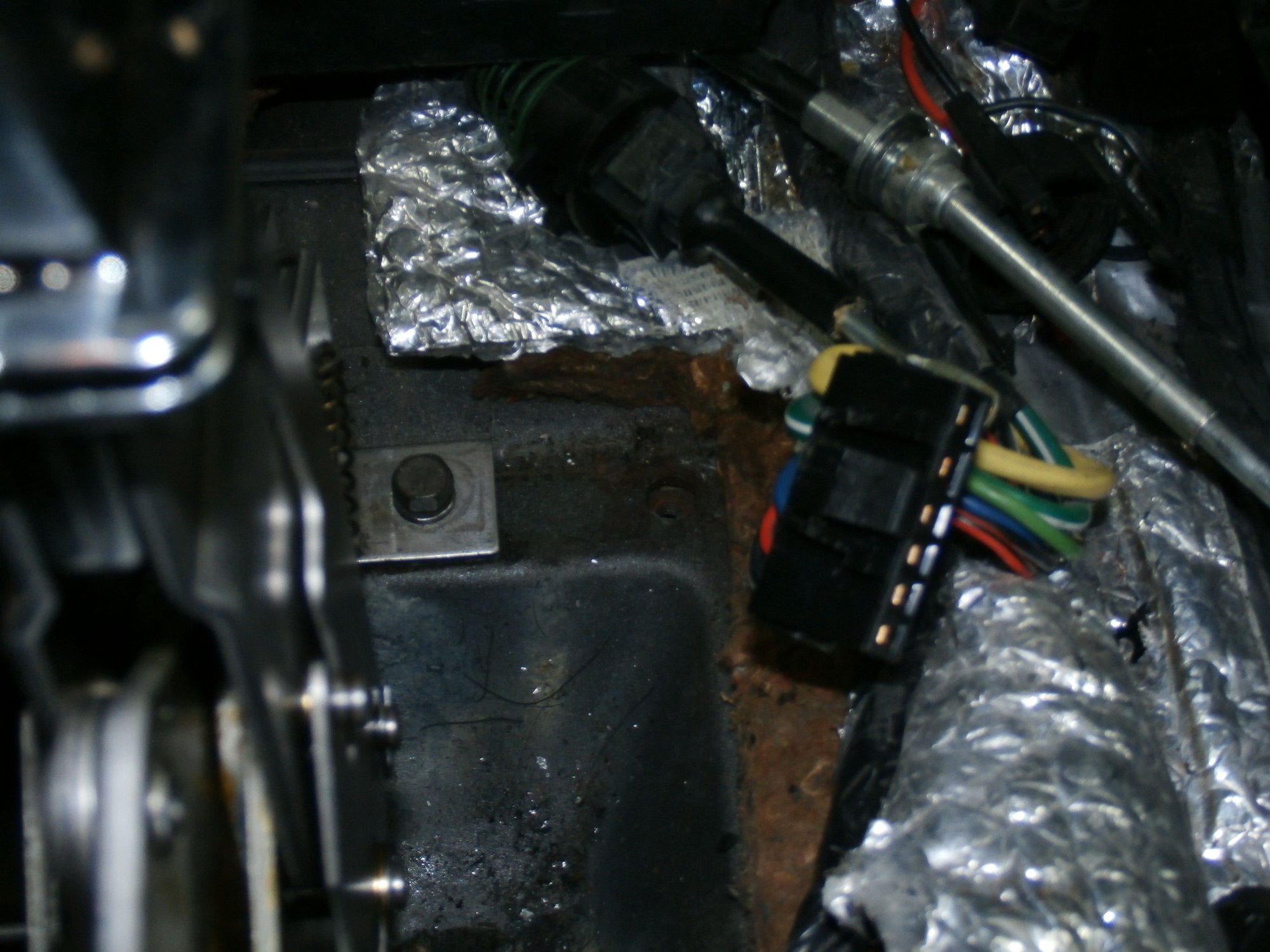

Showing the location of the front bolt hole

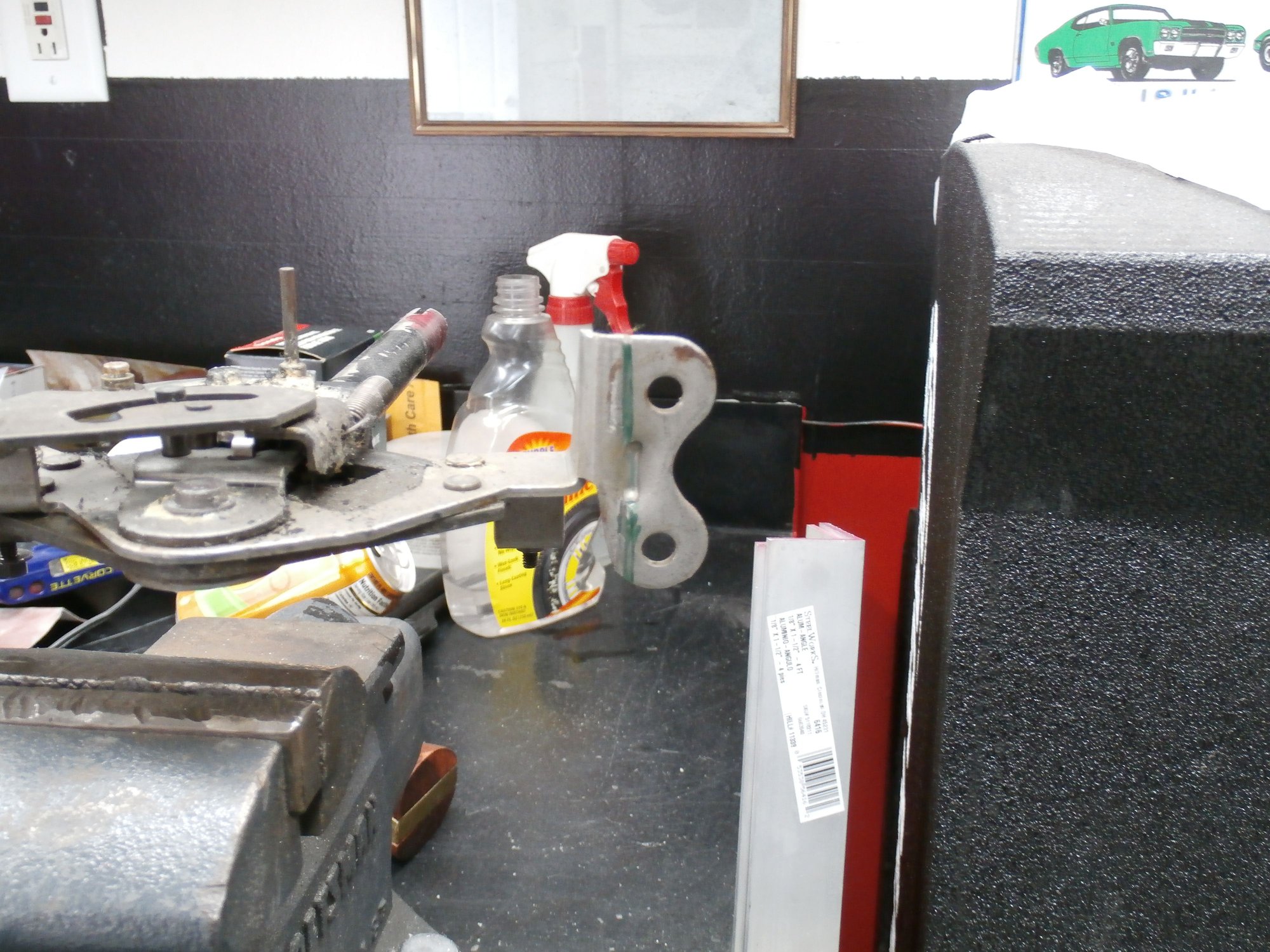

This shows how much too short the B&M was

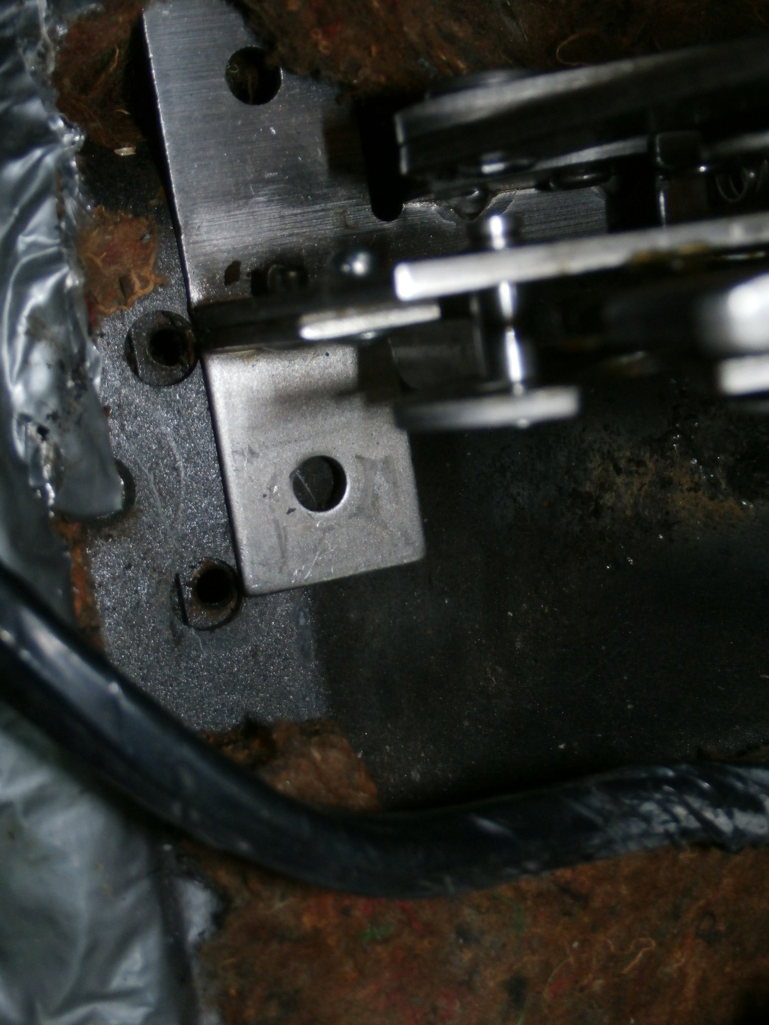

The green line is where I cut the mounting area off the stock shifter.

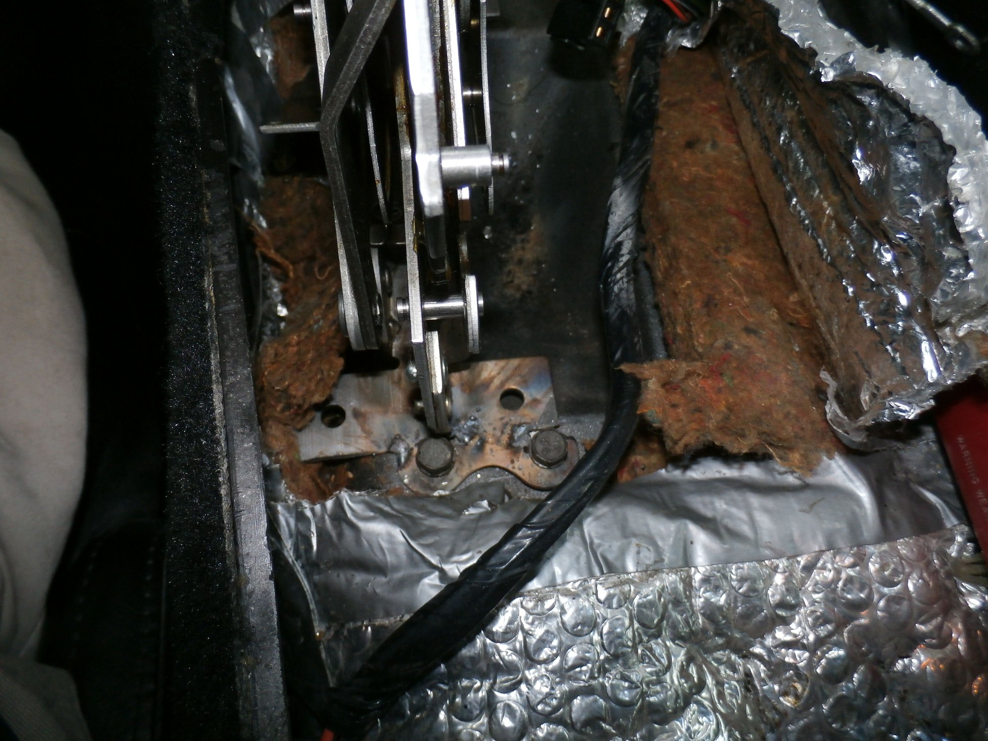

This shows it welded in and bolted down

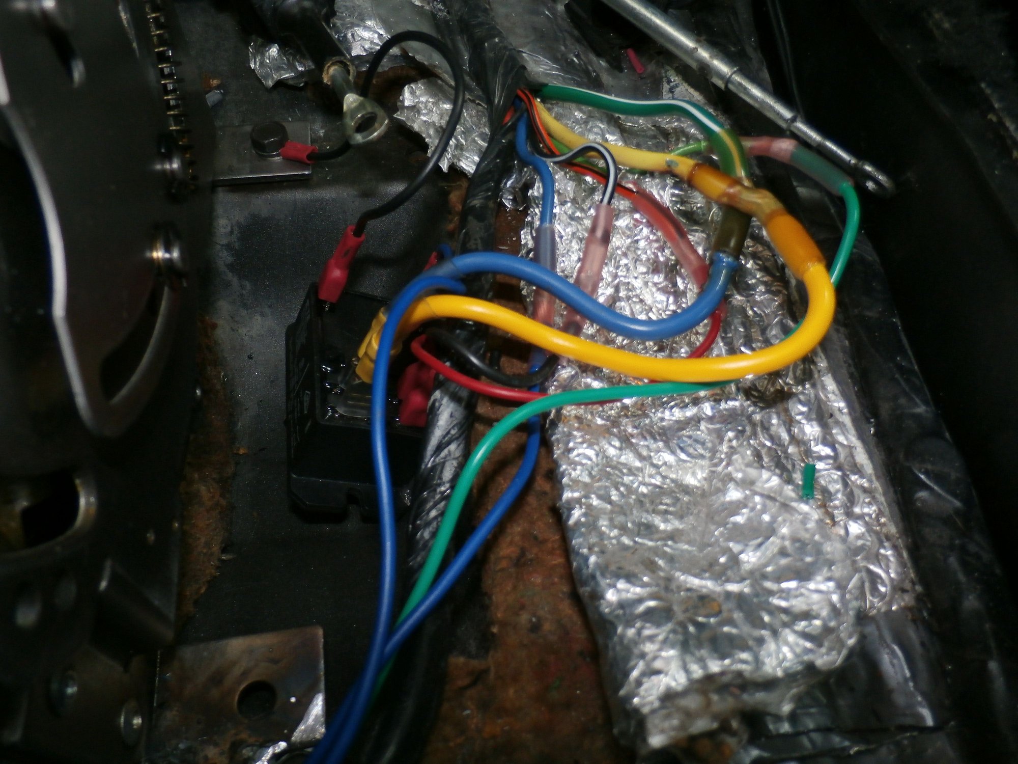

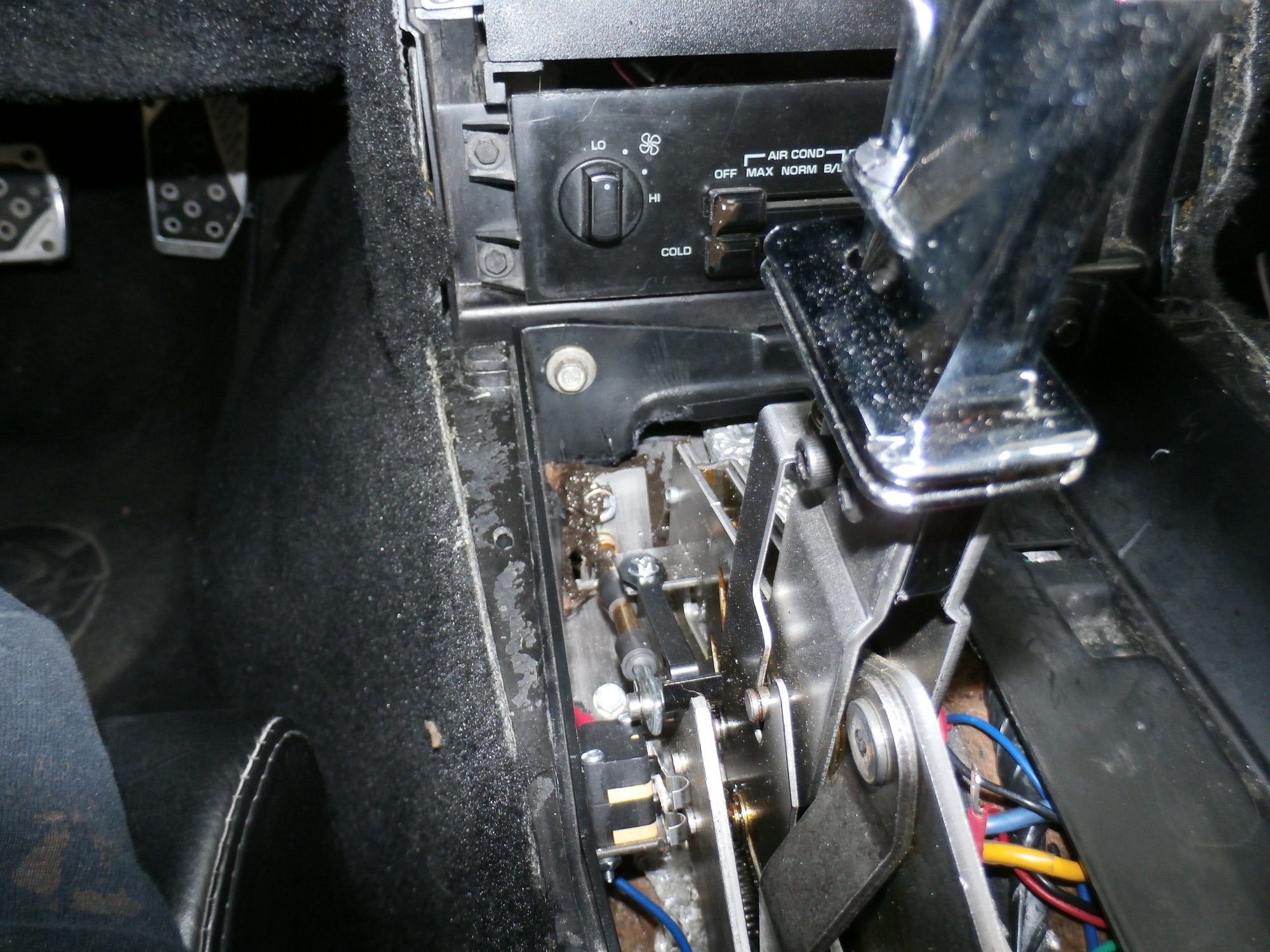

I mounted the relay down in the open area below the shifter and ran the wires from it to the original wiring.

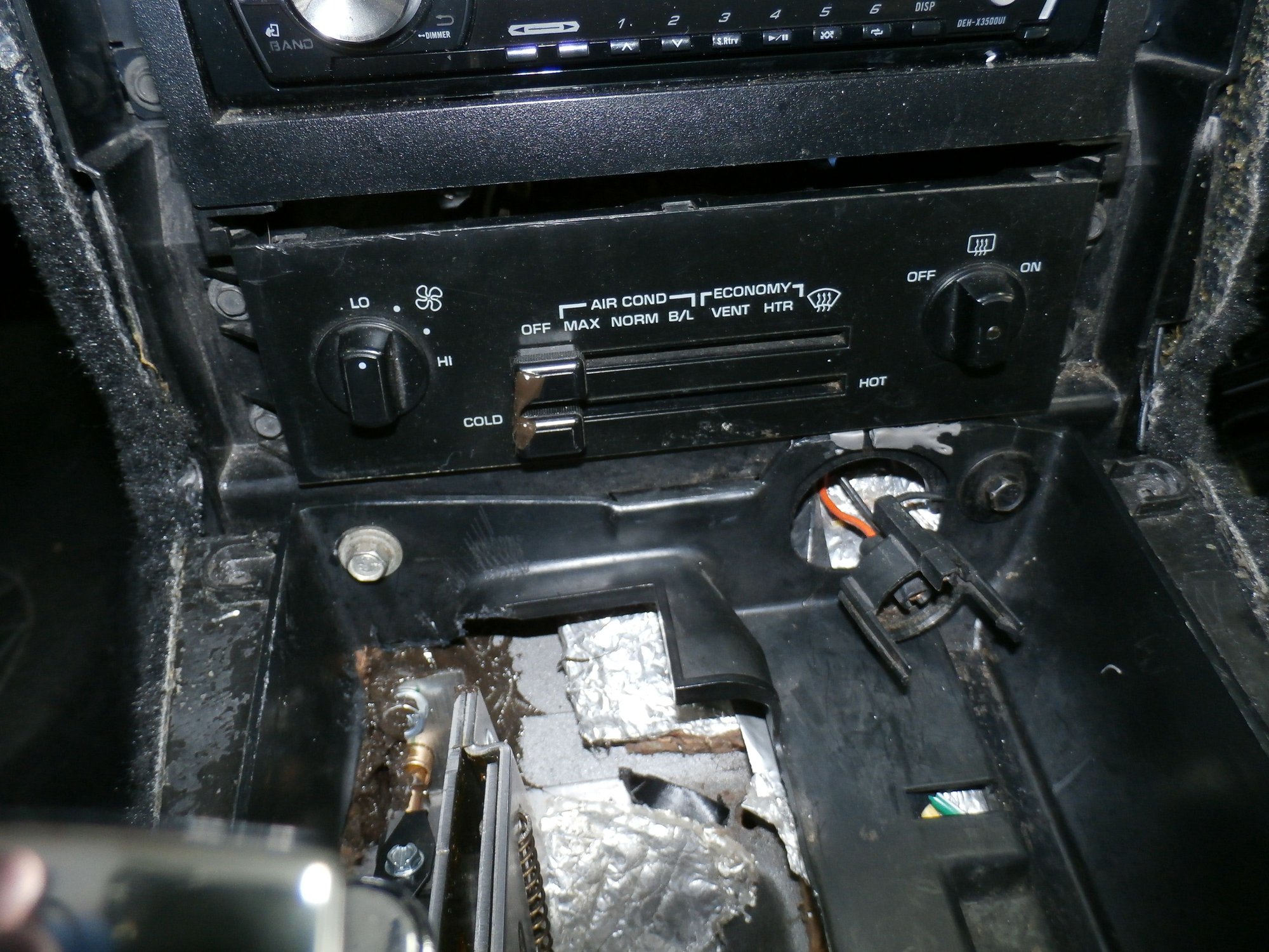

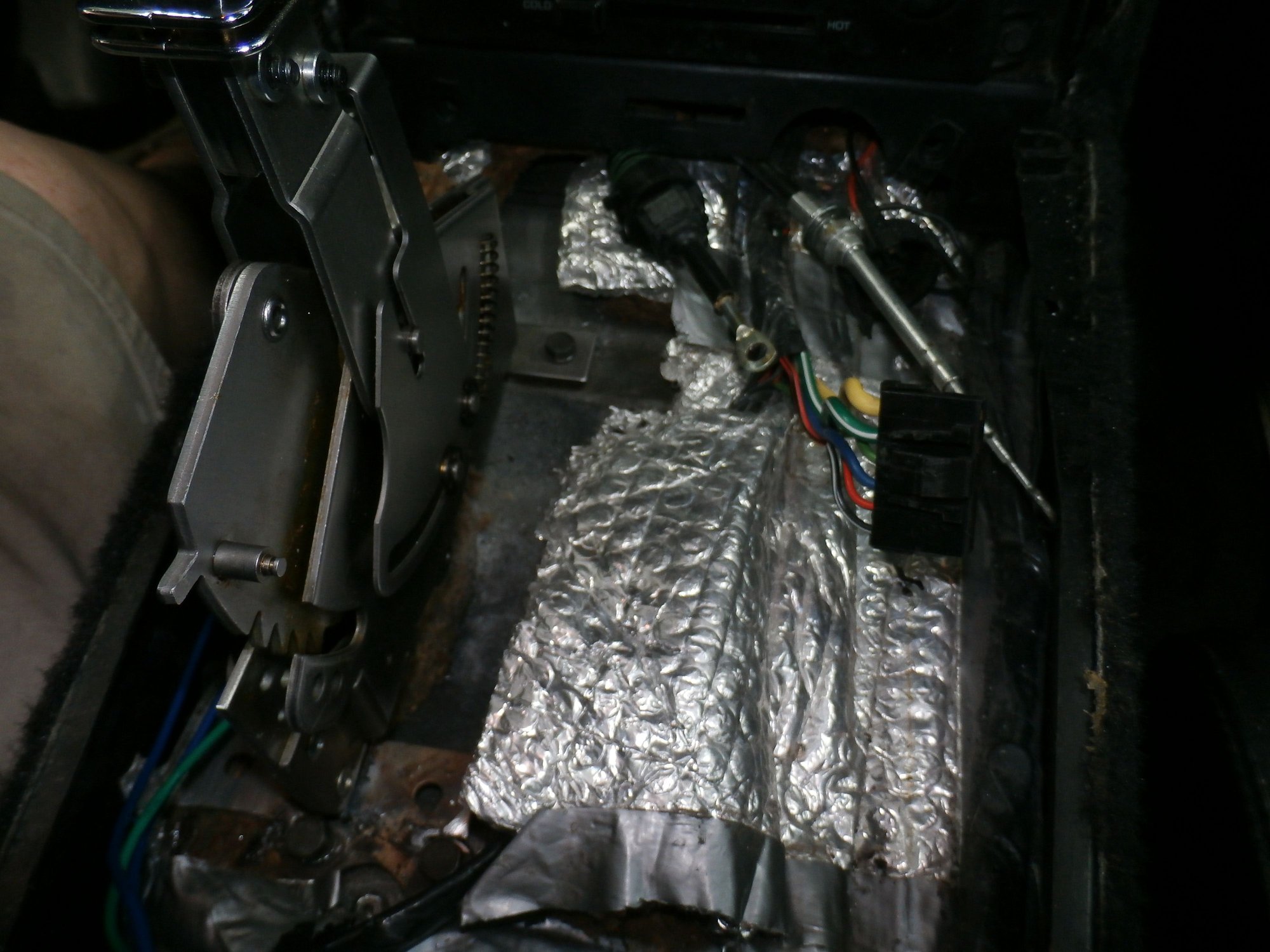

This shows the tight spot on the right side.
I had to trim some off the subframe, you can tell what I removed by looking at your subframe

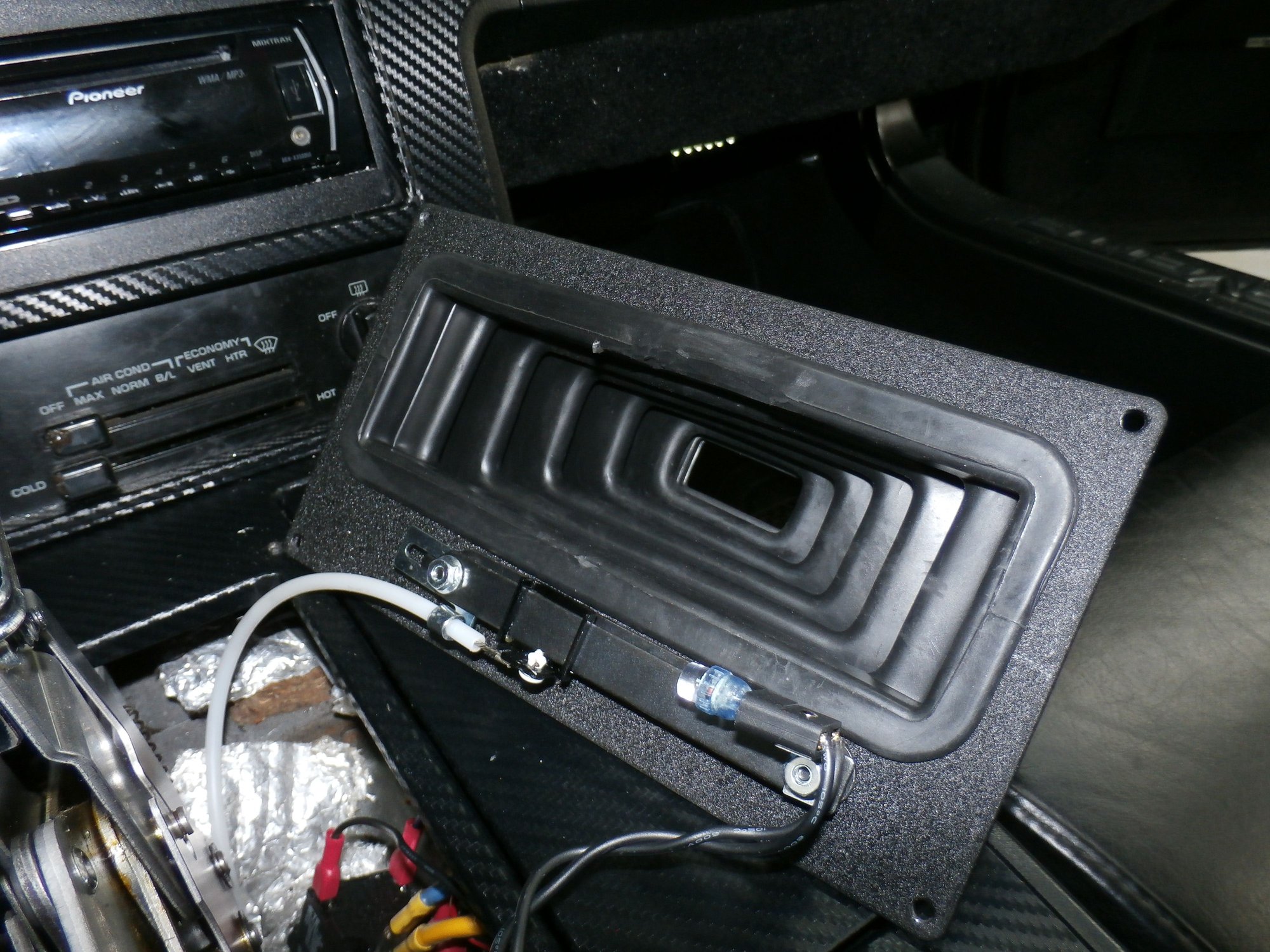

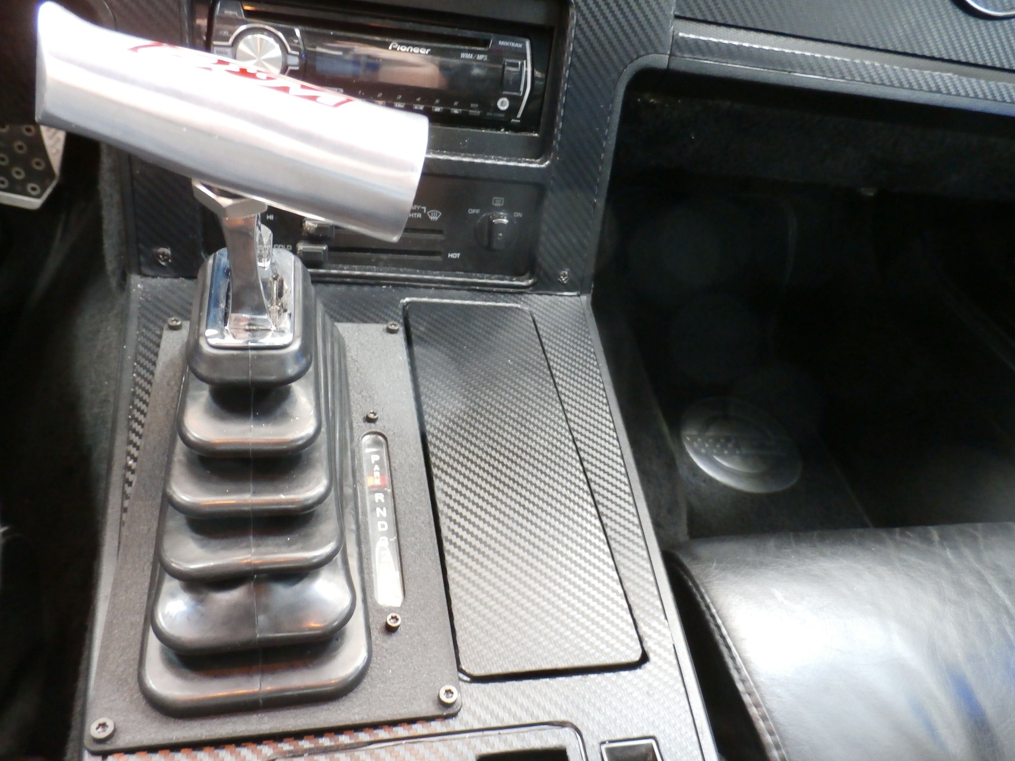

I had to mount the indicator just the ooposite of the way it is supposed to be but I can live with it.

If you position the shifter about 1/4 inch to the right of where mine is you can keep the indicator as it should be. I don't look at the indicator much anyway so I'm leaving well enough alone. It would be too much trouble to move it now.

that shift indicator looks to be on the correct side to me

Since I am going to have the pleasure of replacing the seat switch I am also going to see about getting the indicator back where it should be. I was just wanting to get the install done and I took the easy way out so now I will go back in & see how I can straighten out my problem. I rarely even look at the indicator so it is going to be a considerable amount of work just for cosmetics but it has to be corrected.
