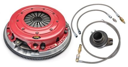

My engine is going back together and I am now starting a search for a clutch that will actually hold the power the car will be making vs the last 2 that just couldnt. I am thinking I will either go MCleod or with the RAM 9.5" twin disk that converts the ZF to a push style clutch system. I have the twin disk ram in my 650 HP z06 and havent had any issues. Im just wondering how its going to do in a C4.
Does anyone have this clutch in their car and if so how do you like it?

Originally Posted by smooth1990
M RAM 9.5" twin disk that converts the ZF to a push style clutch system.
Yes, installed by ZFDoc.
I like it fine! RAM was a bit tardy in getting the steel F/W done, but it all works just fine with the 4+3 master.
I chose the organic twin disc which gives e some headroom on power.
