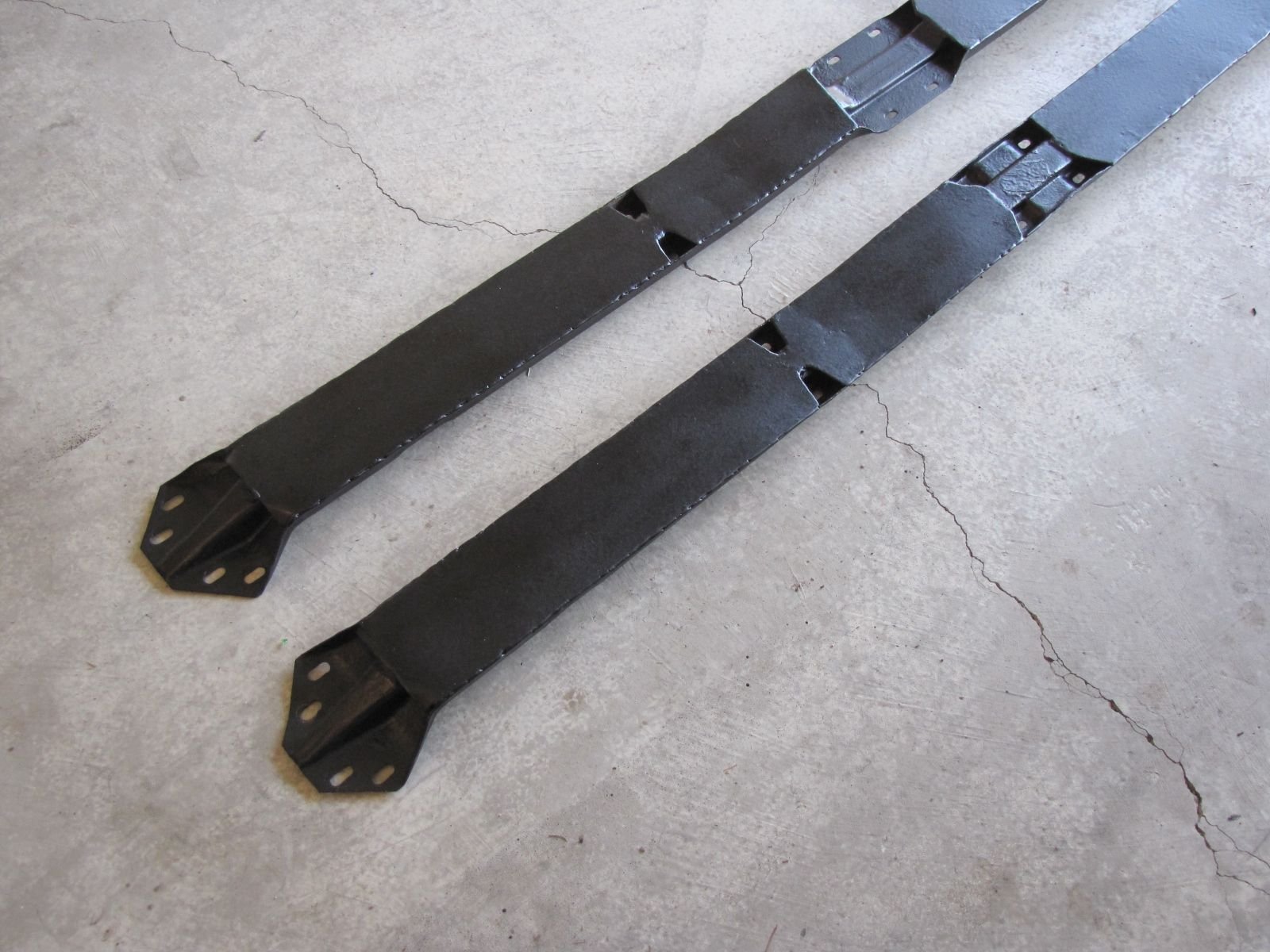

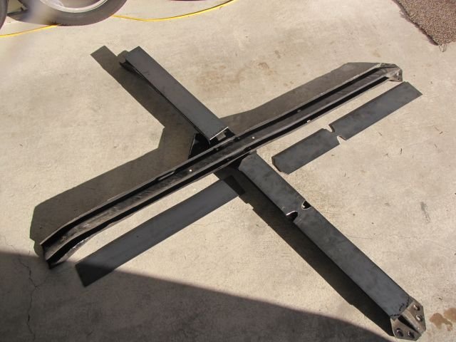

another thing you can do if you have a welder is to box in the X-brace:
To Stabilize Ride
