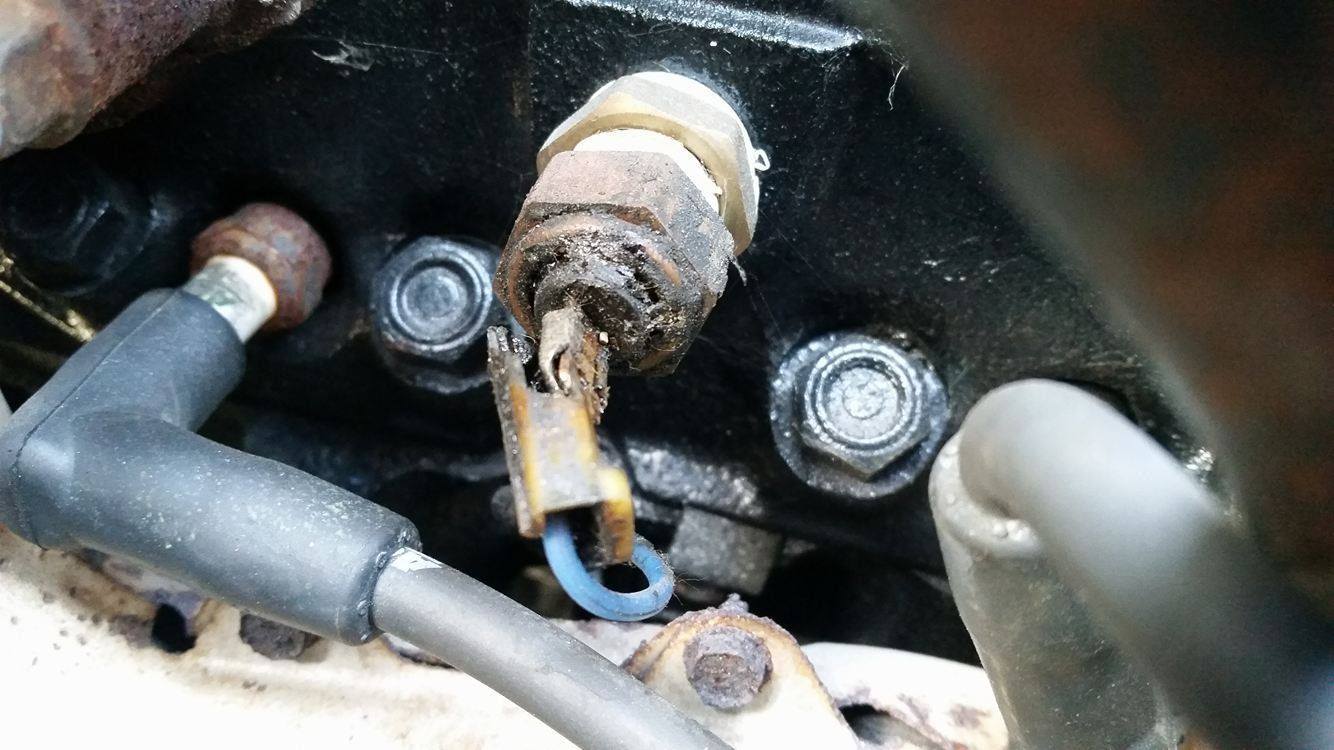

Well now that you mention coolant temperature sensors, it does seem like mine has seen better days.
This seems like an easy fix but at the same time I feel like I still need to inspect the other possible causes as well. I'll order a new sensor for now and see where that gets me.

That is not the CTS. That is the Temperature Sending Unit. The sensor in the picture sends data to the digital dash cluster, not to the ECM. You need to investigate the one for the ECM which is in the front of the intake manifold. You also need to confirm that you are getting an accurate reading with the ECM.
My mistake! I knew there were 2 temp sensors but wasn't sure which one was which. When I get the chance I'll check the other one.
Quick question though. If that sensor was bad would it still give me temps in the gauge or is it a completely different thing to have the gauge tell you the temperature and for the sensor to actually be doing what its supposed to?

The temp sensor in the picture sends the temperature to the dash (nowhere else). The temp sensor on the front of the intake manifold is ONLY used by the ECM.
