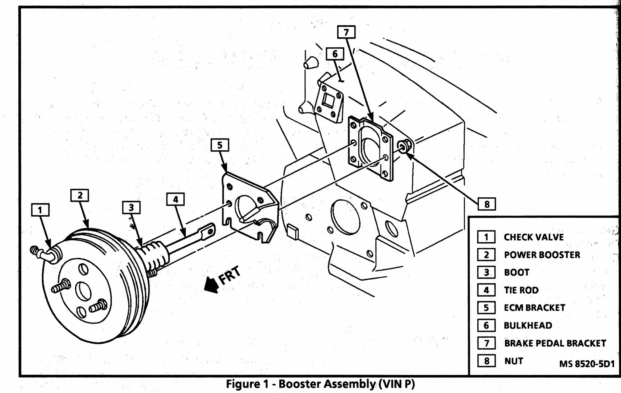

The part you are referring to goes on the firewall side of the booster. That's not what I'm referring to. I have a new one of those that came with the new brake booster.
Here is what I have ... in order:
brake booster unit
Booster output seal -- your seal
ECU bracket
ECU bracket seal -- my seal

Here's the diagram from the service manual.

Job is done ... nice to have brakes again. I think you're right ... the part would have had something applied to it. I decided to buy some heavy-gauge clear vinyl, cut it to fit, and glue it to the ECM braket. I like RTV, but not here. Since these boosters have a bad rap, I don't want to have to remove the RTV the next time I do it.
I also discovered something scary at the brake pedal. I removed the clip that holds the booster rod onto the brake pedal, only to find there was no washer. The previous "mechanic" put a foam washer in there instead. It was a section of pipe foam ... O.M.G. It's now back the way it should be, and I suddenly feel a lot safer.
