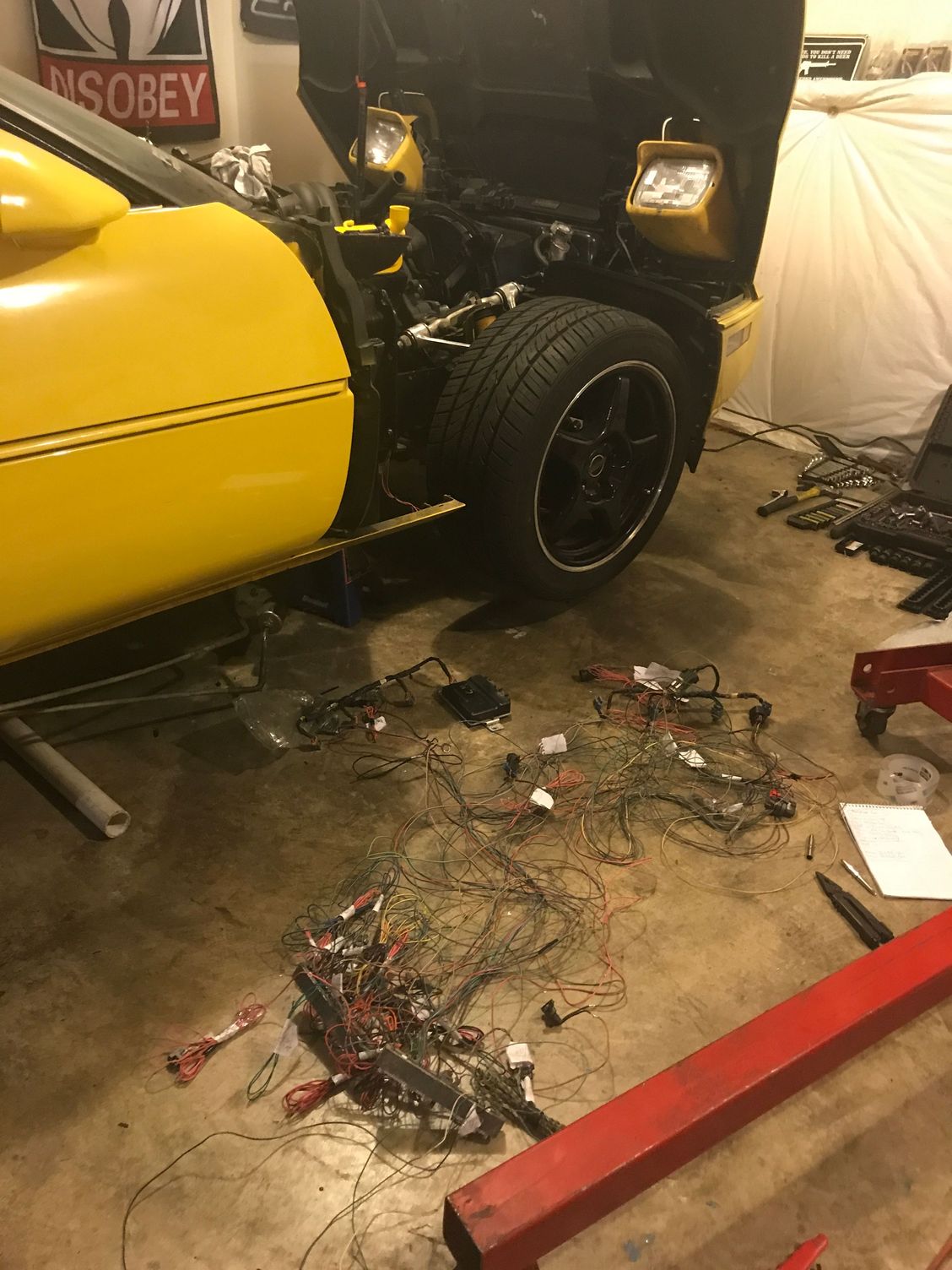

Mega spaghetti on the floor. Gonna be one fast car buddy. I'm probably gonna put some boost to mine at some point.

Wasn't too bad. Still trying to decided where to mount my coils.

Taking advantage of the day off by depinning my sensors from the pcm-mounting them where they will be and then I'll be able to see what needs to be lengthened or shortened and finish up the wiring from there. I've decided to mount my pcm under the passenger side dash.
so is the idea that you will be running two computers in the car? or are you able to re-pin every single thng on the original computer into the new one?

Armybrd, You still have the factory coil brackets?
There is a MSD relocation kit out there but its ugly piece. I just bought Holley valve covers. The stock truck coils will bolt to the holley valve cover.
No I sold the stock computer along with my L98.
yes but I cut the coil mounts off the valve covers since I'm relocating them.
how are you going to keep the overdrive functional?
