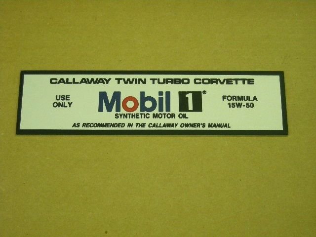

Just to further complicate things.. Taken from Dub's thread, HERE.

Ive been waiting for that pic to come up! Crickets, crickets

What crickets? That is a hand build motor. Is that pic meant to imply that if Callaway recommended 15w50 for their hand built motor that the rest of us should use it in our stock or stockish motors? What am I missing?

you guys don't really see this label as some sort of "carte blanche hall pass" to use 15W50 in your corvette? just askin'....
for some reason, I can't seem to find the phrase "AS RECOMMENDED IN THE CALLAWAY OWNER'S MANUAL" in my owner's manual.
it amazes me, that the manufacturers spend millions and millions yearly on R&D, yet there's always a handful that seem to know better -
No, but I thought it was interesting. They're assuming fair weather and increased heat, I guess?
