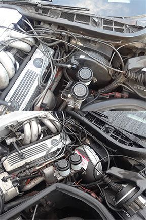

The nightly frustrating update lol. Brake booster is sealed and no longer hissing. Clamped off every vac hose connection, except for FPr (booster, HVAC-Cruise, evap off TB); turned it on and it idled at 6 until I gently revved it and bam, right back to 1500 when coming back down off rev. Went through the entire IAC reset process again, keyed the car back on and it stumbled for about half a second and then I heard the IAC rumble and bam, back to 1500. Removed the IAC and cleaned it up, it was pretty cruddy. Put it back in with the same result post cleaning.
Went through many articles on the forum with members who had a bad IAC that failed with high idles. Low idle and stumble was the inverse. I'm starting to question if the IAC is failing. Before all of this debacle started and I was basically daily driving the car, every so often when neutral coasting up to a light or when sitting at a light, it would sit at 1000 and sometimes settle down to 7. Other times it would hold 1000. I had noticed this was becoming more common. The IAC is the original 1989. Thoughts?

Y'all, I think we have a winner here. Took out the TB and cleaned everything up, installed new IAC and gasket. Even went through and used some nice RTV on the IAC/coolant housing and the gasket on the top of the TB for the CCV "chamber". Went through the entire TPI runner setup and made sure the bolts were tight, all the vac lines are routed properly and have tight fittings, etc. Installed the TB back on this morning and cranked it up, ran nice for like a minute and then went right into the 1500 idle. I pulled the connector for the MAF and it immediately idled perfect. Like so perfect, I couldn't believe how perfect the car idled. It's never idled that good. Settled right down to 7-8 and sounded stronger than it ever has. Plugged it back in and it went right back to 1500. This was a new Bosch unit that is literally a year old two weeks ago. So we can eliminate vacuum leaks since the car idles amazing with MAF disconnected and the IAC and set screw setting seem to be spot on.
I had thrown a code 36 for a while, but when I had the tune built for the car, PCM widened the Voltage table for the burnoff circuit and the 36 went away. MAF would explain many things about how the car has been behaving. Feeling lower on power, some crummy throttle response, the weird high idle issue that was variable, and feeling like the car was running a little lean. Thankfully I have the receipts and the thing is in warranty.
Thoughts?
