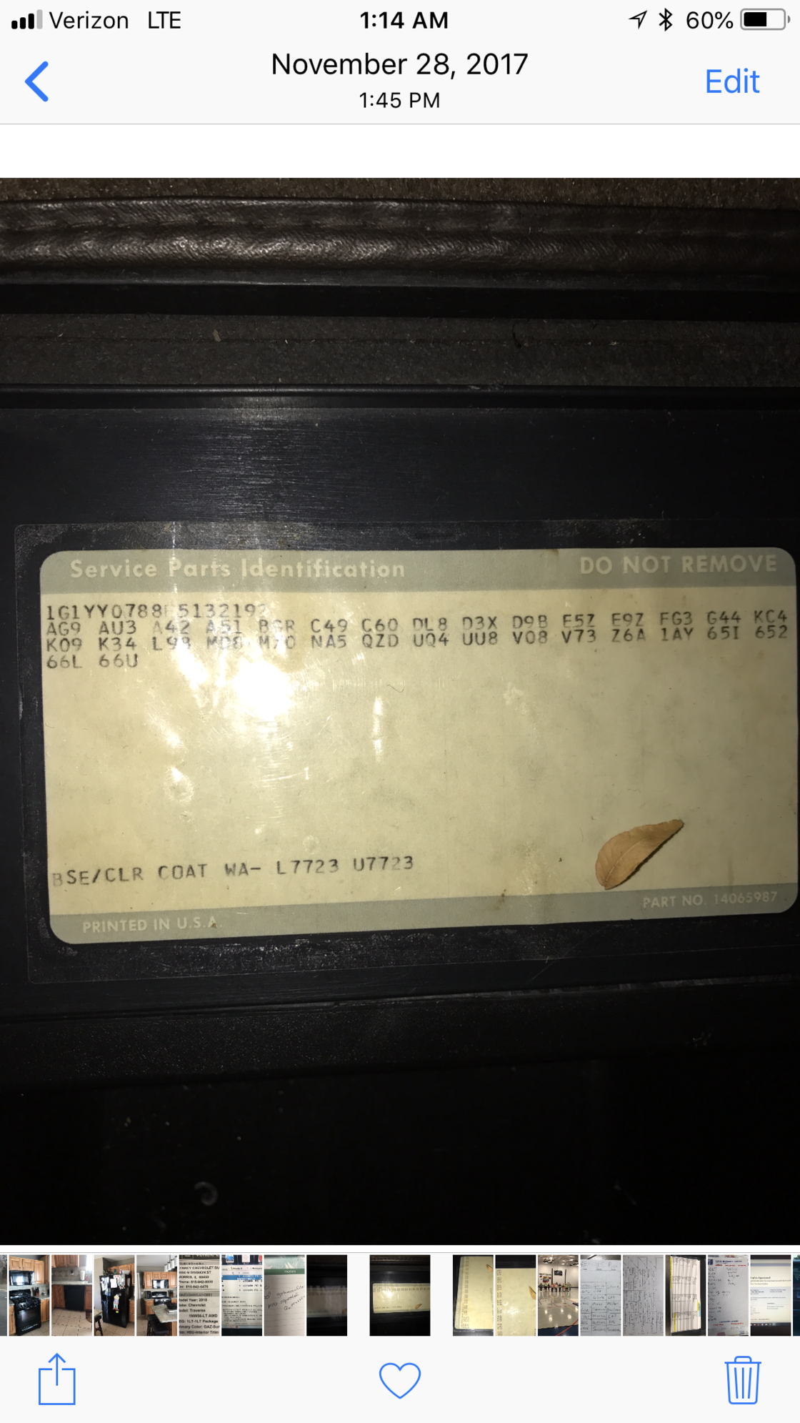

What does this tell me about my car?

Those are all your production codes - essentially what boxes were 'checked' when the car was being made. That let the people assembling the car know what options were to be installed, and let people working on the car know what optional equipment is present.
The chip with have a code on it, that's the numbers the other guy referenced. That chip is mounted to the ECM, which is under the passenger side kick panel/dash area.
Edit: assuming your rear-end is stock, code G44 indicates that you have a 3.07 rear axle ratio, MD8 means its a 700r4 trans.
