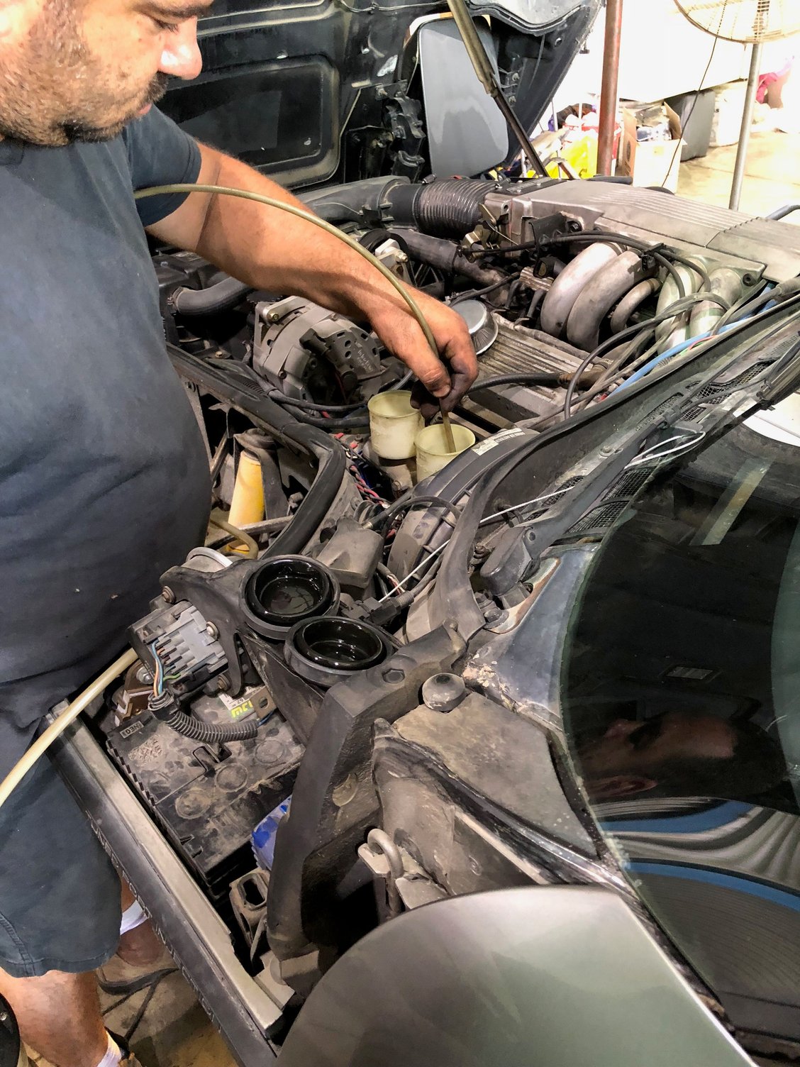

Default After installing Wilwood on my 1985 Vette
The kit is bolt on. With CCW 17" classic rims, there lots of clearance. Haven't got the chance to do a full bedding like mention here:
http://www.wilwood.com/Pdf/Misc/Pad_...ding_Steps.pdf
Thank for your support.
