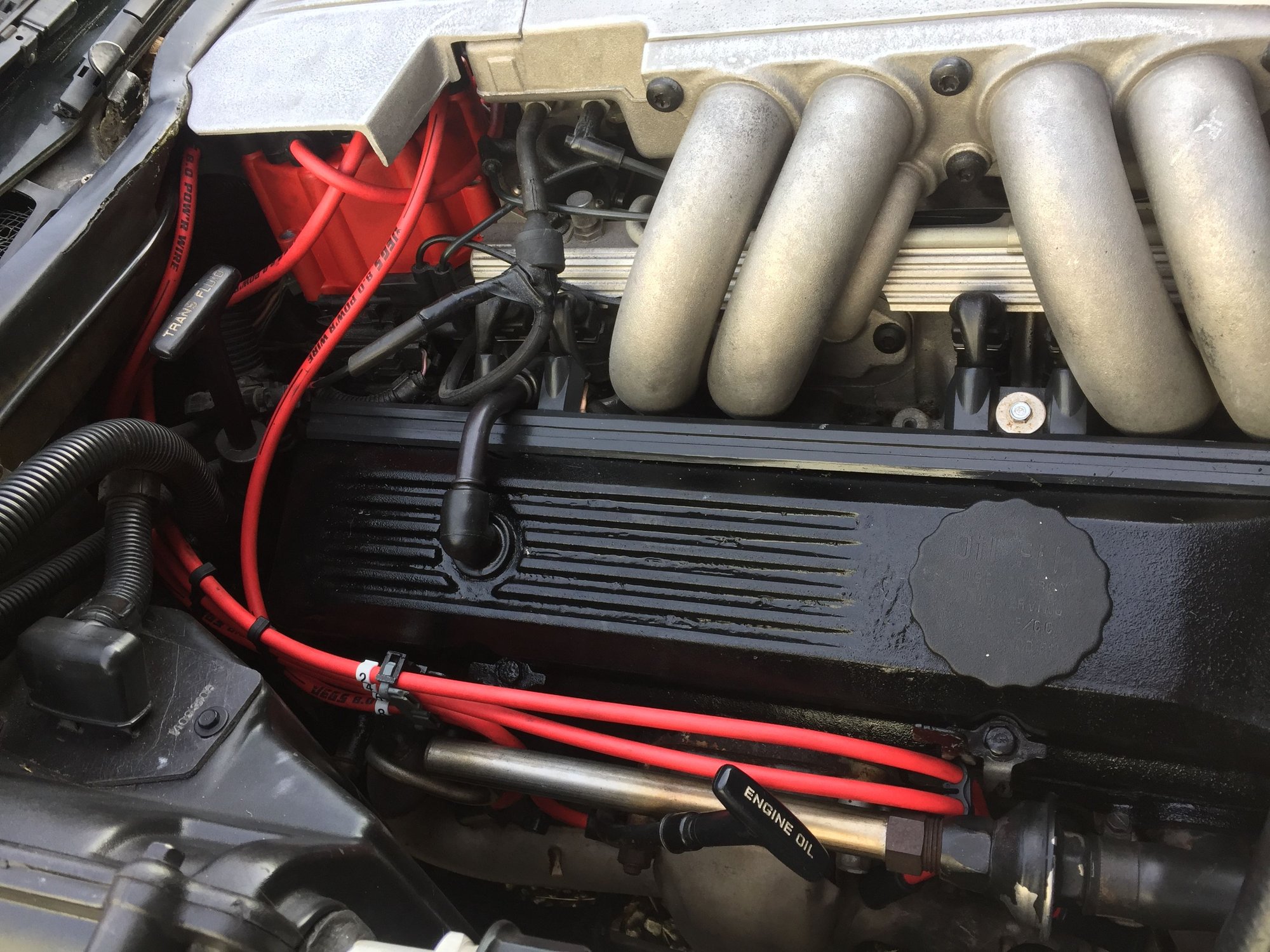

I want to say thank you to all of you who help me decide what to do for the tune up. It has made the car a lot better I can tell. I just got the msd cap on by cutting the clamp screws and using the springs as washers with a machine screw in each of them. We got the cap and rotor, plugs, plug wires, and fuel filter all done today. I didn’t even think this would help it but my corvette has always had long starting like 5 full seconds sometimes and I just thought that’s how it is since it’s 30 some years old but after this it starts right up like a regular car. I take it that it was the fuel filter because when we got that off a lot of brown liquid came out and when it started hard it would help a little if you would touch the gas pedal some. Now I have tried it 4 times and it has fired right up every time. Thanks for the help. I’ll have to post some pictures of how it looks now because it looks good with the red cap and red jegs wires and I think I got them routed pretty good too.

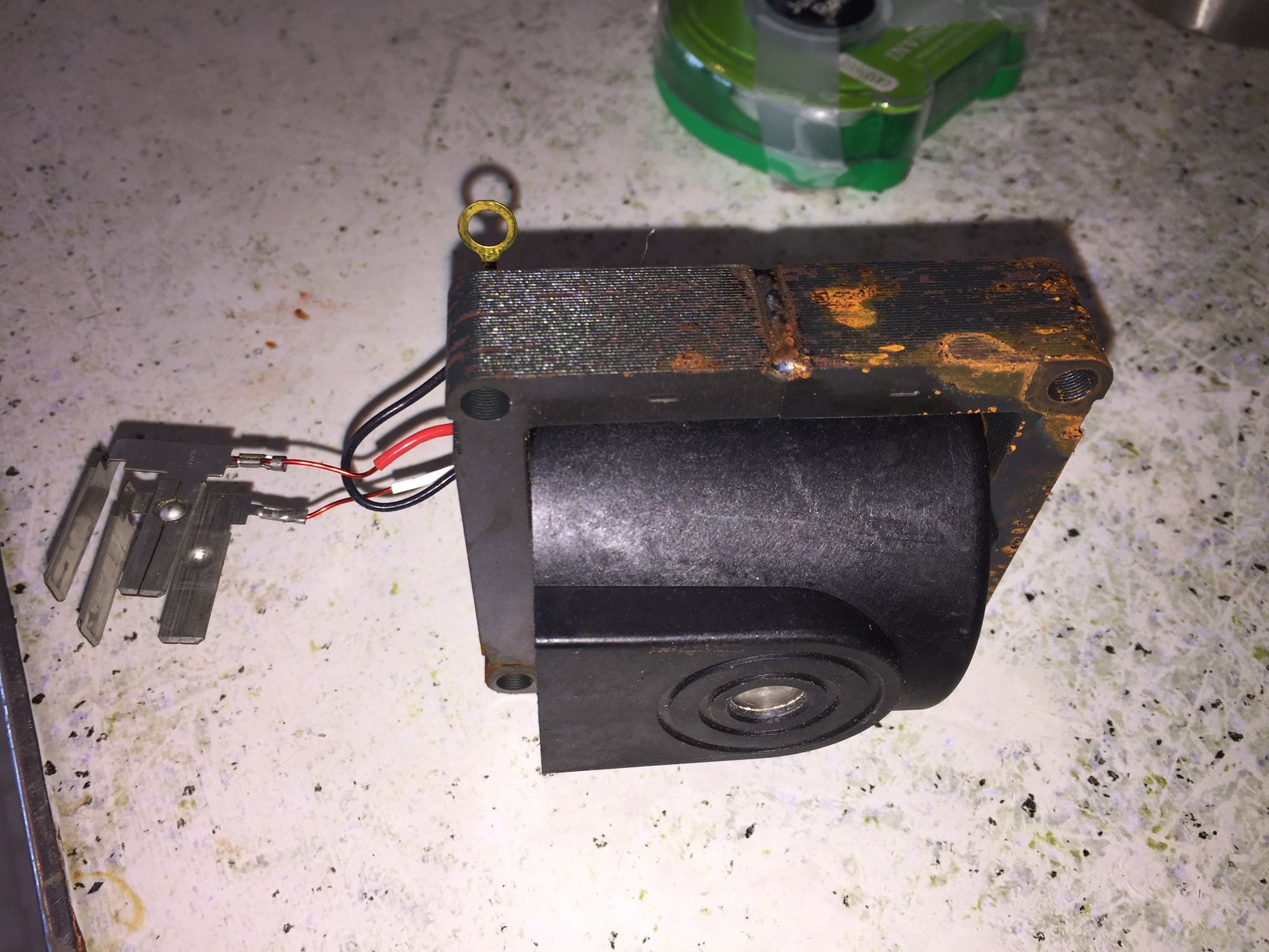

Here’s some pictures of the coil and distributor. I was going to show them to make sure they look alright because I’m not sure how they’re supposed to look and saw they had some brown rust spots but I take it they are in good shape now since something fixed the problem of the long starting.
Now the engine bay looks better. It needs valve covers sometime like the proform chrome with Chevrolet writing on top of them sometime. I used sandpaper to polish up the top of the plenum and I need to polish the runners too but they seem so hard to get to.
