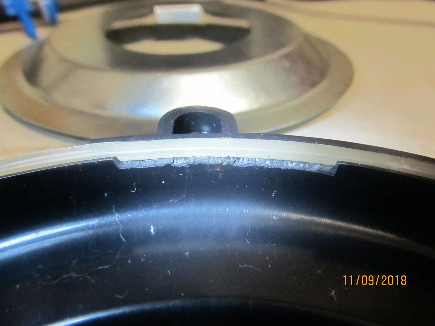

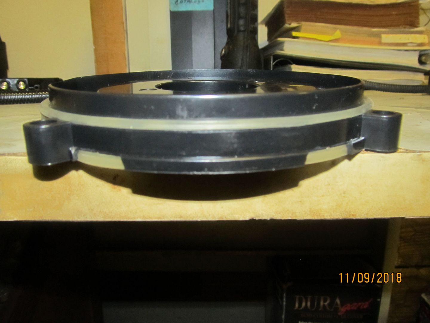

I replaced my GM (Delphi) Optispark that failed due to a bad optical sensor module. I lost both the high and low resolution signals. This was 13 years old with 7000 miles on it. I suspect the early failure could have been related to a vent hose assembly that had a clogged filter and a check valve that was no longer checking.
I took a chance with an AIP Electronics Optispark. After installing it, the engine ran fine for 50 miles then developed a miss fire. Cylinder 4 was not getting voltage right at the distributor. I took off the cap and inspected the high voltage components and found that the plastic insulating cover had a damaged area right by the cylinder 4 output. [COLOR=left=#717583][/COLOR]=left

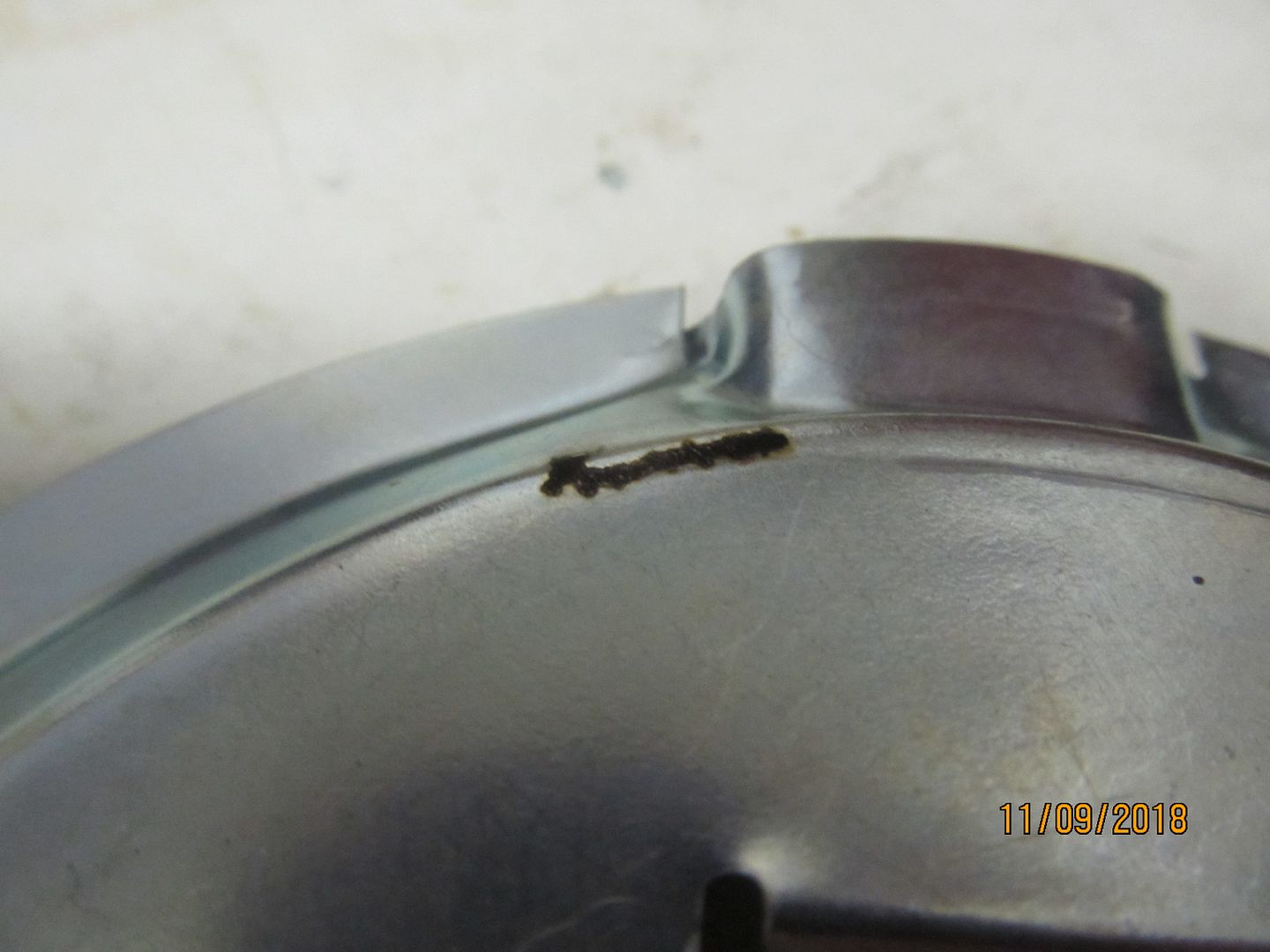

The voltage arced through the plastic and into the metal shield.[COLOR=left=#717583][/COLOR]=left
I also noticed that the plastic used in the insulating cover appeared to be brittle and had hairline cracks throughout. The voltage arced through one of the cracks. Apparently the crack was compromising the insulating ability of this cover. Some other damage can be seen here.[COLOR=left=#717583][/COLOR]=left[COLOR=left=#717583]
[/COLOR]=left
So what I did was to take the high voltage parts, cap, rotor, plastic insulator and metal shield from my old GM Optispark and swapped those parts into the AIP Optispark. Hopefully the optical sensor module will last! I also installed a new vent hose filter and check valve.
Some after market manufacturer really needs to step up to the plate and offer a reliable Optispark. All of the new replacements reportedly have quality and reliability issues. If they can accomplish this then they will be the go-to for new Optisparks. Right now you take a chance with a new one so the only other choice is with used or refurbished GM.
