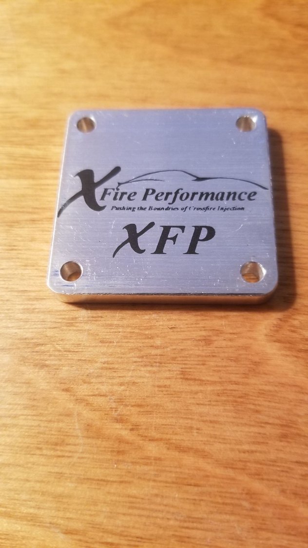

Also, Today I was playing around with the laser and decided to do some TB blank off plates that are aluminum for an external FPR system and this is the results. What do you think? I like them...
I must have been typing at the same time as you. LOL.
Blanking plates look good.

Thanks Greg. I was thinking that if someone wanted it to say... 1984 CFI maybe above that, I guess I could do that as well. Just need to do the vector art for that, 82 as well I guess.

I like the block off plate, but before making a bunch of them, I'd correct the spelling of, "boundries" to "boundaries".
Oops! Yep, just saw that as well. I can't believe I didn't catch that...
