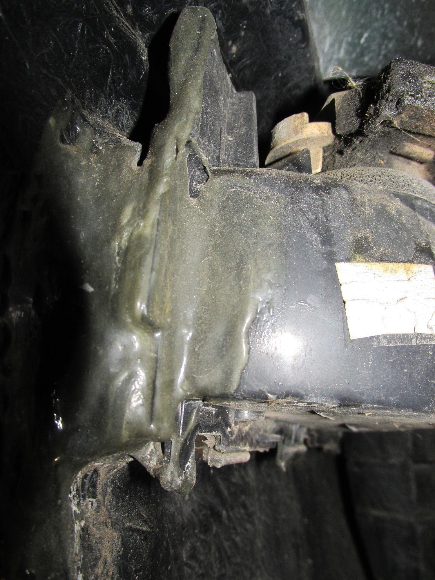

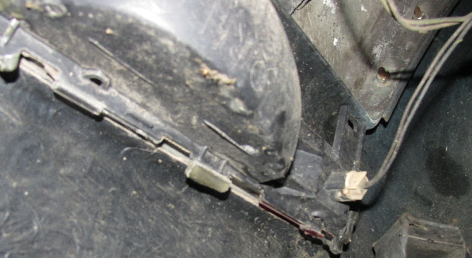

Here's a picture of the good side. Tough place to take a picture. Notice the arm with the hole in it. There is just one arm and not being used. Other photo shows what is holding the fixture.
adhesive holding fixture in
Screw tab not being used. Only one tab and nothing to screw into.

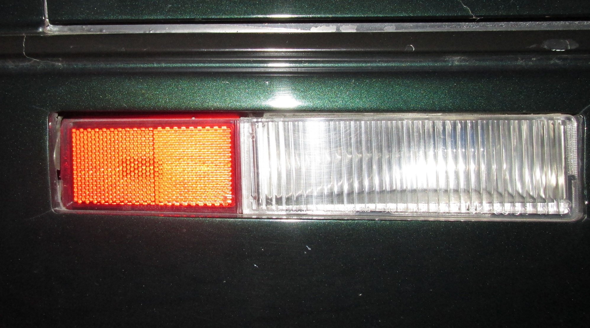

Here is a picture of the outside. Not flush. Looks like possibly
wrong lens used
Old Jun 3, 2020 | 11:01 PM
jv9999's Avatar
jv9999
Joined: Jan 2014
Posts: 2,184
Likes: 381
From: Lunenburg MA
I would guess that it has been in an accident and repaired improperly. Your good side pic shows a lot of resin that shouldn't be there.

Old Jun 4, 2020 | 12:20 AM
ChumpVette's Avatar
ChumpVette
Joined: Jun 2010
Posts: 4,564
Likes: 1,676
Originally Posted by murph350
No, no accident. Car is local and I know the history.
Not the original bumper
The only explanation is it was done in the factory that way for some reason. Not the only time.
Not ever on the worst day of the C4 production line, would that have been an acceptable installation and sent down the line.
Old Jun 4, 2020 | 02:06 AM
VikingTrad3r's Avatar
VikingTrad3r
Oil Producer
Joined: Apr 2014
Posts: 9,365
Likes: 2,735
that is not a factory install.

Original bumper would be a yellowish color on the inside as it is urethane.This is black and without a high quality photo, but it looks like a fiberglass replacement. The inside of the bumper is also not showing recessed area where the black belt line molding is attached with studs coming through with nuts to secure it. The 84-90 used that style to secure the reflector.
The 91+ cars had an additional bracket that was pop riveted to the bumper and had two mounts for the reflector to be mounted with screws at the top.
It may not have been an accident, but could be a replacement "ZR-1" style to get the 4 rectangle lights instead of the 4 round ones.

Thats a fiberglass bumper. I just installed my front and rears. You can see some pics on my posts.
You have to fabricate a way on all 4 markers to hold them in place. Looks like someone used hull adhesive to goop them in instead of making brackets. If you look at the inside of the bumper, in the middle towards the ground, you will probably see the mold tag telling you who made it. But that dosent matter.
If the bumper is installed (obviously it is) only good way would be to make the brackets out of the car, then bond them into place. Only good way to do it at this point.
