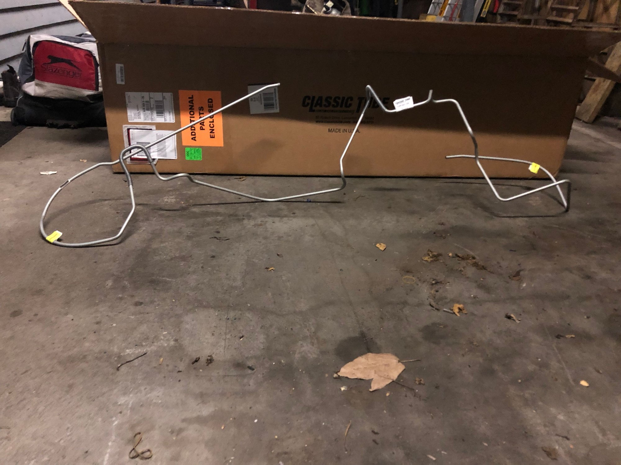

Yeah I learnt my lesson too. When I originally looked them up Ecklers had them too so I don’t know what’s going on there. Sometimes I find stuff from Ecklers doesn’t appear when you list by year model. They are actually made by a company in the US called Classic Tube so maybe you can buy them directly from them.
Edit: Here is their website
https://classictube.com/

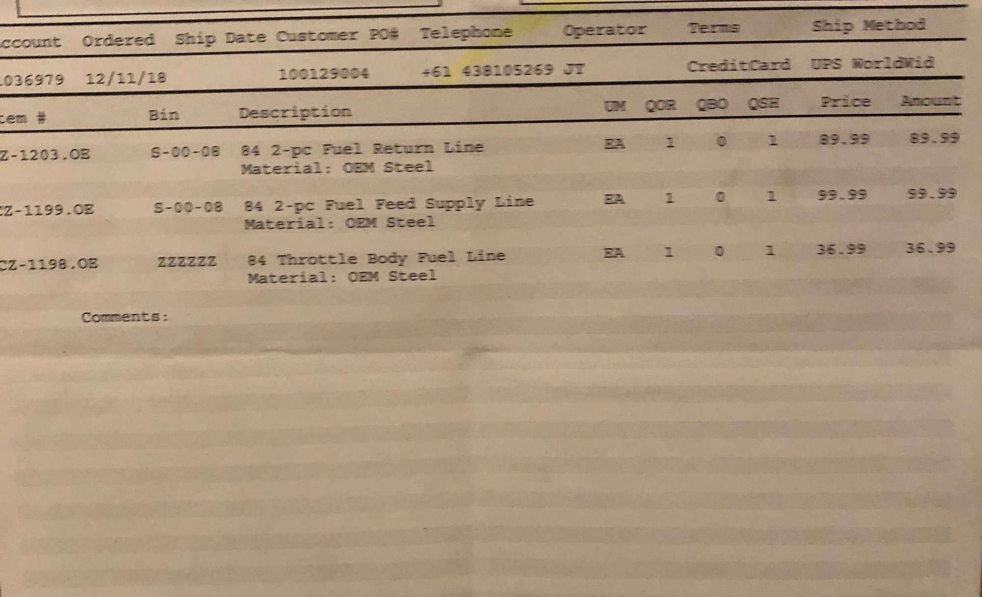

Also here is my packing slip from Zip maybe the part numbers will be the same
