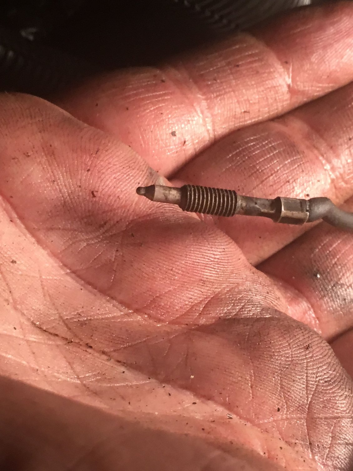

On a side note, I know I have power running to the starter (don't ask me how I can confirm that... it was quite the fire works show).

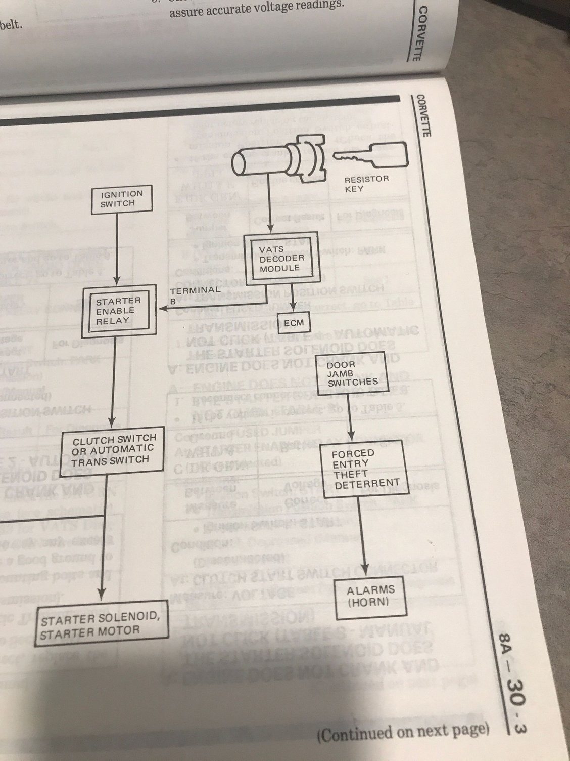

Just an update and some additional info, not sure if it will help.
File Type: pdf
File Type: pdf

Code 12 means that there is no pulse from the distributor pick up coil, which you don't b/c the engine isn't rotating.
You can bypass the start enable relay to crank the engine w/the starter, but that won't get you running, b/c the FEDS portion lf the VATS still won't allow the injectors to fire, I don't believe. So...that won't get you much.
Do you know that VATS is the issue? I THINK your security light is functioning correctly, which makes me wonder about the p/n/clutch safety switch or ignition switch.

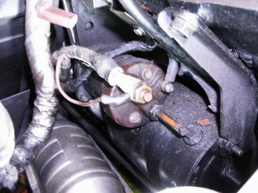

Not sure what you did to get your spark shower. The larger of 2 connection goes directly to your battery and will always show voltage unless there's some break in the wire. Current flows when you turn the ignition switch that goes through a starter relay that VATS plays a part in closing it and continues on to the smaller wire connection. As someone has stated twice in this thread, you need to check voltage in this circuit.

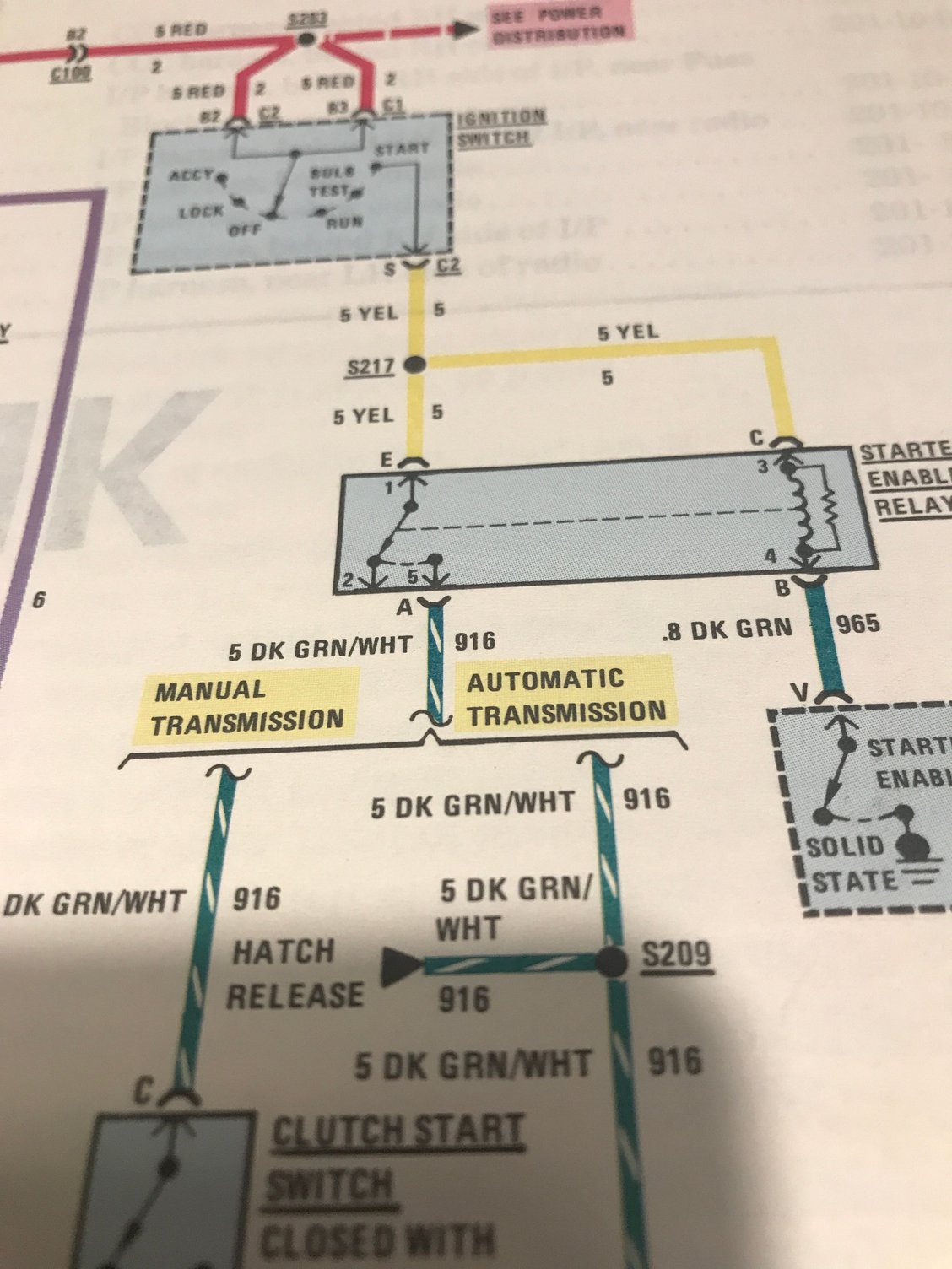

helms manual shows power comes tight off yhe ignition switch.
pulled the seat and got to the switch.
the plug was clipped on by only one catch.
pushed it down, and started without any jumpers.
so in your case, i would check power to starter in start

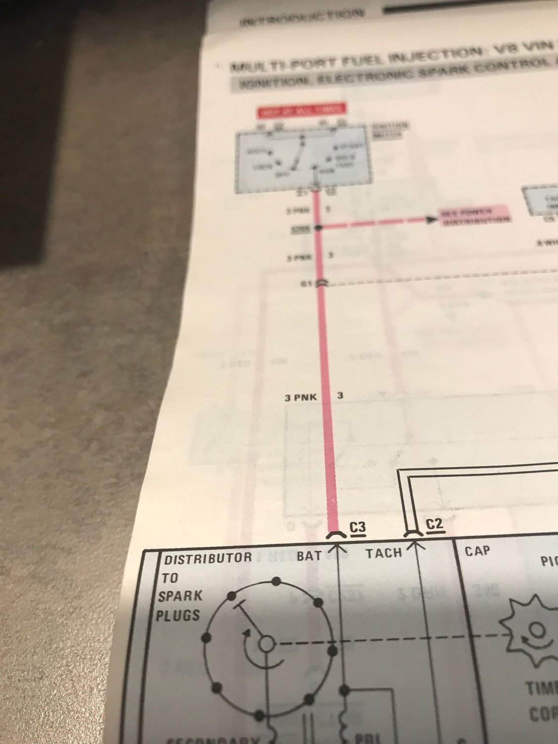

Default I jumpered pink wire
I jumpered the pink wire to battery, then turned the key, started right up, so it was power from ignition switch, not the fuel pump like i thought
