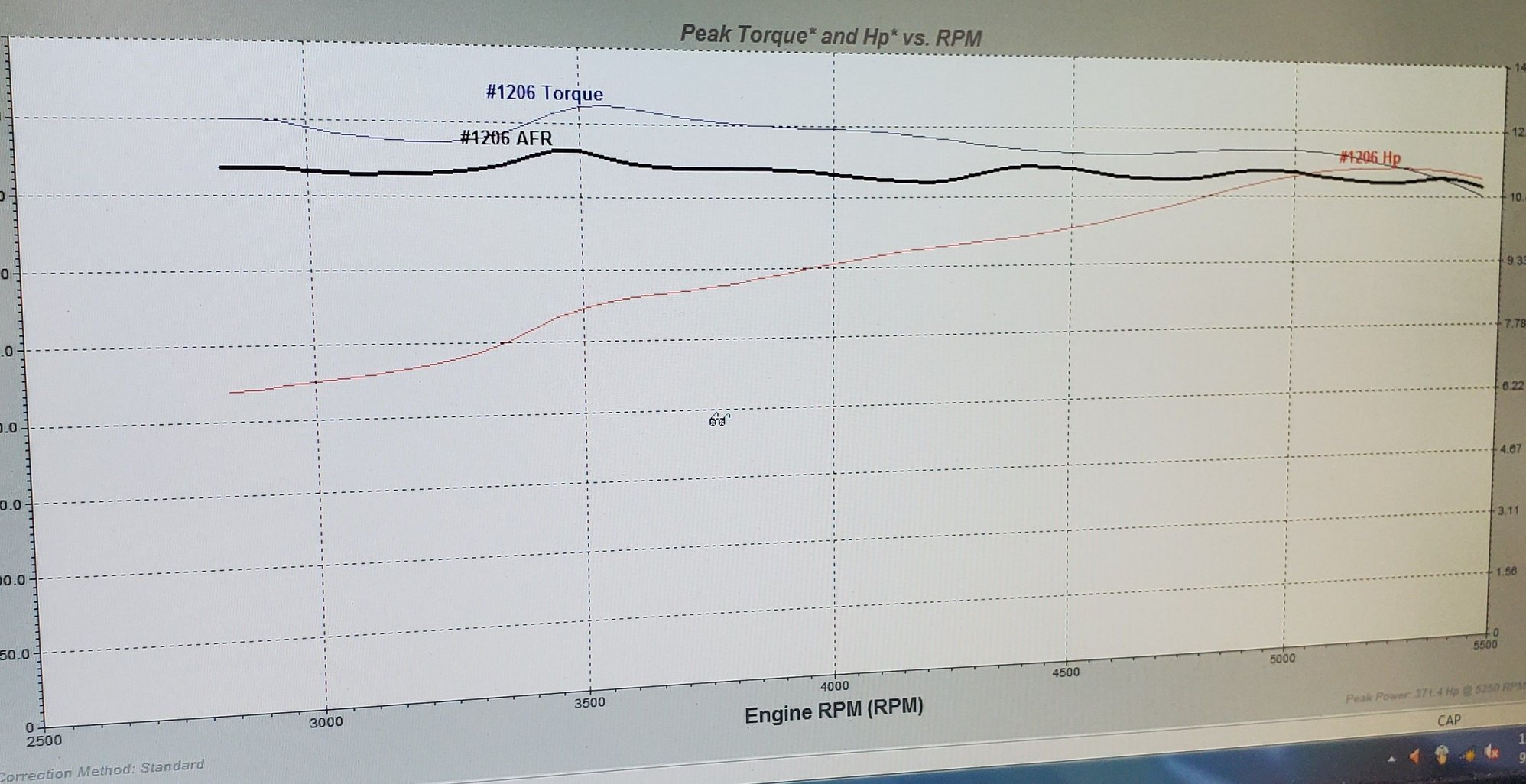

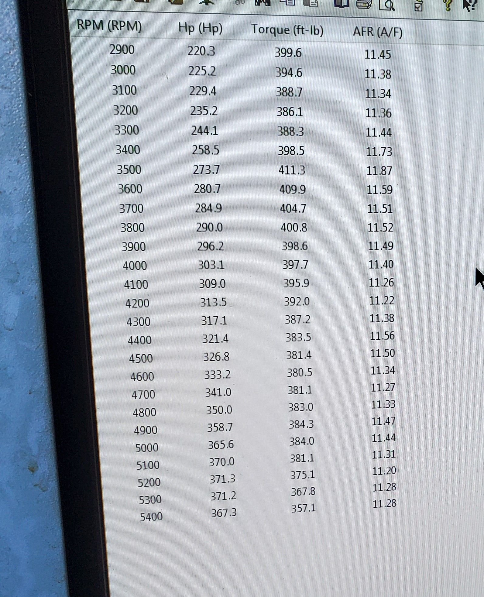

My 85 has ported and siamesed SLP runners and an Edelbrock High Flow base but the horsepower still peaks right at 5,200-5,300 RPM (verified on the dyno) even with my cam. I will be switching to a Miniram this winter off season. (However, I will be selling my intake then.)

I'm running the Comp Cams XFI 08-466-08 which has an operating range of 800-5,800 rpm. With the intake I have it tops out at 5,300 rpm. (Nice flat torque curve though.)
